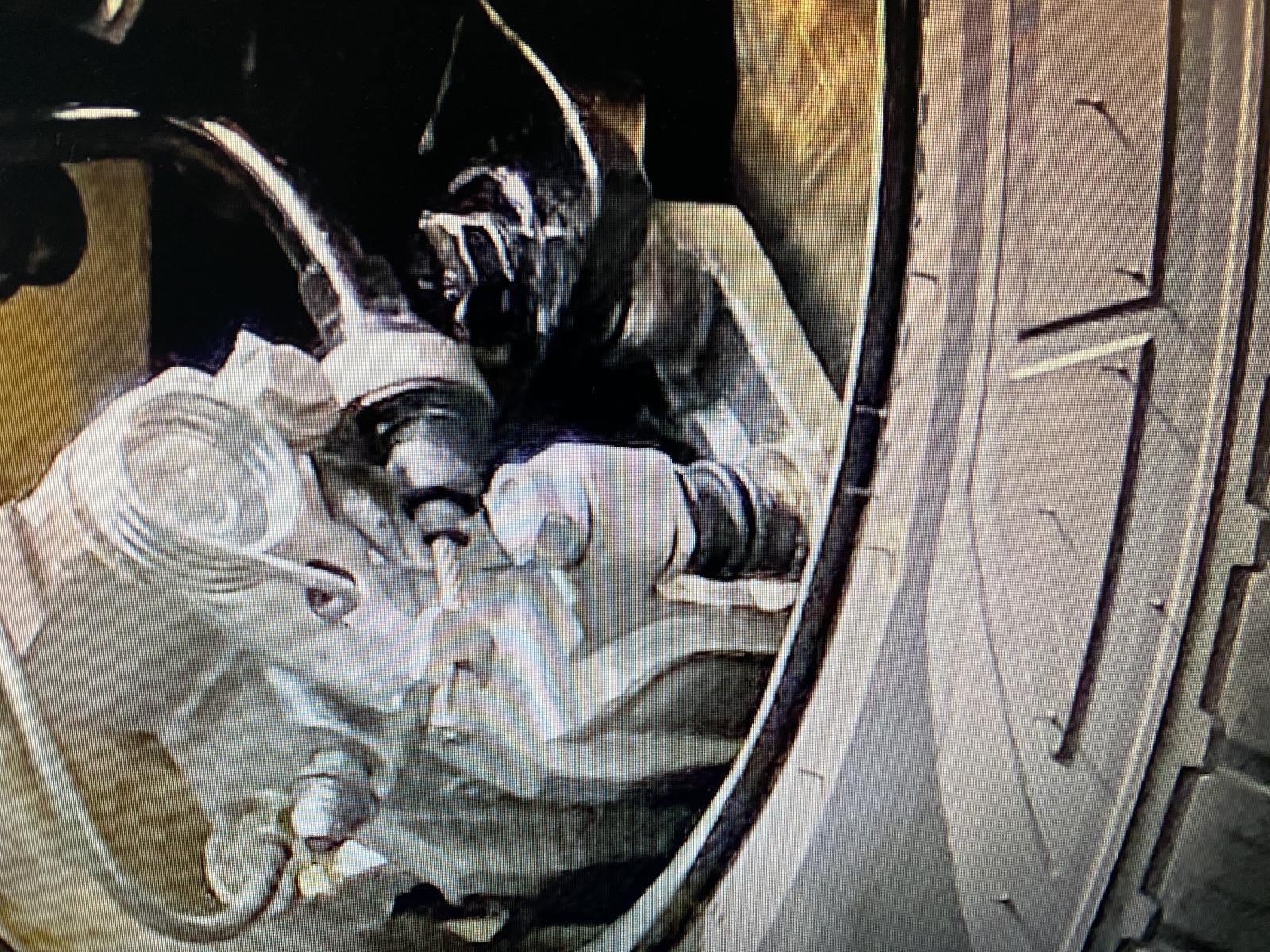

If you look at this picture, the cadmium colored piece is the caliper bracket. It slides over the edge of the rotor disc, and bolts to the black back plate bracket which replaces the stock backing plate. I had to add a washer where the caliper bracket bolts to the black bracket, which spaced the caliper bracket outward.

PostPosted: Thu Jul 28, 2022 10:15 am    Post subject: Re: EMPI VS. CB Disc Brake Conversion Kits Reply with quote
ZEKE65 wrote:
My AC Industries disc brake kits worked well, except for the fact that I had to install a washer between the rear caliper brackets, and the mounting brackets which replace the drum backing plates. Otherwise the caliper bracket would lightly rub the outside of the rotor. I used a 10.9 alloy washer.
Do you have a pic of this?
