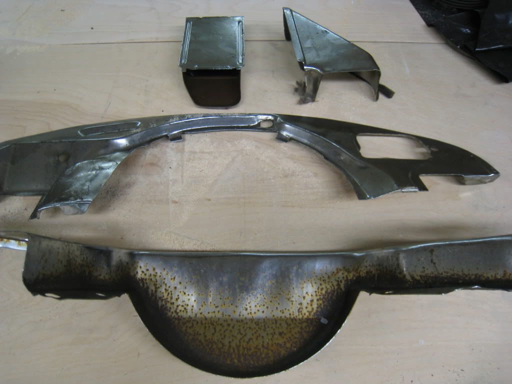

Has anybody used square tubing and sheet metal fabricating in the place of old heater channels and floor pan?
I need some inspiration.

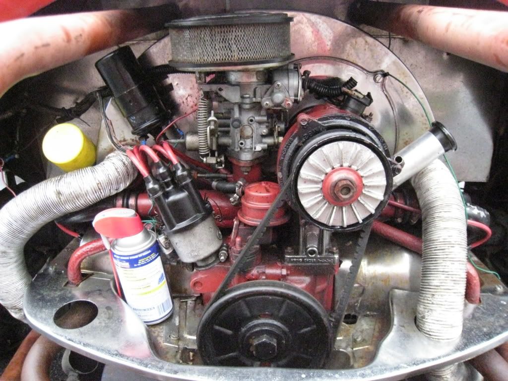

PostPosted: Sat Aug 29, 2009 8:19 am    Post subject: Reply with quote
thanx for this resource (pic34). it shows a whole tune up procedure nicely.
QUESTION: its a simple 1. what do i do with 2 vacuum lines from the neck of the intake. i did link the large one to the fitting on the oil filler neck, and cap off the small one?
what do i do with a 2 vacuum lines on the carburetor. i did i cap them off?
is this a correct procedure?

Best 34 pict 3 guide I have found: http://www.vw-resource.com/34pict3.html.
Nice start to a Baja you have there. The engine work looks great, wish I could get mine that clean. Laughing

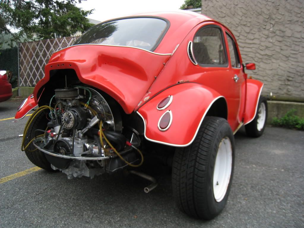

Hugging Corners
Joined: June 17, 2009
Posts: 140
Hugging Corners is offline
PostPosted: Sat Aug 08, 2009 7:50 pm    Post subject: Reply with quote

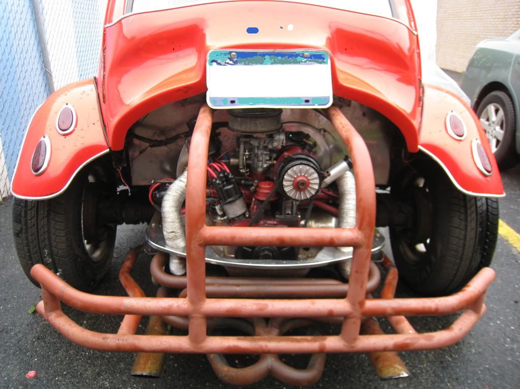

Final prep before first start up

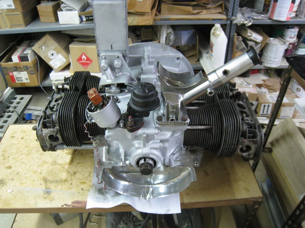

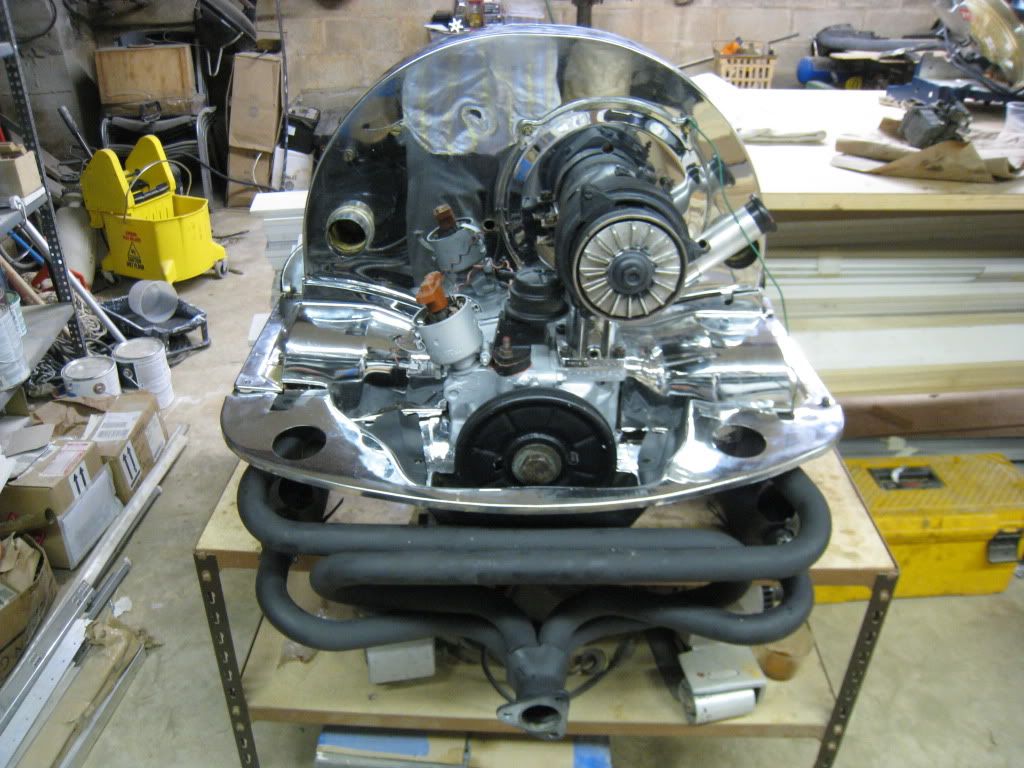

PostPosted: Tue Aug 04, 2009 6:41 am    Post subject: Reply with quote

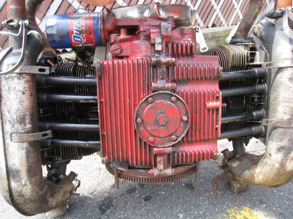

The motor is put together, ready for the implant. I hope everything went smooth- we will see soon the final result. Since i have had an test assembly before, I hope first cranking will be a first time turner.
I do have a couple of minor missing links. When i was taking alternator out, positive from alternator touched the ground and sparked, creating electrical shortcut. Also after that I have lost red control light on the dashboard, and ignition key died. Could you guys help me to locate a relay that the shortcut might burn?
Ant the "blink blink" motor.

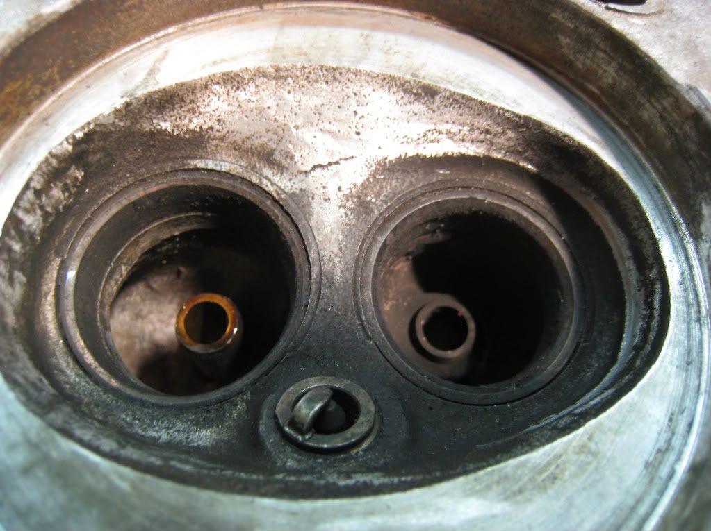

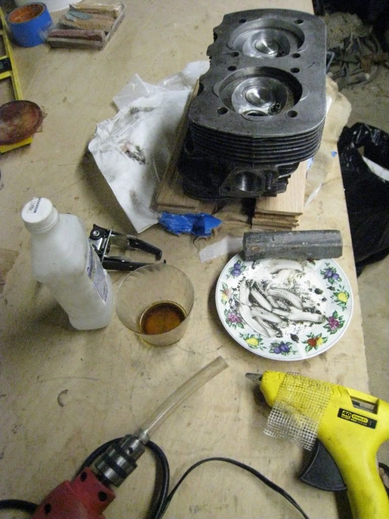

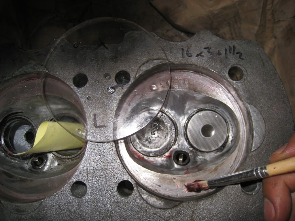

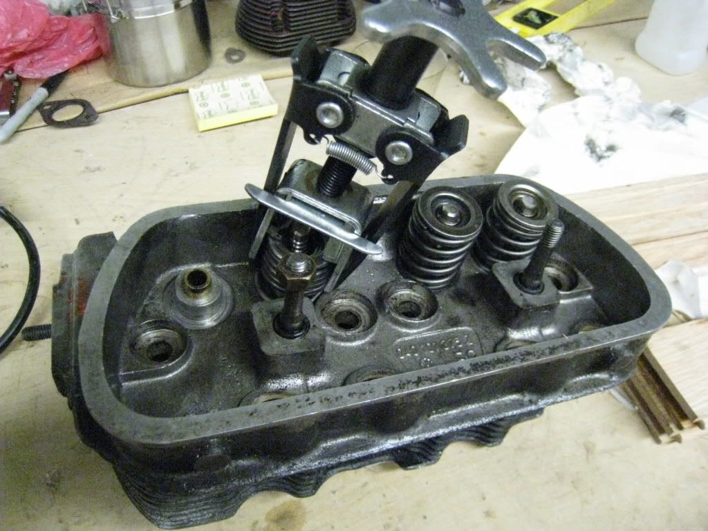

PostPosted: Fri Jul 31, 2009 8:31 am    Post subject: Reply with quote

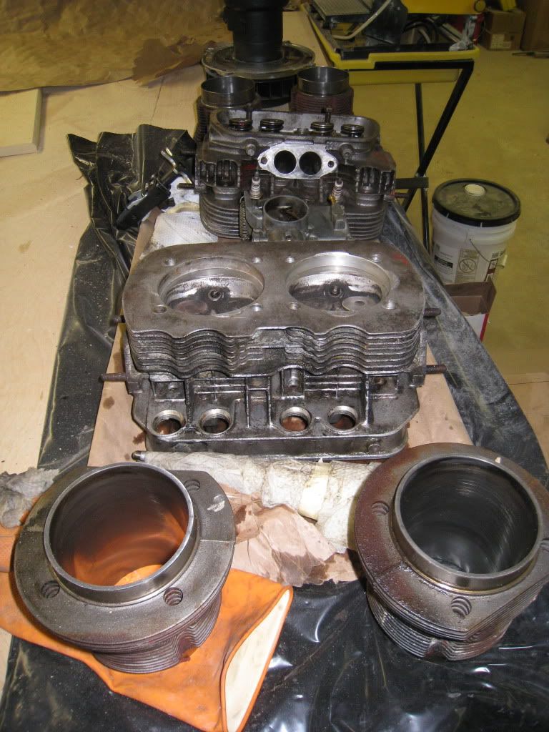

Unfortunately my grinding job was not dressed. It took some time to lap the valves to smooth surface, and it resulted in wave/step on the valve (No pressure points)
Those are the little things that sometimes it is easy to overlook, but which can make a difference.
