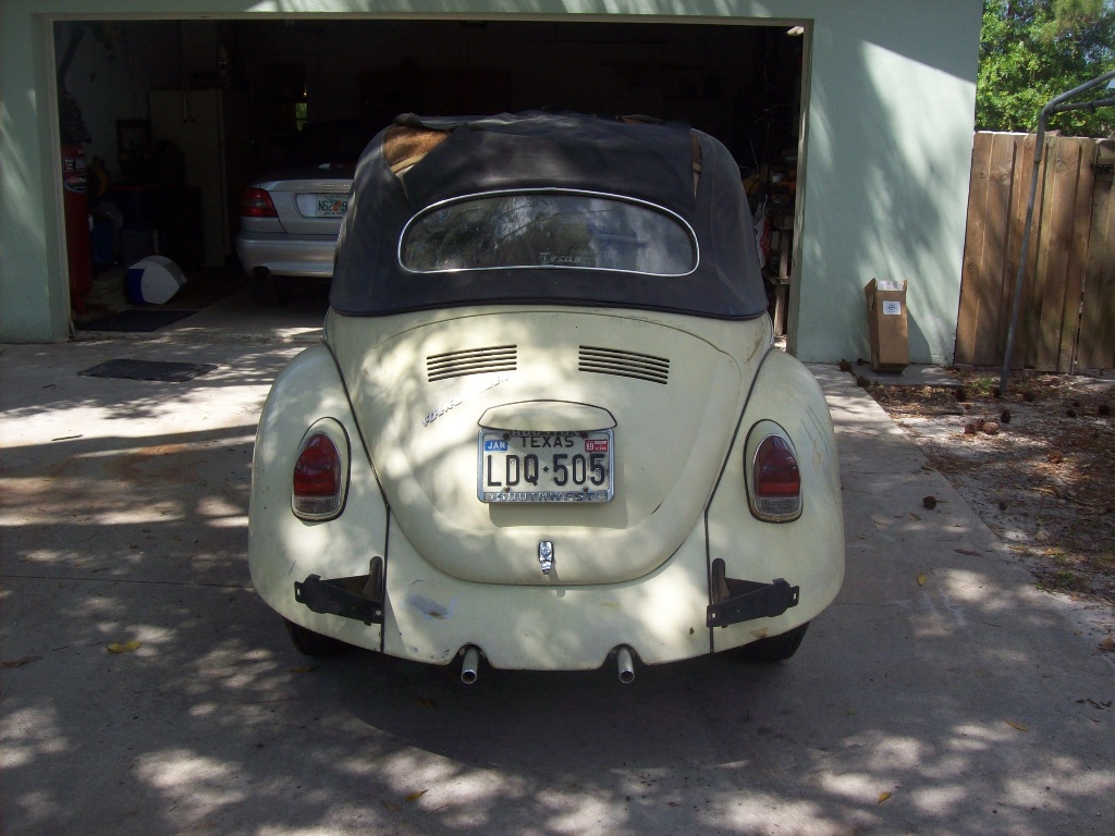

Stripped, painted and mounted the '62-'67 style tail lights. Much better look than the late tombstone lights and guardrail bumper in my opinion.
Next on the agenda is to remove, clean and lube all four window regulators, install the new window scrapers and all weatherstripping.

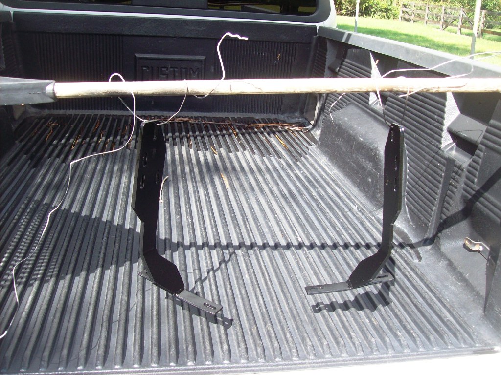

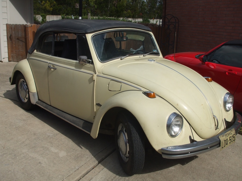

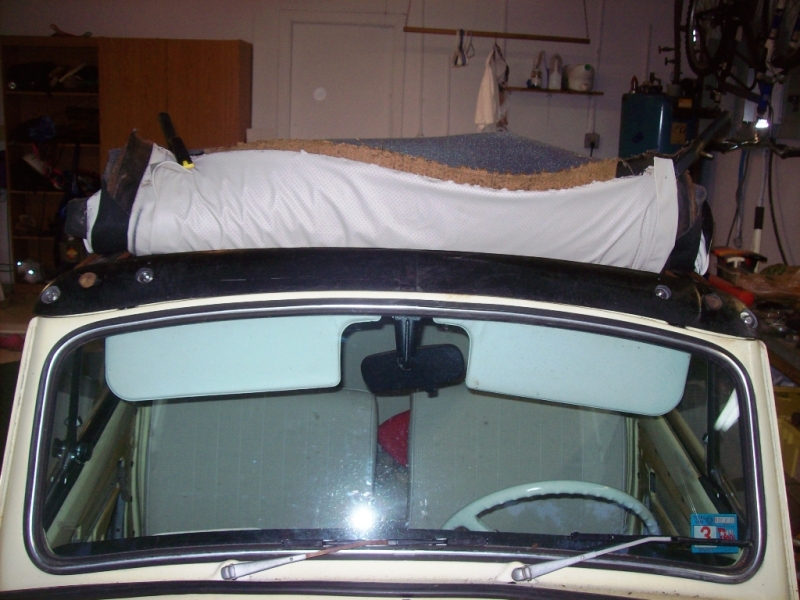

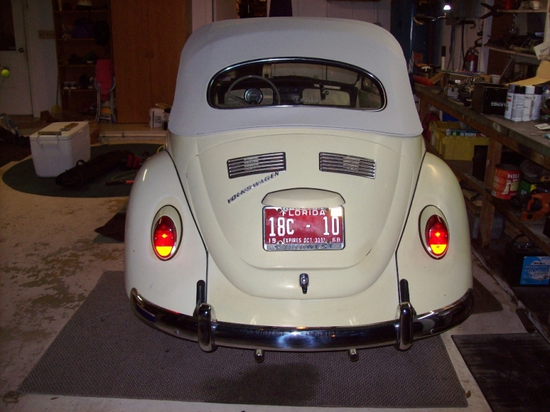

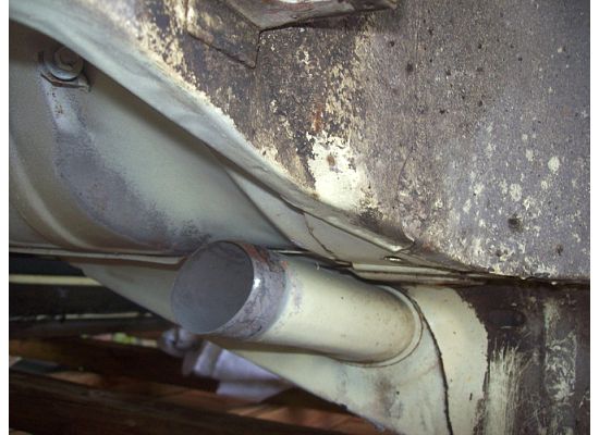

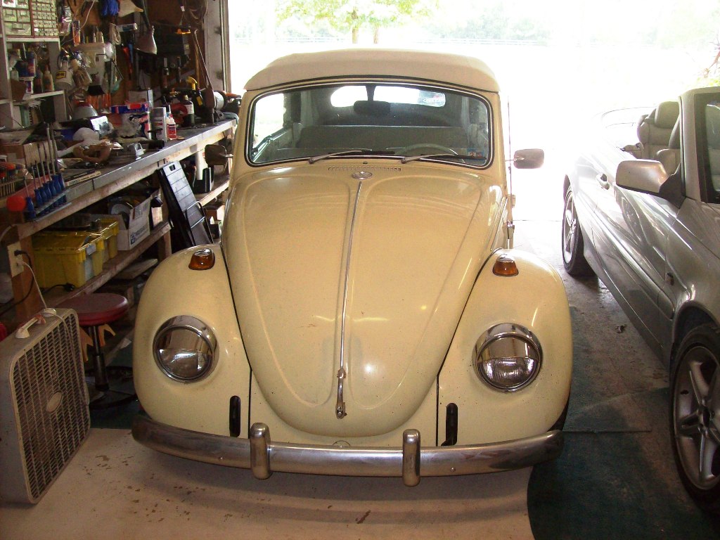

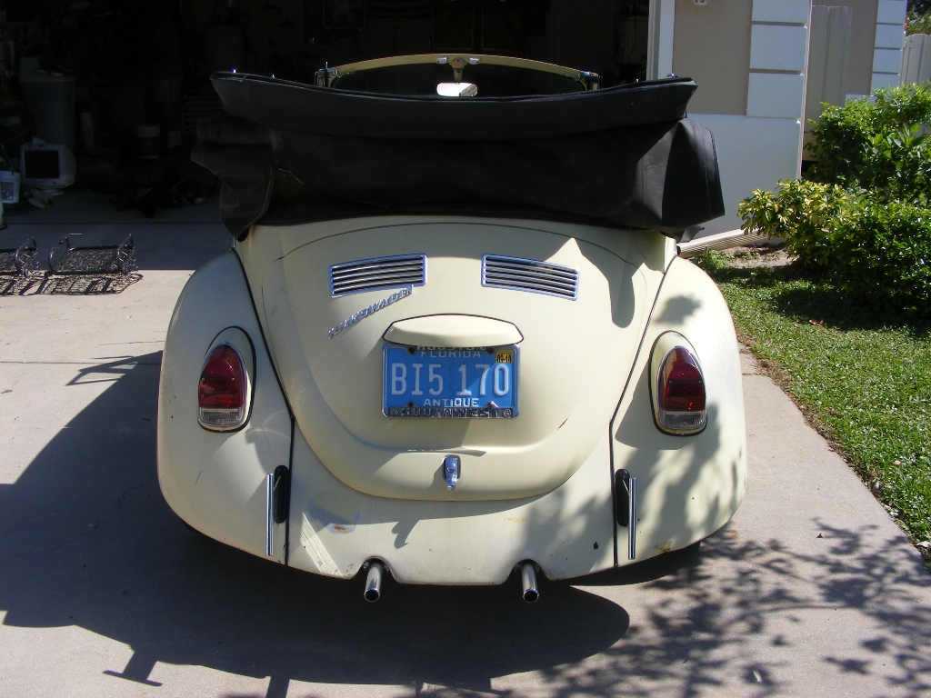

Finally got the vert back from the upholstery shop and it was worth the wait. I'm very pleased with the job. He did the top, headliner, seats and carpet and I'll do the weatherstripping and door panels. I want to pull all the window regulators and clean and lube the mechanisms before the vapor shileds and panels go in.

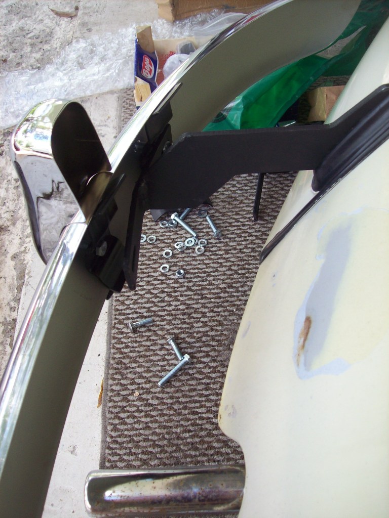

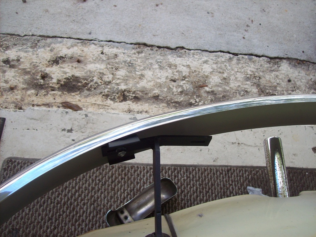

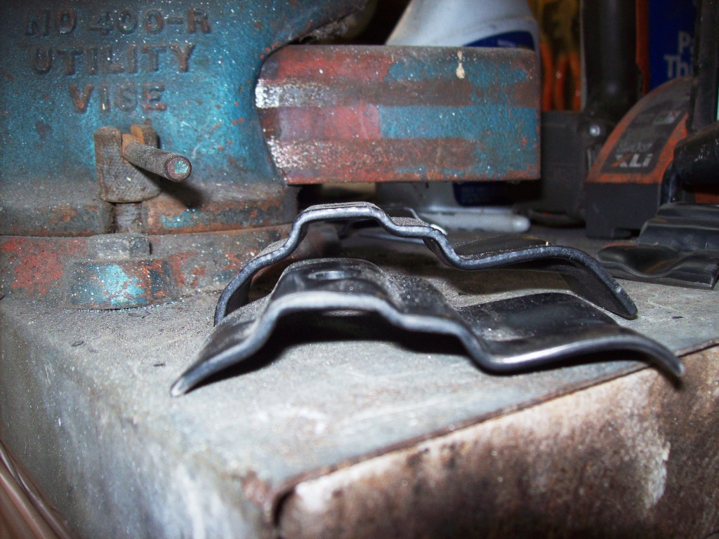

This weeknd I installed my new euro blade bumpers. What a pain in the ass as none of the four conversion brackets matched the curve of the bumpers or the mounting holes. In fact, they were not even close. I had to heat and reshape all of the brackets, then repaint them. I also had to cut down the eight little little reinforcement brackets because they stuck our past the edges of the bumpers, but the end result looks great. Much better than the bulky '68 bumpers.
I picked up a pair of '62-'67 tail lights that I'm going to replace the '68 units with. Just have to strip and paint them.
This shows how far off the brackets were. I got them "adjusted", just took a while and several mock-ups.
I had to take quite a bit off the reinforcement brackets to get them to tuck out of sight on the inside of the bumpers.

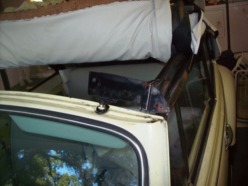

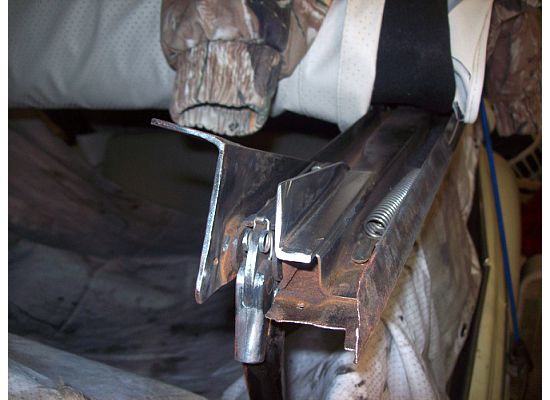

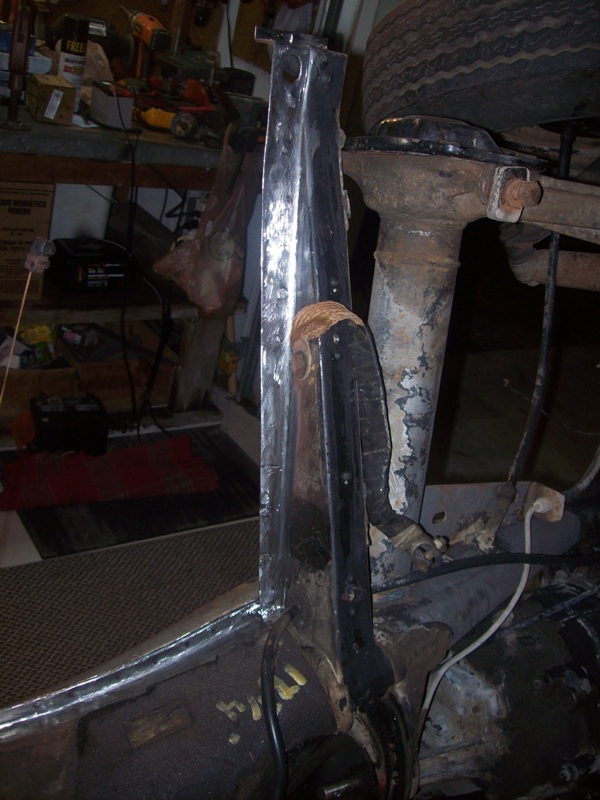

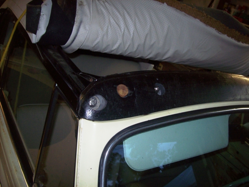

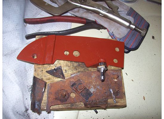

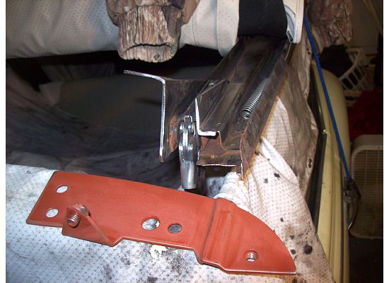

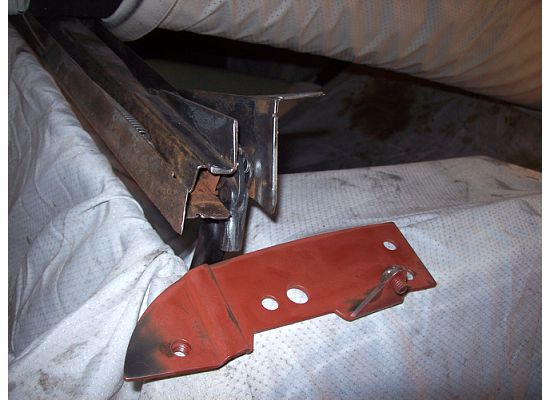

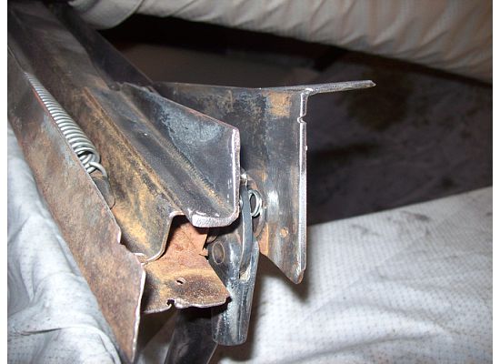

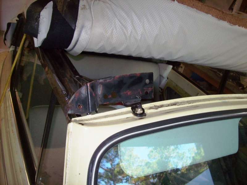

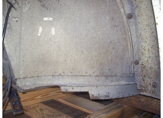

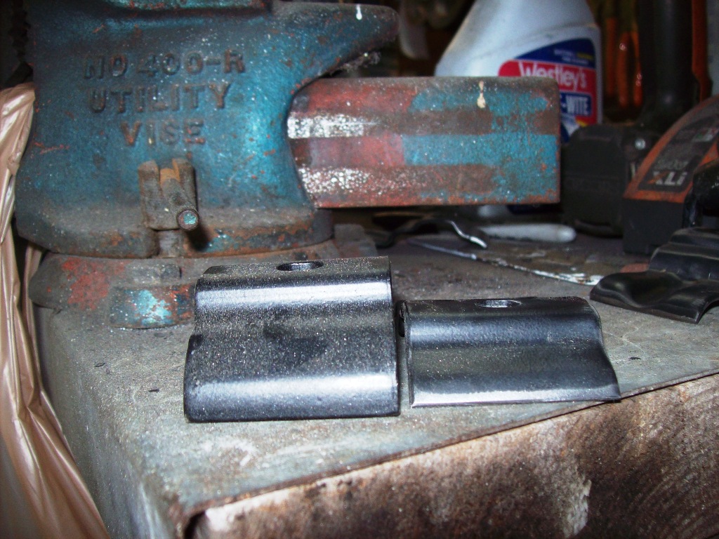

Got the new plates welded in, cleaned up and painted. During mock up, I realized that I had to reshape the header bow even more to get it to match the radius of the windshield frame and for everything to line up satisfactorily. Also, none of the existing mounting holes matched the top frame, so I had to fill them in and drill and countersink new ones. Once I was happy with the way everything sat, there was still a pretty sizeable gap between the bow and the windshield frame, even with the J-hooks tightened all the way into the latches. I thought this might have been because there was no header seal in place so I test fitted the header bow with the seal sandwiched in and I still wasn't confident that it would be tight enough to keep the rain out at highway speed. To solve this, I shortened the threaded shanks on the J hooks by about 1/8" and milled the jam nuts to about half their original thickness. Now there's enough adjustment to pull the bow flush against windshield frame even without the seal in place.
So, the new plates are done, the bow is bolted in and everything fits nicely. This job turned out to be a bit more involved than I had anticipated, but I'm happy with the results. Tomorrow I'll trailer the car back to my upholstery guy so he can finish installing the new top.

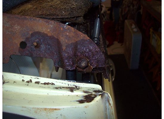

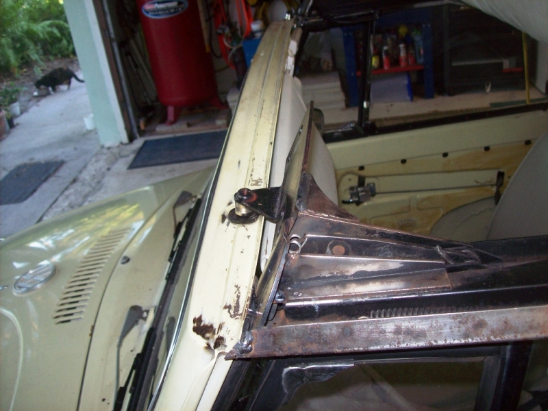

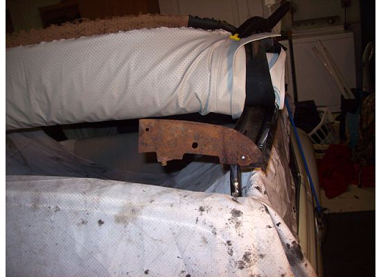

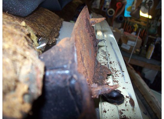

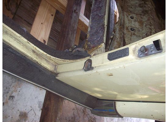

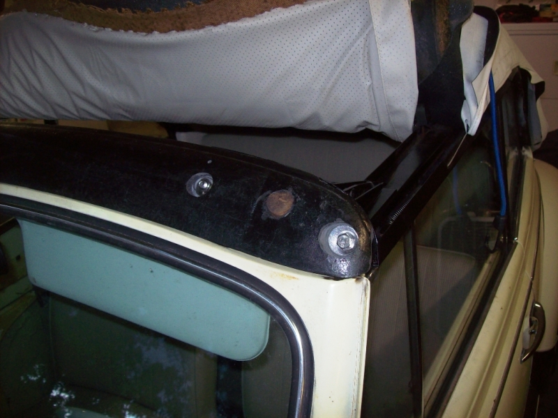

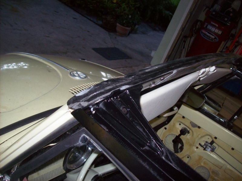

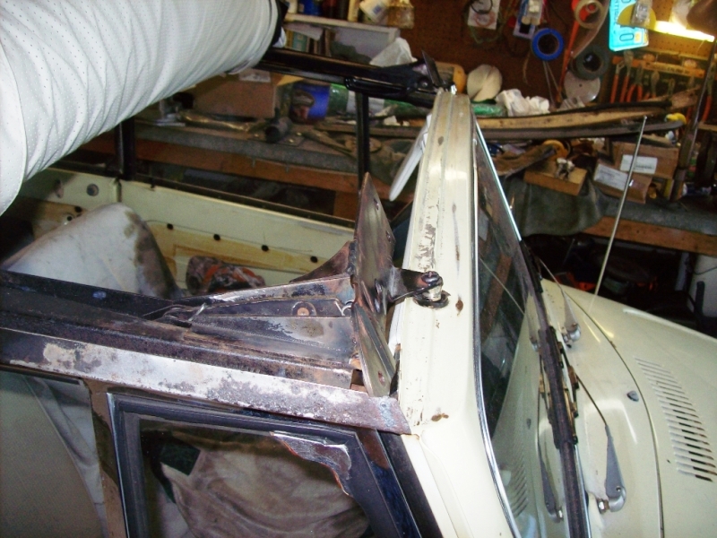

My upholstery guy called to tell me that one of my header bow mounting plates was in questionable shape and my header bow was a little soft. This is AFTER he had the top about 90% done. I told him to stop the work and that I'd come get the car and replace whatever needed replacing. So, I went and trailered the car home and had to peel the new top, headliner and padding back from the header bow to inspect things. The bow was junk and the alignment pin mounting tab had rusted off of the passenger side mounting plate. The driver side was serviceable, but I decided to cut off both plates and weld on new ones. I went with a synthetic header bow instead of wood for obvious reasons. The quality of the bow is somewhat lacking, and I've had to do some major modification to it to get things lined up. Tonight I'll finish mock-up then tomorrow I'll weld the plates on, repaint the forward part of the top frame and bolt the bow in. I hope to have it back at the upholstery shop Friday to have the top finished.
On a positive note, the interior guy did a bang up job on my seats and carpet. I swapped out the black high back buckets for a pair of low backs and went with white for the seats, door panels, visors, headliner and top. Getting close to the finish line.

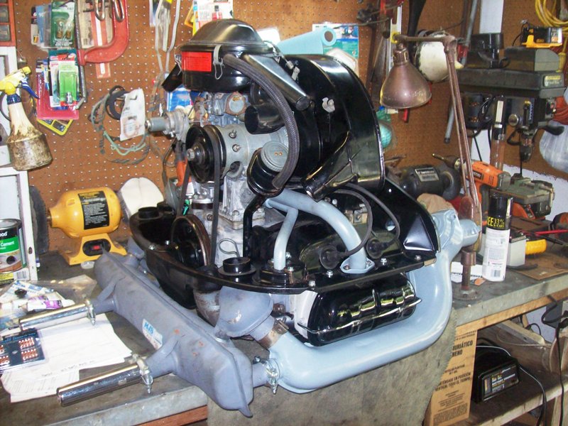

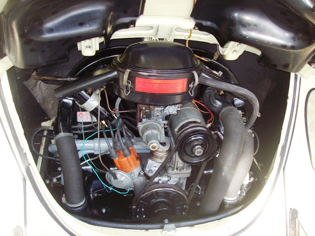

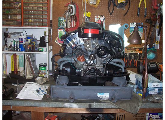

Well, it's alive! Fired up the fresh motor last night. I pulled the rocker shafts, push rods and plugs and cranked it over until it built about 30 psi of oil pressure. Reinstalled the parts, hit the key and it fired instantly. I ran it for five minutes at 2000-2500 rpm and it sounded awsome. The straight cut timing gears sound pretty cool. Oil pressure remained around 45 psi. I checked for oil leaks this morning and was happy to find none.
Tonight I'll adjust the valves and run it at 2000 rpm for another 15 minutes to finish the cam break in, change the oil, adjust the timing and carb and call it a wrap.

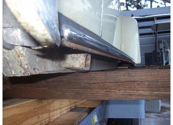

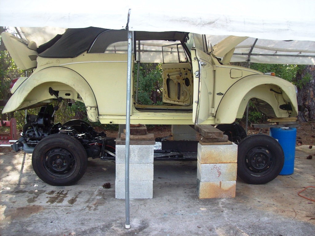

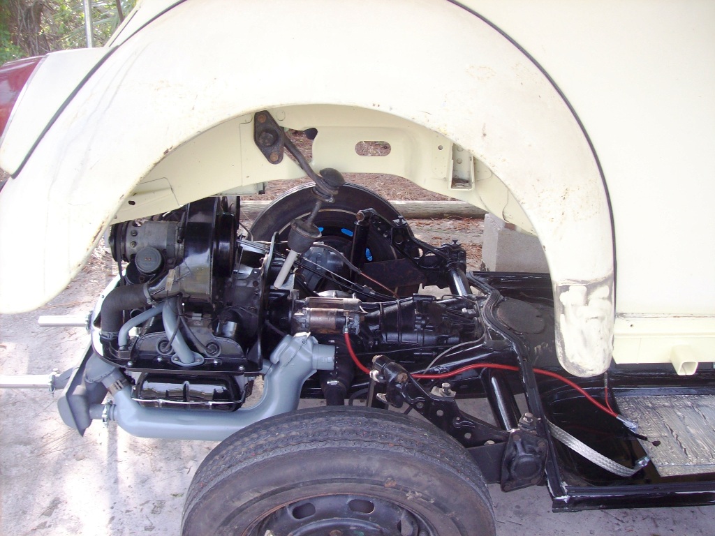

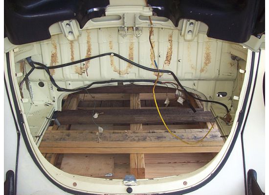

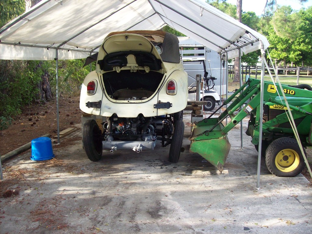

I put the body back on yesterday morning. My helpers couldn't make it until today and I was too impatient to wait so I wound up doing the job myself. It took about an hour and a half start to finish and went smoothly. Looking inside and under the car and seeing fresh pans is awsome. I'm really anxious to start the motor, but I don't want to risk damaging the fresh engine so I'll move slowly. Based on the recommendation of a VW expert, I'm going to hook up an oil pressure gauge, pull the rocker shafts, push rods and spark plugs and crank til I get pressure, reinstall the parts and start it up and run through the break-in process. I can see the light at the end of the tunnel. Just hope it not an oncoming train.

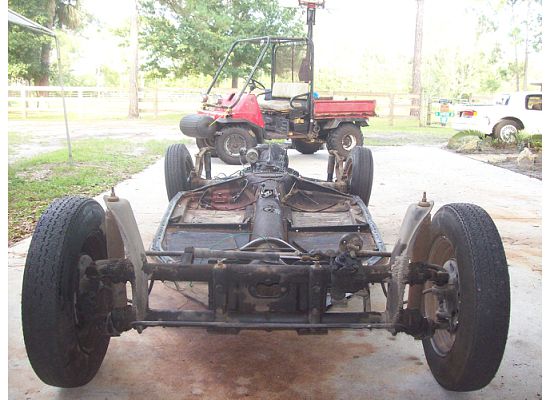

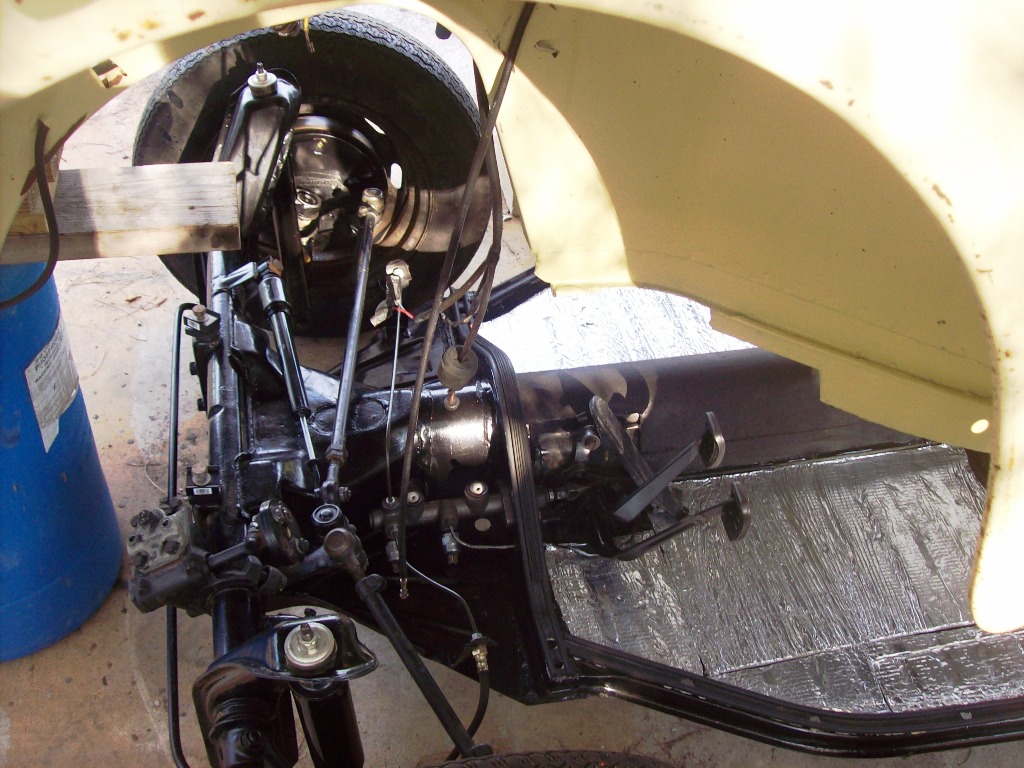

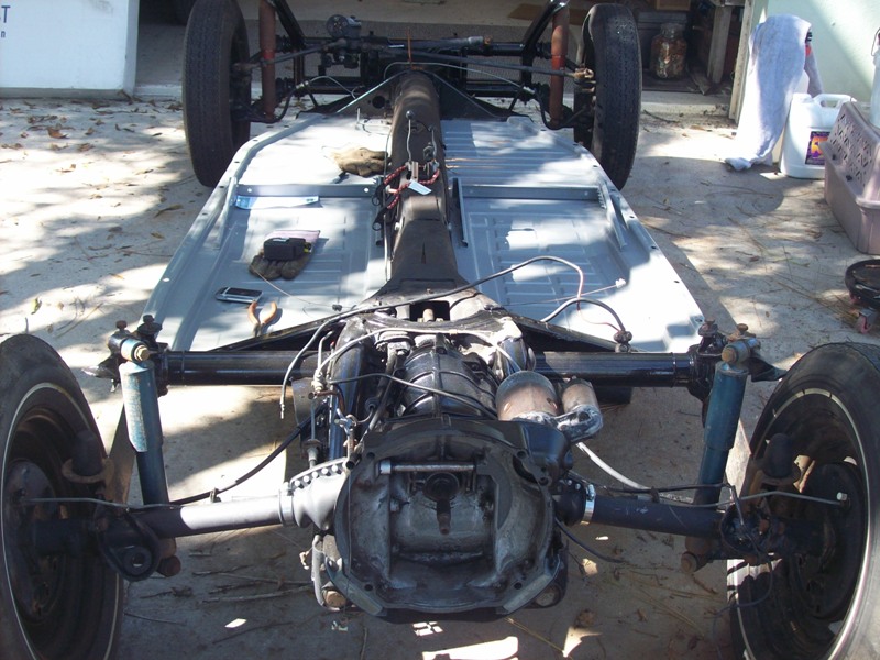

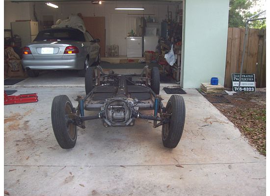

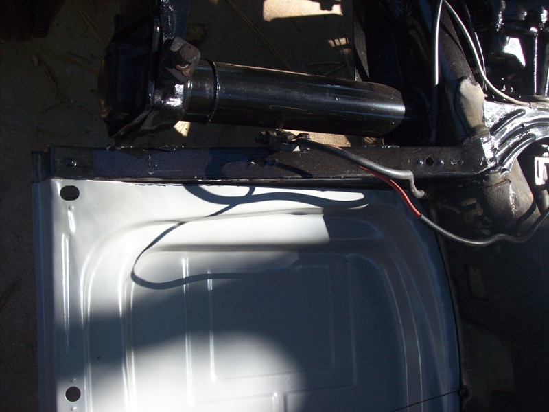

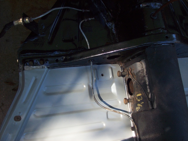

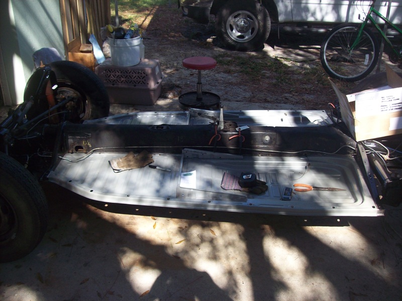

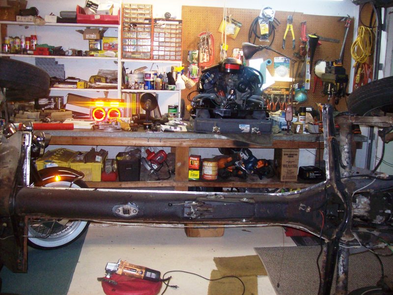

Rolled the chassis under the body today. All ready for the reunion Saturday morning. I finished the rebuild of the engine about six months ago and I hope to finally be able to do the initial start up and run-in this weekend. The body has been residing on the other side of my property for the last few months and the chassis has been in the garage. Once the body is back on I'll roll the car into the garage for final assembly.

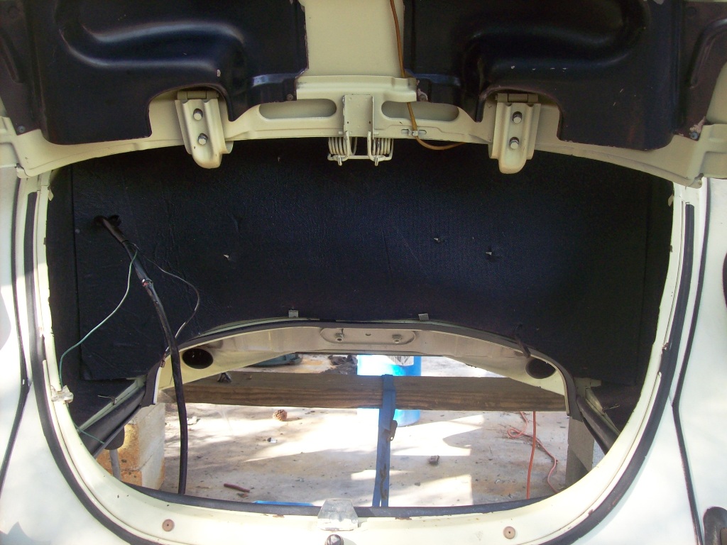

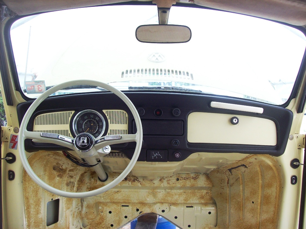

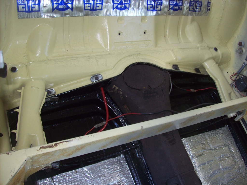

Everything that I wanted to get done on the body and chassis is finally done and I'm ready to drop the body back in place. It took longer that expected and I had a few setbacks. I wasn't happy with the first firewall tarboard set I installed. It was made of a thin material with the consistency of a rubber floor mat. It was easy to work with, but it just didn't look close enough to the original. Paul at JB Bugs got me another set that's real close to the original. It's thicker and less flexible so it was harder to work with. There are no repro sets specifically for convertibles, and it had to be modified quite a bit, but the end result justifies the effort.
I found a small crack in the "perfect" OG dash pad I bought but I was able to repair it and refinish the pad so that it's not noticable. I wound up having to take the pad out three times because I didn't put things back in the proper sequence. The new pad didn't have a hole for a lighter, so I took mine out. I also cobbled together a radio block off plate. I think the cleaner look is better. I decided to change the color of the grab handle to match the recolored column, wheel, e-brake lever and shifter. There were some damaged wires on both sides so I repaired them using original style connectors.
My goal is to have the body back in place by next weekend. The only hurdle will be trying to round up three or four of my buddies on a week night. Worst case will be that I have to wait until Saturday morning. Since I removed the body by myself, I considered trying to replace it myself but decided against it.
