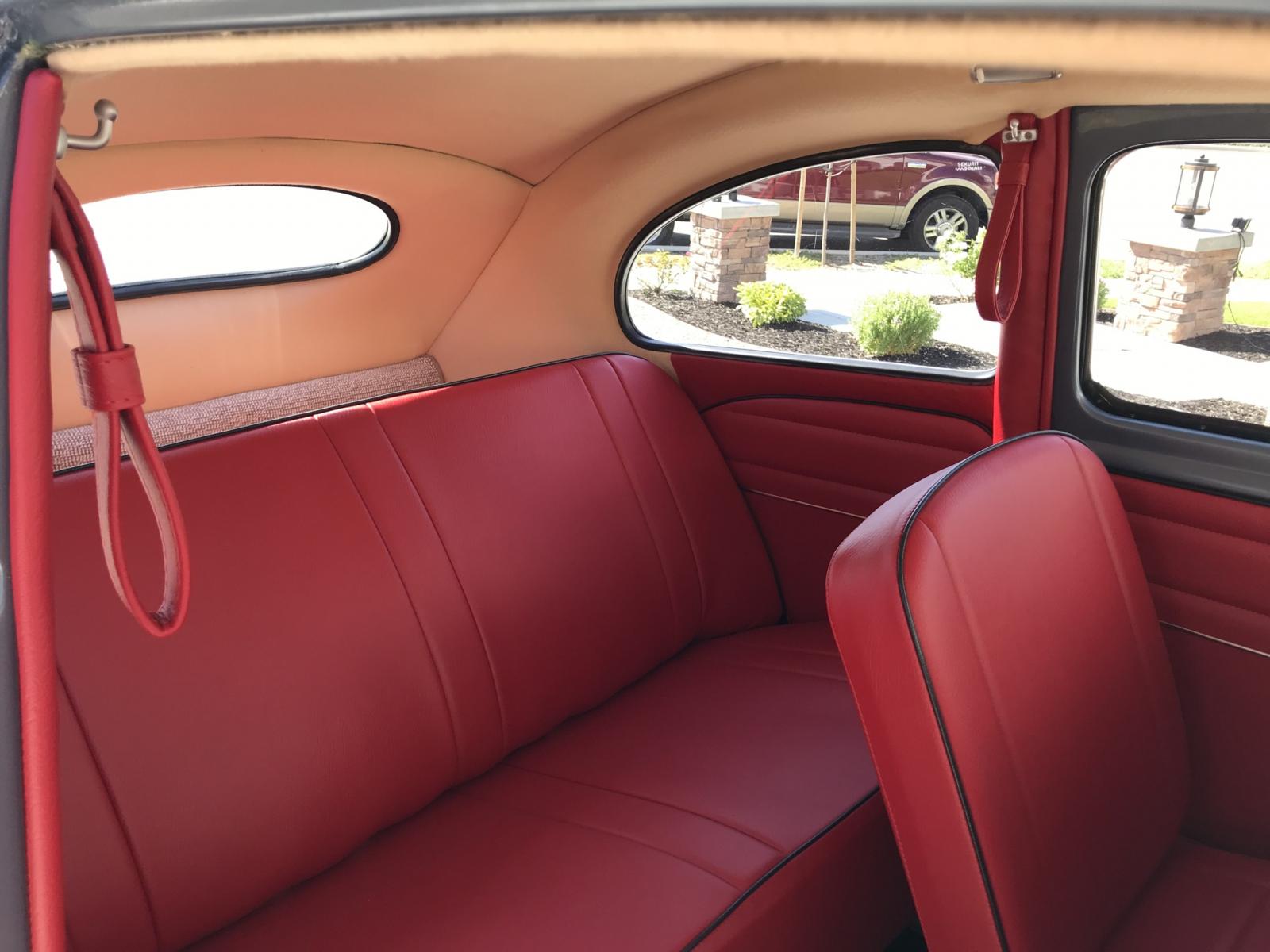

sb001 wrote:
Can someone please explain IN DETAIL the difference between the original (multi-piece) style headliner vs the easy install (one-piece) headliner? In particular, which sections are extra pieces in the original style vs sewn in to the one-piece?
I cannot find ANY good illustrations showing the differences, and when I look them up on Sewfine's catalog they show the EXACT same illustration for both, then it says the one-piece still comes with 5 additional "trim" pieces which to me would be indicative of a multi-piece.
I am looking for a new headliner for my 69, I realize this is the wrong forum but since the subject was brought up here I thought I would ask.
Thanks in advance
In essence, both styles of headliners you ask about are in fact "multi piece" headliners. The BIG difference between the 2 types is the area around the rear window. On the "original" style, there is a separate (and somewhat painstaking) section which needs to be installed apart from the main section, around the rear window. The "easy install" style eliminates the separate rear window section altogether, which indeed makes installation easier but at the expense of looking "not quite right" IMHO. But, then again - I'm a "gotta be original" fanatic! You may think otherwise...
BOTH types of headliners get additional strips of material included for the 2 "B" pillars, plus under each quarter side window, and upper firewall area (under rear window). There is no such thing as a literal "one piece" headliner kit, although some vendors refer to the "easy install" as a one piece due to the absence of the rear window section.
Below are two photos showing a view of each type. First one is the "easy install" variety. Consider the rear window...
The next picture is of a '68 headliner with the original style window version. Your '69 should be the same, however there might be a slight detail difference for the rear window defogger with the '69 - up.
Hope this might help..

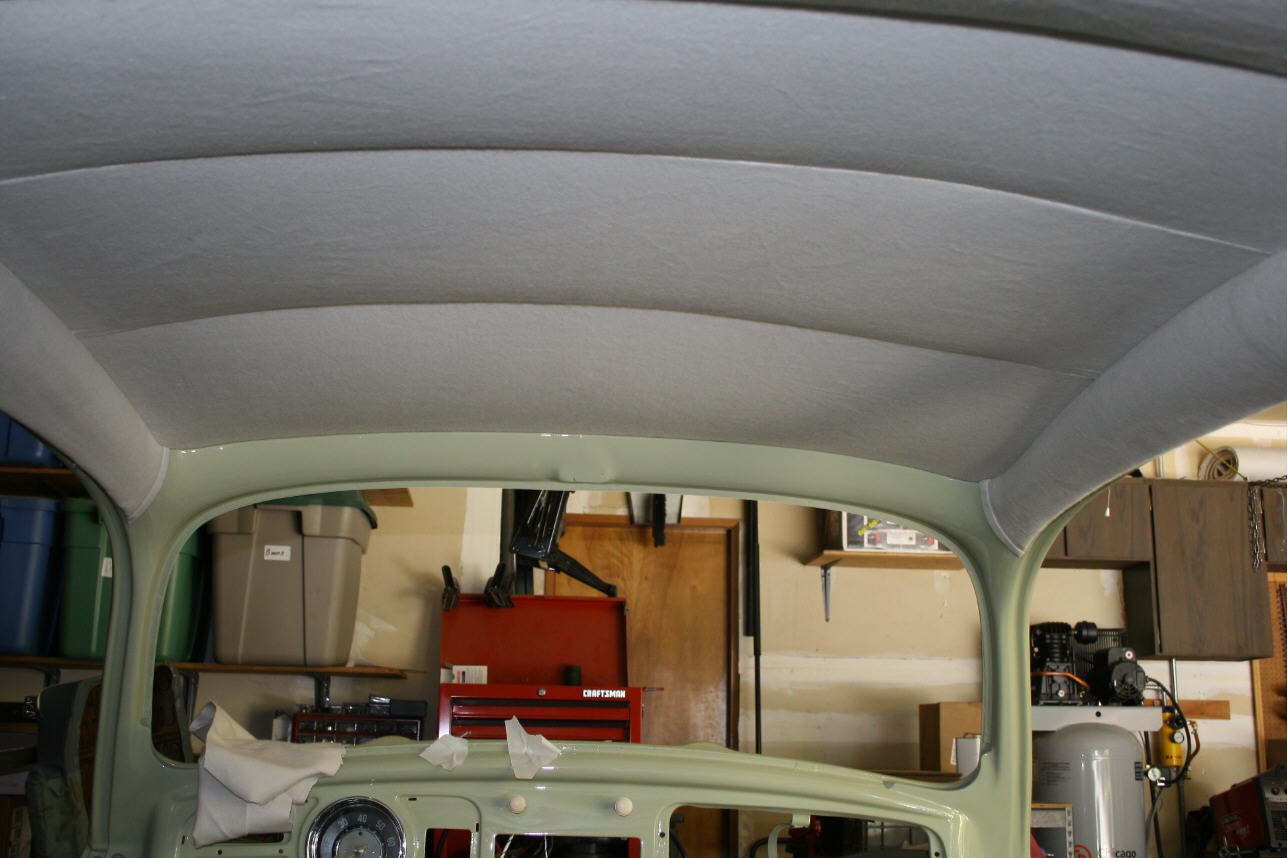

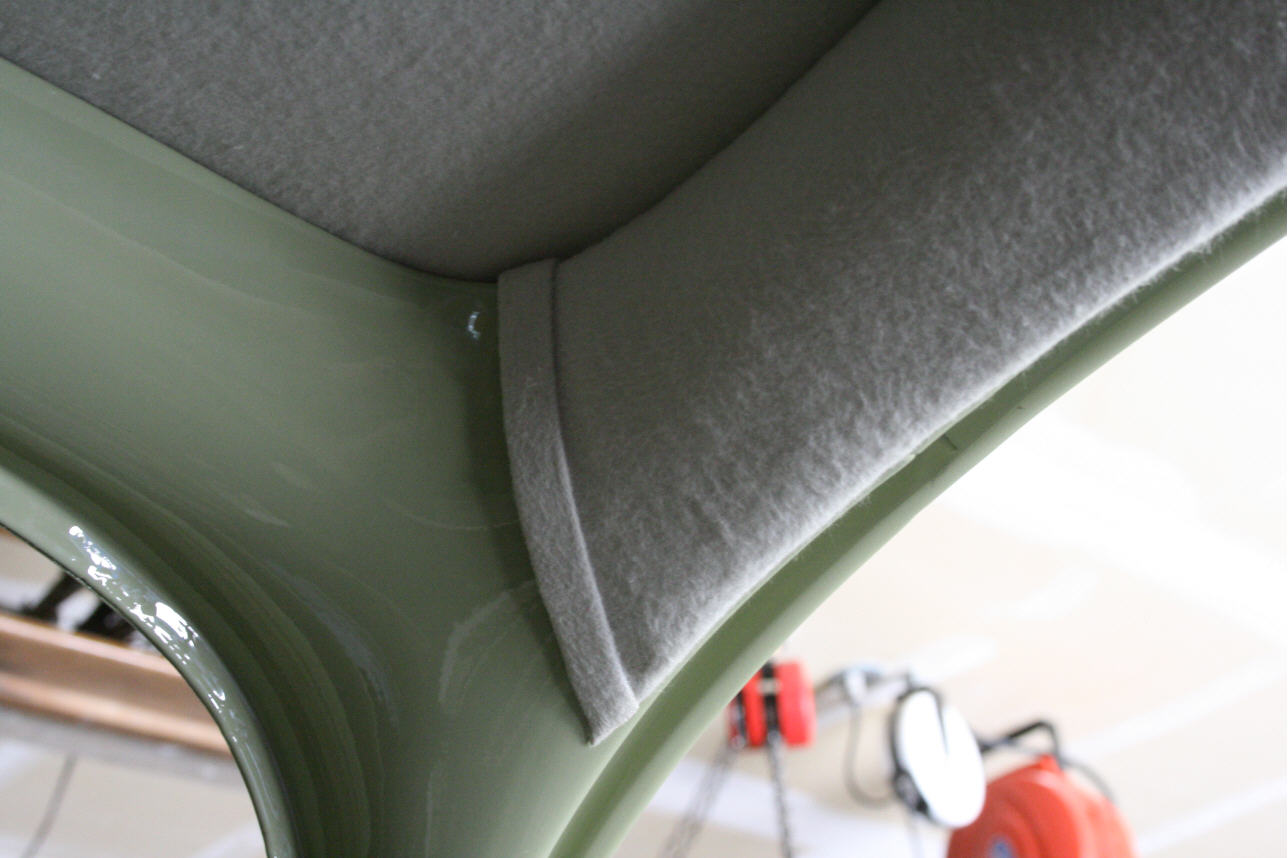

Headliners are a pain and a little daunting, but you can do it yourself.
The EZ-Style has a few drawbacks. The look of the thing behind the quarter window to where it meets the rear window is a little funky...not too bad, but certainly not like the original.
There are some tricks, but mostly it is patience. I did my beetle in about 6 hours and it turned out great.
be careful when you pit your windows back in that you don't pull out the headliner where it attaches at the sills.

I installed my multi piece headliner myself. After reading all the warnings here about how hard of a job it is, I prepared myself for a nightmare, but to my surprise, it was much easier than I expected.
It IS a time consuming process, but by no means is it hard.
I realize this isn't "stock", but I just didn't like the plain looking folded end. Thought this add a nice touch.
