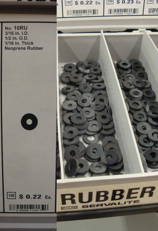

PostPosted: Mon Nov 02, 2009 10:16 pm    Post subject: Reply with quote
scvw wrote:
Thanks for the pics Everett. I got the seals from Lowes tonight and they worked great, 3/16"ID x 1/2"OD x 1/16" thick. Can't beat OG paint!
Example from my local Ace hardware (same size):
http://www.thesamba.com/vw/forum/album_page.php?pic_id=615170
Posts: 71484
PostPosted: Sun Nov 01, 2009 7:57 pm    Post subject: Reply with quote

scvw
Joined: September 02, 2006
Posts: 3552
Location: South Carolina
scvw is offline
PostPosted: Sun Nov 01, 2009 7:50 pm    Post subject: Reply with quote

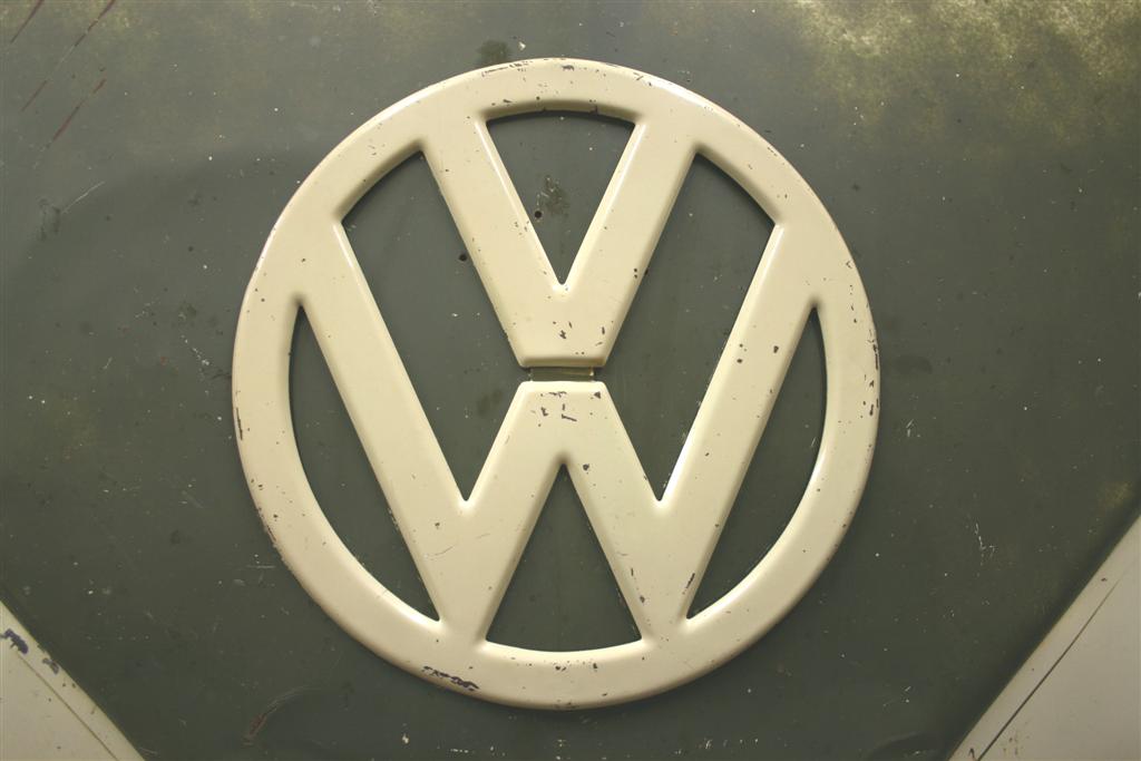

Posts: 71484
PostPosted: Sun Nov 01, 2009 6:16 pm    Post subject: Reply with quote
scvw wrote:
Could somebody post up a pic or two of what the original seals looked like. I need to put the OG paint one that I just got on my bus and I wanted to get it right the first time before I put those impossibe to remove clips on.
12 mm diameter
2 mm thick
