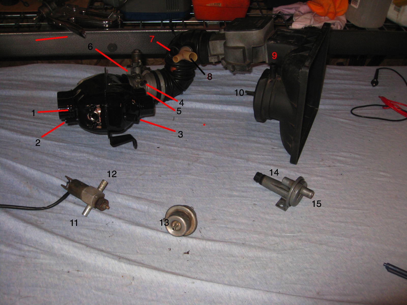

Number 4 and 5 are teed to the vacuum line going to the transmission modulator. Number 5 should have a restriction orifice inside.

im curious to know why vw engineiers put a 3rd nipple on the throttle body (number 5 in pic from davis911s )
it was also capped off on mine when i got it

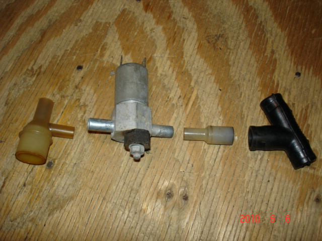

#7 and #8 is the wrong plastic connector for the 75FI auto.
and also there is another rare odd ball piece in the rubber tee coming out of the plenum that I have just found.

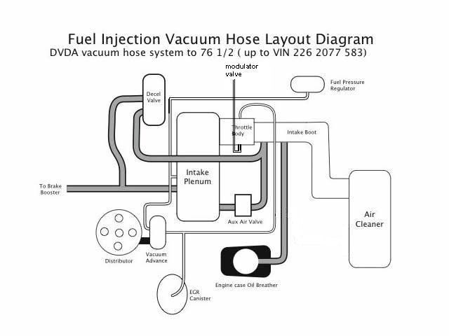

here is a diagram from the mentioned thread
& a qoute from davis911s
[img]
[/img]
Posted: Thu Jun 18, 2009 10:06 am Post subject:
1- 13
2- brake booster with t to #11 on decel valve
3- 14
4- modulator valve on trans
5-capped off
6- vacuum advance on distributor with t to 10
7- breather on engine case
8- 12
9- emmisions canister
10- 6
11- 2 with t to brake booster
12- 8
13- 1
14-3
15- 8
Am I way off? Here is the vacuum line kit I got from German Supply. I know I still need a few bits and pieces to finish it
Shawn
this picture does not have the
egr,temp valve or automatic idle valve (i think that is what is called)
also missing is the charcoal canister
the air cleaner on mine does not have the 1/8th inch vacuum outlet
the one in pic appears to be from a 77-79-can someone confirm??
4. does go to the trans but it has a T in it & also connects to plenum
(my plenum has another outlet between the intakes to connrct to the T)
this was reconnected before theft so i will confirm as correct
5. was also capped off on mine, why???
6- vacuum advance on distributor with T to 10,
i have no #10 & i had no T for this area so im pretty sure that 6 to 10 is direct with no T's, but will not confirm yet
more info or pics will help thanks

does anybody have the original 75 fi on their automatic ???
this drwing conradicts what is on the fi manual on the other thread
order your BAY WINDOW T-SHIRT here http://www.thesamba.com/vw/classifieds/detail.php?id=1526918

PostPosted: Mon Nov 02, 2009 4:14 pm    Post subject: Reply with quote
thanks for the diagram
some of those parts are just not adding up to me
it shows both the advance & retard going directly to throttle body
with no other lines connecting ??? is this right
