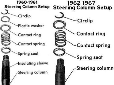

PostPosted: Mon Nov 09, 2009 2:24 pm    Post subject: Reply with quote
This is from my 61-65 Bentley. Sorry i dont have pic but....
Steering Column
Insulating sleeve
spring seat
contact spring
contact ring
plastic washer
circlip
spring washer
steering wheel nut

OK, maybe '66 is different.
I just looked closely at the Bentley assembly picture and in this order the say (listed in order they slide onto the shaft):
    spring seat
    spring
    contact ring
    plastic ring*
    snap ring
* I don't have a plastic ring, and thought it was mentioned earlier that the plastic ring and insulating sleeve were '60ish parts.
So, my spring is definitely UNDER the snap ring and contact ring. Unlike the picture above.
Also, I am assuming the 'contact ring' is the notched ring that the canceler on the back of the steering wheel engages.
The book only shows (1) of them instead of my 3.
No mention of what holds the spring seat from sliding down however. They just show the shaft in a vice, and the seat pushed up against the vice jaw.

PostPosted: Sat Nov 07, 2009 5:42 pm    Post subject: Reply with quote
Yes, those extra insulation parts were for 60-61.
It matters not if there's continuity via that bearing. The steering column itself is isolated from ground by the rubber coupling disk. The steering column tube has the tab there by the gas tank that goes to the horn, and is thus, "live" but is isolated from ground by various pieces of rubber from the body. The only path to ground is the wire that comes up past the steering coupler disk, through the hollow column and up to the horn ring (ok, horn bar on a 65), which is isolated by plastic spacers. So thus, only the horn bar is grounded, everything else is "live"... Push the horn bar down and the brass contact under it hits the brass ring embedded in the steering wheel and then the horn has a ground path and sounds.
-Andy

PostPosted: Sat Nov 07, 2009 5:37 pm    Post subject: Reply with quote
This is the diagram in the Bentley - I founf it here under a '60 - '61 thread:
I don't have the plastic washer or insulating sleeve.
Did they disappear after '61?
Gerg
