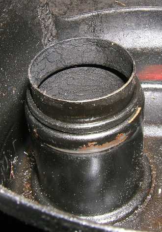

glutamodo wrote:
That one is basically just an O-ring. Where it sits on that pipe, it is 36mm in diameter and the O-ring is about 2mm thick.
http://www.ebay.com/itm/10-Pcs-Black-Nitrile-Rubbe...484fe324d9
http://www.mcmaster.com/#9262k447/=tga4r0
I'm not sure if it was this thread or not but it's been mentioned that perhaps the Knecht filters aren't the best to use because of the diameter of the velocity stack is only 35mm on the inside. Mann filters are 44mm there.
Thanks for the leads. I tried looking for it at local O-ring shop but no luck yet to get the right size.
I tried to place few rubber band as o ring temporary and it did solve the leak issue, so i guess the o ring will work too.
I didnt see the post about Mann filter is a better choice, guess it was in another thread. I am running this filter on an 1.6 engine, it might need a bigger diameter. I only got Knecht filter in hand, so got to work with it until i get Mann.
Here is photo of my filter.

PostPosted: Tue Aug 26, 2014 1:53 pm    Post subject: Reply with quote

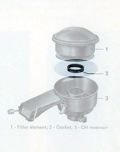

PostPosted: Mon Nov 18, 2013 3:23 am    Post subject: Reply with quote
voilá..here it is..that strange early 40 HP oil bath cleaner in factory literature:

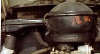

PostPosted: Tue Sep 04, 2012 7:43 pm    Post subject: Reply with quote
The only reason I said it doesn't look it fits very well is this photo:
Application - yeah, it has to be a Bug. The crank breather was added in like June 61, so before that.
VWLady
Crazy VW Lady
Joined: March 13, 2004
Posts: 3868
Location: Twin Cities, MN
VWLady is offline
PostPosted: Tue Sep 04, 2012 7:37 pm    Post subject: Reply with quote
It fits every bit as good as the domed top and seems to seal just fine. With the VW stamp on the top it's clearly a VW part, but what application?
I thought of some other model but I'm really only left with bus or Ghia during this time frame but those are very different.
The mystery continues!
