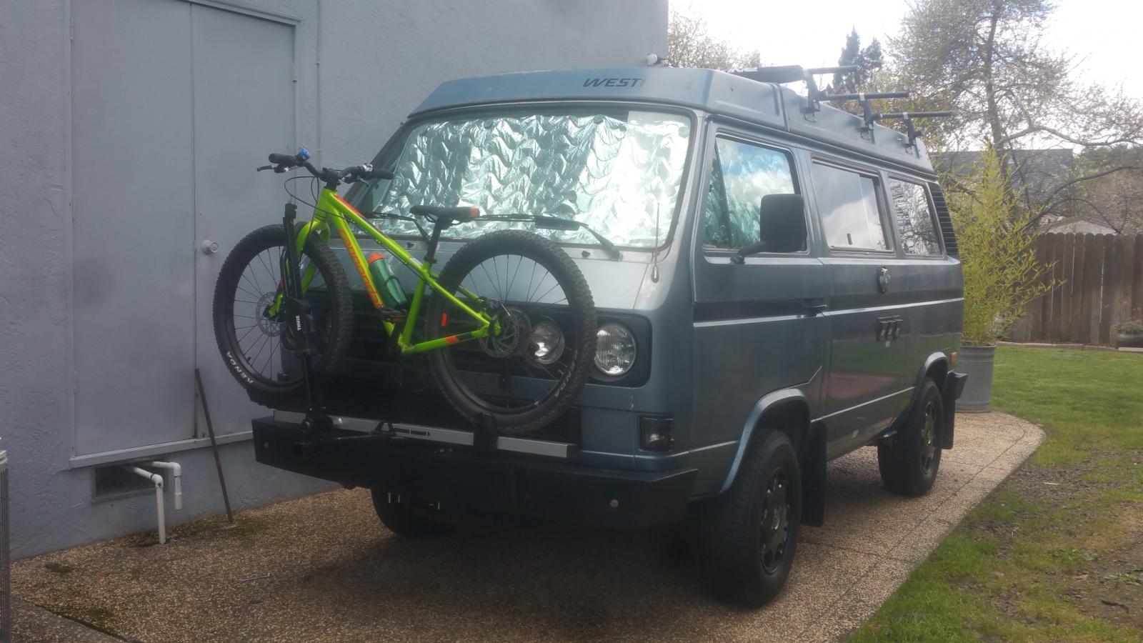

PostPosted: Mon Sep 09, 2024 10:51 am    Post subject: Re: Prerunner vans Reply with quote
Stock height, but with 215/70r15 All-Terrains. In process of upgrading suspension components to make it a more robust and capable off road.

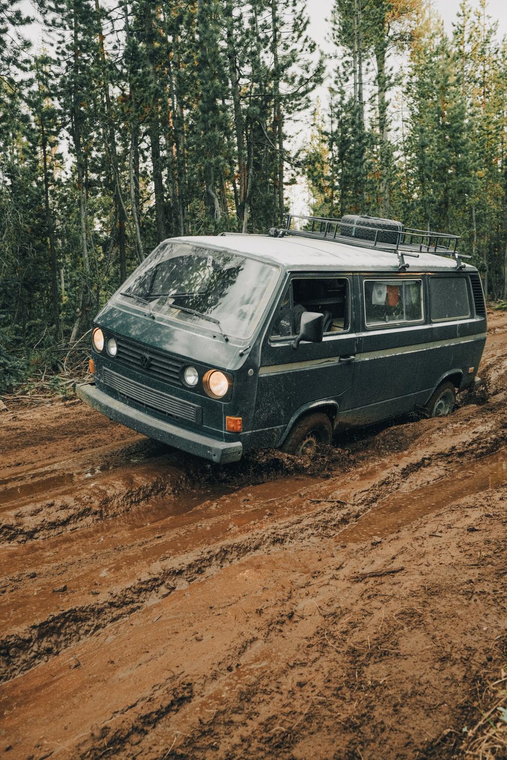

PostPosted: Mon Jun 26, 2023 4:42 pm    Post subject: Re: Prerunner vans Reply with quote
Here's some borderline prerunner abuse on my '84 tiptop. This was the critical moment when my van's front suspension start squeaking and hasn't stopped since!
