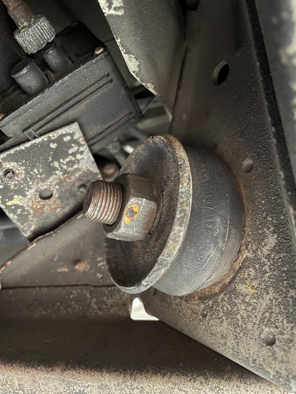

So, I've got an '84 Westy with 105,000 miles. I've owned it for 26 years and I've never had it aligned. I know that sounds crazy but it's always tracked straight, had even tire wear and steered fine, though it was a little sloppy. Suspension bushings are all original, as are the ball joints, except for one upper ball joint that a shop replaced maybe 10 years ago.
A couple of years ago I installed Whiteline steering rack and sway bar bushings, which definitely improved the steering response. About the same time I replaced the original shocks with Koni reds, and went to CLK rims with 205/65/16 tires (which are not much larger than the original 14" tire diameter). All these changes made the van handle much better than it did.
I recently noticed some light feathering on the outside of the front right tire, with the raised edge on the trailing side of the tread. So I figured something must be off with the alignment, probably toe-in. Digging around here I found this thread, and decided to check my alignment myself to at least get some idea of what's out of spec.
Here's what I found: Camber is within spec (-.5 degrees on the left and 0 degrees on the right). Both wheels have a bit too much toe (3mm on the left and 2.5mm on the right, with spec being 1 to 1.75mm per wheel). The real surprise was caster, which I measured multiple times with a digital angle finder using the flats on the steering knuckle. Right wheel was +9.5 degrees and left wheel was +10.5 degrees!
Seeing as how caster can affect the other settings, I figured I'd adjust the caster, see how that affected things, and go from there. So here's where things got weird. In order to decrease the caster angle, I presumed I needed to push the LCA (and wheel) back by "lengthening" the radius rod. The problem is that I only have two threads showing to the end of the radius rod on the right side and seven threads on the left. So I cannot move the radius rod any further back on the right side, and very little on the left. No way do I have the 3+ degrees of adjustment that I need. So, first, am I right that the radius rod (and LCA) need to move back to slacken the caster angle?
Second, I also noticed that the LCA sits very forward in its mounting space in the frame. The bushing is compressed against the frame at the front and there is a gap at the rear. They also appear to be "racked," tilting downward at the front. Could that be part of the problem? I've been planning to replace the UCA and LCA bushings with Whiteline bushings at some point, but will that help or make it worse? It seems like that will move the LCAs back further, which would decrease the caster, but will the radius rods then be too short?
Sorry for the long post, but I wanted to make sure all the relevant facts were on the table. I've attached some photos to show the radius rod ends and the positions of both LCAs in the mounting space. Other than the feathering on one front tire, the van tracks, steers and handles really well. Given that, should I even worry about the excessive caster and instead just focus on correcting the camber and toe-in?
I'm flummoxed. Any thoughts or suggestions would be appreciated. Thanks!

In the pic below from Porter Brown (see the thread here: https://www.thesamba.com/vw/forum/viewtopic.php?p=9481138), you can see the flat spot on the steering knuckle very close to the upper ball joint. That is where you place the DAF to find the caster angle, with the DAF placed, as best you can, plumb (ie straight up and down).
5. Adjust radius rod nut accordingly to achieve specified caster angle. This adjustment is easy, but slow. The movement of the retaining nuts on the radius rods is large for each degree (or portion of a degree) caster adjustment actually achieved. (Note that increasing caster angle gives a faster/stronger return of the steering wheel to centre and a stronger tendency of the vehicle to go straight down the highway as opposed to wandering. Since there is discretion in this adjustment, you can go the the furthest degree within the specification to increase this straightening tendency.)
