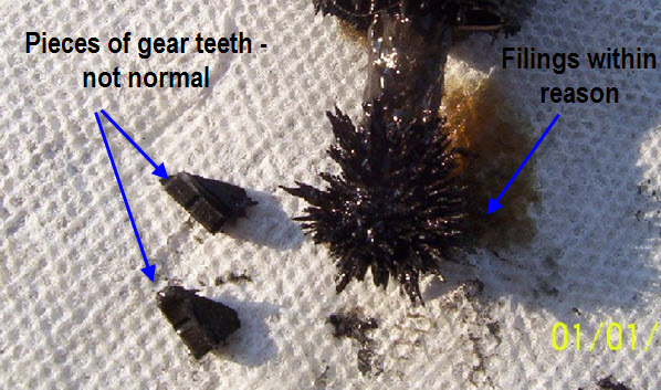

re RAtwell - I can't read Richard's mind but this is my best GUESS what he meant:
Malokin Martin
Joined: August 19, 2007
Posts: 3271
Location: E-burg
Malokin Martin is offline
PostPosted: Thu Feb 04, 2010 5:22 pm    Post subject: Reply with quote
ratwell wrote:
The metal on the magnet is more than normal for 100k miles.

No...metal filings like that are NOT normal. You should have little or no normal wear on gear faces. The only real wear parts in the tranny....if its running well....are non-magnetic. Those look like what you get when you have destroyed bearing cages.
It is reasonably normal to have ferrous debris in a trans. Most Synco hubs are ferrous and although the brass cones engage, there is some wear on the hubs. Also where the shifter forks ride the hubs there can be ferrous wear. Last small itsy bitsy parts wear on the gears over time and that shows up too on the magnetic trap.

I went ahead and topped up with fresh GL-4 gear oil. It still has a bit of trouble getting into 1st and 2nd, but every other gear is fine. The shifter has felt harder to locate gears since the flood, but I will assume thats due to wonky bushings unless anyone else can chip in. I'm going to run it with this oil for a week then drain it out, and possibly take it down and strip it apart to have a good look at the internals. I'll post more pics if and when I get to that stage.
Thanks again!
zade
Many folks in the far north fill their trannies with ATF every winter and drain it come spring and I don't see them falling apart all that fast.
As for the metal filings that really isn't very much, depending on the number of miles on that oil he doesn't have much in the way of filings at all.
If you really want to make that tranny survive...strip and clean it.
the reason you want to do this...is (a) if any of your bearings has a single rust pit or "fleck" that will trash the bearing in a moderate to short time. Needle bearings and roller bearings do not tolerate rough or pitted surfaces.
Hopefully you have no rust on gear teeth and faces. Those are hard and expensive to replace. The real issue here is not to drive it around with bad or damaged bearings.
Damaged ring and pinion bearings can do far more damage to the mesh and wear of the ring and pinion than even light rust on the faces of the ring and pinion themselves. The spyder gears tolerate no rust specs at all ebcause they will rapidly start wearing the thrust washers....and when those wear that leads to spalling of differential side gears and spyder gears.
ATF does work great because its thinner and a great preservative....but if you do not get every spec of it out of the tranny...it destroys the EP properties of the hypoid gear oil. Just ask anyone who has ever lost the seal between the automatic fluid section of the type 2,3 or 4 automatic tranny...getting as little as 4-6 ounces of tranny fluid into the hypoid gear oil and driving on it. It will literally destroy your ring and pinion in about 100 miles.
You can ONLY use ATF...with an additive package...when you are using the tranny in very cold climates....that do not change. Automatic tranny fluid in warm climates...meaning almost anything sub-artic...does not have the EP properties necessary to support a hypoid or semi-hypoid (which yours is) gearing.
You would need to fully flush this tranny with solvent before putting hypoid oil back in. A mix of the two oils does not hurt bearings, needle bearings or synchros...but it will hurt the final drive ring and pinion. Ray

I used to do a lot of off road driving and drained out fluid that looked like yours from every few months to a year. Never really had any problems with it. This was on a non VW which was driven weekly but not daily. I have never been above just filling a gear box with Diesel, driving it around the block a time or two and then dumping the Diesel and filling it again with gear lube.

ATF is a good idea.. it is the recommended fluid when its colder than -31F..

I was going to say find something to flush the trans with, but apparently ATF is the ticket. then fill it up with something decent, run it a few weeks, assuming you drive this thing, then fill it with something good and don't worry about it for another 100k.
the trans only has one tiny pinhole for in/out on it, so it doesn't take on much water all that fast. Also most trans will have more metal than that, thats a pretty clean plug.

+1 for flushing it with ATF. How on earth did your friend come to flip his bus? Strong crosswind?

In very cold climates, VW has recommended ATF (like 10* below zero) in the manual boxes. I would think a nice short run down the road with some ATF to use as a flush would really help get rid of not only some of the sludge but it would also help blast out rust from bearing races. ATF has excellent detergent properties. Change and refill with GL4 80-90.

The only problem would be if the bearings were rusted and it's impossible to tell that unless you tear the tranny down.
It's probably OK. It appears some water got in but it settled to the bottom of the tranny until it got mixed in by driving. As long as the bearings were not full of pure water, they are OK.
Drive it and see what happens. 9 chances out of 10 there is no serious damage.
