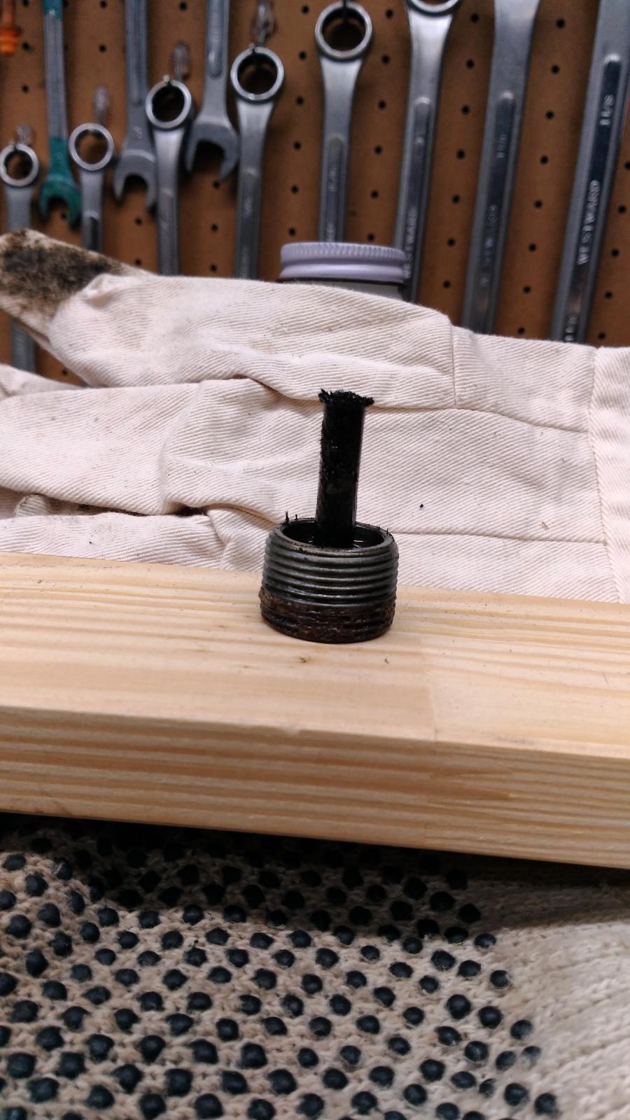

Anything that looks like on the first pic, says your bearings are wearied out.
The metal dust comes first from bearings, and after from followed damages.

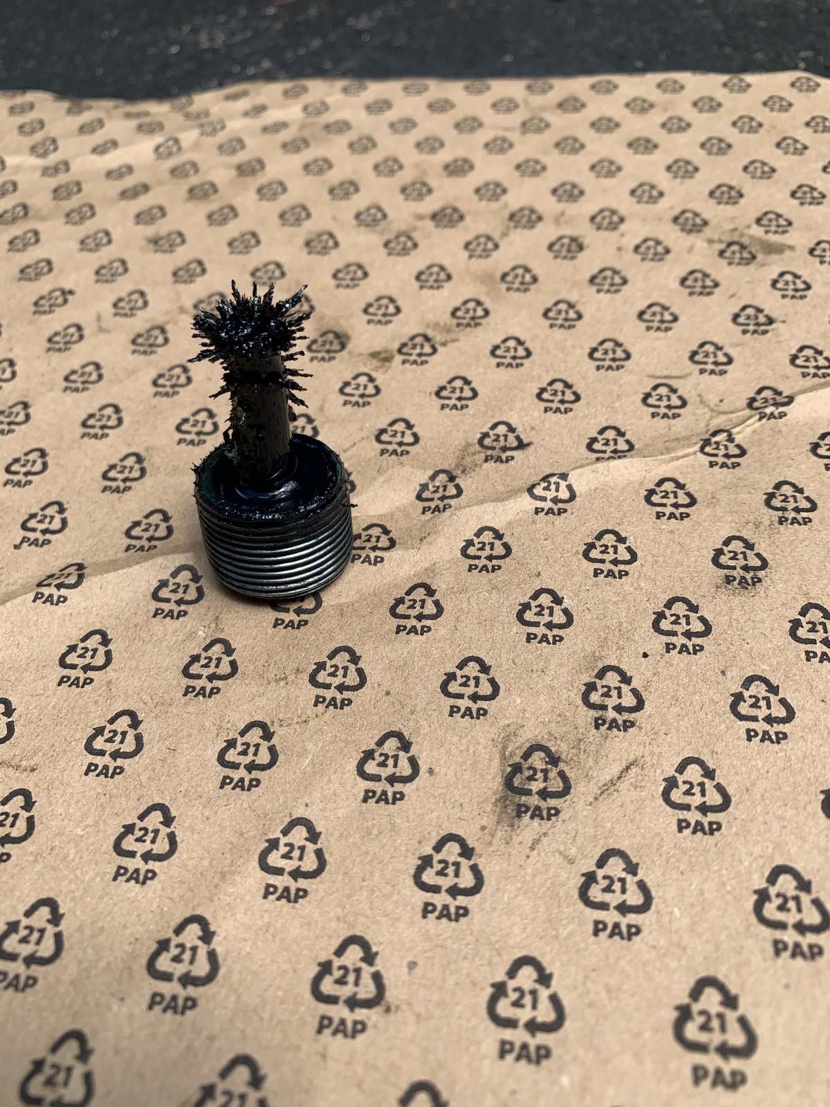

PostPosted: Sun Jul 14, 2019 12:34 pm    Post subject: Re: Manual Transmission Drain Plug - metal on plug Reply with quote
So you’re running about 135HP?
And drive “mellowslow”?
Sounds like a good plan.
You could probably “settle” that nice clear Swepco for a few months then decant the purified oil off the top & run it again.
My oil was perfect green & clear until I did a 3,000 mile trip at 80mph then it turned dark (15,000mi). I have a 173 HP Subaru. I have an elaborate trans cooling system and my trans never gets hotter than 143*F. I suppose the cooling raises the HP capacity of the trans some, but not enough to stand 80mph continuous.
I won’t be doing that again. My new speed is 70.

PostPosted: Sun Jul 14, 2019 11:49 am    Post subject: Re: Manual Transmission Drain Plug - metal Reply with quote
Sodo wrote:
You have “some” clean space on your magnet. Thats a really good sign. And no big parts.
Id fill it with FLAPS gear oil ($16) and drive it a few hundred miles, then drain it hot & fast, with the front wheels about 10-12” higher than the rear. Then put in your next batch of Swepco. Then NEXT time you’ll know you’re magnets showing “new” trash only. And you’re not pre-polluting your new specialty oil with old metal.
Old transmissions (and rebuilts, which include many hi-miles used parts) require more frequent maintenance than the original trans, which was 100% new and built in a clean-room of super-clean parts. An OEM built trans is a different unit than a rebuilt, it can go 90,000 miles on its oil cuz there is no pre-trash, no “older parts” are putting metal trash into your lubricant. You are wise to check at 20,000 miles.
Seeing how much metal is circulating in your lubricant at 20k, don’t you kinda wish you checked 5,000 miles ago? Luckily you can do this maintenance yourself -lots of Van Owners can’t.
What engine do you have?
Volkswagen of Mexico built AEG code 2.0l with a tuned ECU. Installed with zero mileage out of the crate.
Wow post up data to benefit the list and get a complimentary visual analysis! Many thanks.
Yes, a longer stretch for the change interval. The 201 showed close to original blue color and really didn't seem broken down or contaminated. Guess I could have done worse.

PostPosted: Sun Jul 14, 2019 9:06 am    Post subject: Re: Manual Transmission Drain Plug - metal Reply with quote
Id fill it with FLAPS gear oil ($16) and drive it a few hundred miles, then drain it hot & fast, with the front wheels about 10-12” higher than the rear. Then put in your next batch of Swepco. Then NEXT time you’ll know your magnet is showing “new” trash only. Ir gives you a better idea what’s currently happening in the trans. And you’re not pre-polluting your new specialty oil at mile-one with old metal trash.
Think if some fellow defied the mfrs recommendations that the oil doesn’t need changing. And replaced the lubricant every 30k miles. That would be a nicely preserved trans, with gears in perfect condition. But its too late now, the trannies all gave their 90k miles of “trouble-free lifetime” and owners were satisfied. Perhaps not with their head gaskets though.

PostPosted: Sun Jul 14, 2019 6:39 am    Post subject: Re: Manual Transmission Drain Plug - metal Reply with quote
Approx 20K with Swepco 201 in the box

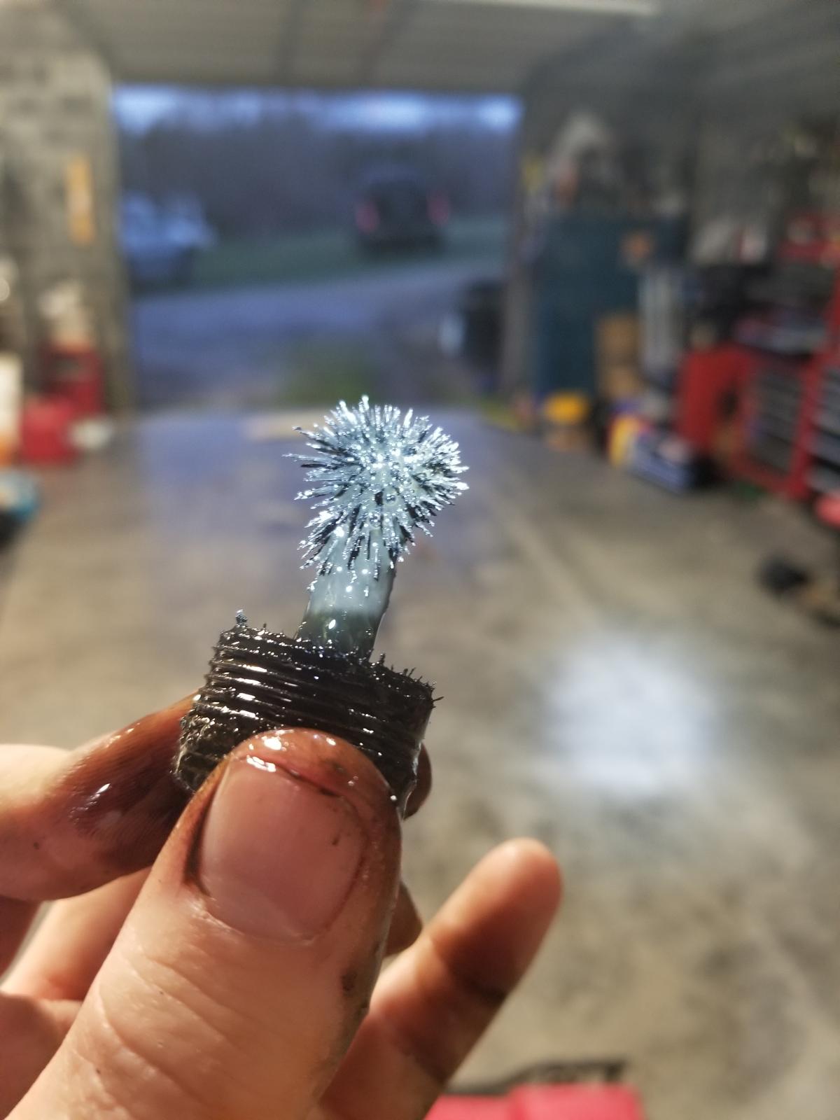

PostPosted: Fri Feb 23, 2018 2:24 pm    Post subject: Re: Manual Transmission Drain Plug - metal Reply with quote
Sodo wrote:
I’d do the quick flush (200, 500 mi?). If it comes out clean after the flush then go 5000 and look again. Ya gotta get to a clean baseline condition or the magnet can’t tell you anything. Of course it can tell you if yer fooked but what you want is to know is.... if you’re GOOD.
I think you need Swepco for big engines. What yours?
I have stock 1.9 engine with stock transmission. I'll buy some 80w-90 cheap stuff and do a quick flush - 500 miles.
Should I just stick with the RedLine after? I mean if I recall, in the winter I bought the redline because Swepco 'warms up' after 10 miles.

PostPosted: Fri Feb 23, 2018 2:21 pm    Post subject: Re: Manual Transmission Drain Plug - metal Reply with quote
....KTMs, GasGas, SPOT mtb

PostPosted: Fri Feb 23, 2018 2:11 pm    Post subject: Re: Manual Transmission Drain Plug - metal Reply with quote
Sodo wrote:
The only thing good about that hairdo is the particles are all really small. Which suggests that theres could be some life remaining. But make no mistake, you waited far too long, and suffered losses in running your trans with that much metal in your lubricant. From what I read, you don’t know the miles but it’s more than 7,000? However If thats “7,000 miles since last change” that trans is going out SOON.
WRT Redline.... any clean oil you can find anywhere is hundreds of times better than that oil. I think you should flush soon (with any two clean oils) & get ‘clean’ to allow a valid assessment after a few thousand.
I put 7K miles on the van since I have owned it. I'm not sure before when it was changed. Yeah I'll run the Redline oil for 5k miles then post back? I know Redline is overkill for 5k miles, but I already bought it. Is that too short/too long? I plan to swap to Swepco.

PostPosted: Fri Feb 23, 2018 1:41 pm    Post subject: Re: Manual Transmission Drain Plug - metal Reply with quote
Syncro Jael wrote:
That looks pretty good if it has thousands of miles of use.
You are sure about putting in Redline as your gear oil of choice?

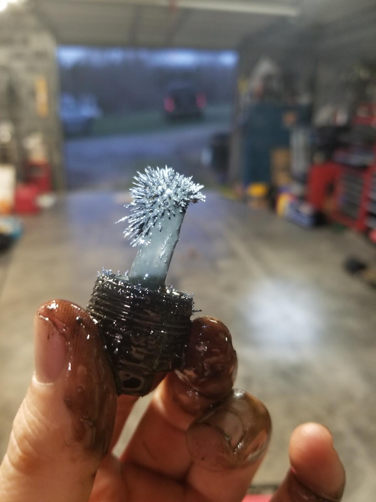

PostPosted: Fri Feb 23, 2018 7:35 am    Post subject: Re: Manual Transmission Drain Plug - metal Reply with quote
Syncro Jael wrote:
shagginwagon83 wrote:
dhaavers wrote:
Cute! Wink
How many miles since last drain...???
- Dave
Unknown! But the drain plug and the fill plug came out pretty easily. I'm going to put in some cheap 75w-90 weight oil and run it for like 500 miles. Then drain it then put in my RedLine 75w-90
It has at least 7k miles on this manual transmission. No I'm not sure if you're questioning my choice! I will explain myself. I didn't go with Swepco because I heard that it takes a while for oil to warm up. I went with Redline 75W-90 because GoWesty recommends them. I already bought the Redline too Sad. I have a hard time finding 2nd gear when cold. Double clutching helps. Once warmed up it works great.
Dammit. I'm just going to use the Redline for my 'flush' oil. I'll switch it out in 5k miles I guess

PostPosted: Fri Feb 23, 2018 7:18 am    Post subject: Re: Manual Transmission Drain Plug - metal Reply with quote
dhaavers wrote:
Cute! Wink
- Dave

PostPosted: Thu Feb 22, 2018 9:18 pm    Post subject: Re: Manual Transmission Drain Plug - metal Reply with quote
dhaavers wrote:
Cute! Wink
- Dave

PostPosted: Thu Feb 22, 2018 8:41 pm    Post subject: Re: Manual Transmission Drain Plug - metal Reply with quote
Cute! Wink
- Dave

PostPosted: Thu Feb 22, 2018 5:22 pm    Post subject: Re: Manual Transmission Drain Plug - metal Reply with quote
How's my plug?
