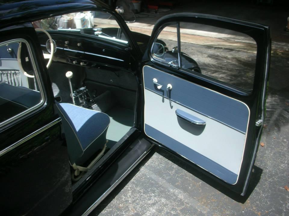

1958 diamond grey with 32 original kmiles:

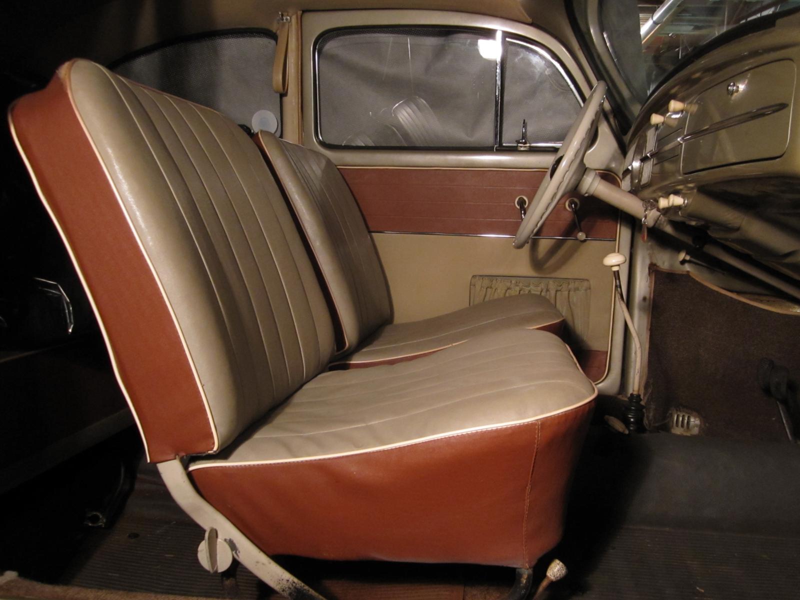

Resurrecting a dead thread in hopes to help out future restorations on 1958/59 seats and upholstery.
Over the course of the weekend I disassembled the seats in my 1958 Beetle, and recovered them. Upon removing the two layers of questionable seat covers I found the original factory 1958 Blue/Grey cloth interior. Unfortunately it wasn't in saveable shape, and this thread basically holds all the info needed to know what it looked like, but I can confirm a few items for those looking to do a factory restoration on their cars:
1) Cloth seats definitely had the strings pulling the seat cushion down on the front seats, to create that 'pleat' (for lack of better term) in the seat bottom. Visible in this sample photo I've pulled from the Samba:
2) Rear seat, definitely did not have the strings. I've seen '58/59 restorations that pleated the rear seat as well.
3) Factory seat padding had Jute glued on the outer 6" of both the bottom and back cushions...front and rear. Presumably this was to smooth out the corners on the seats and keep the padding from breaking down.
Sorry, no photos.

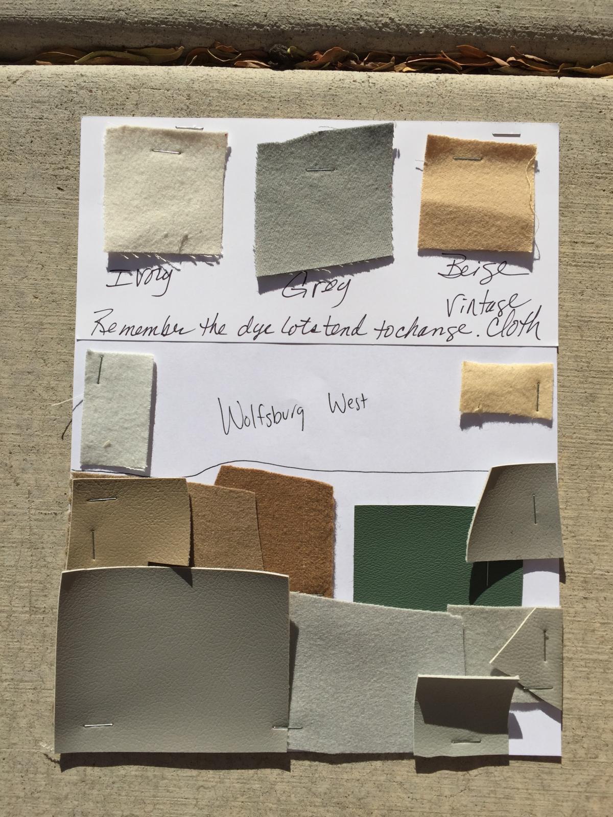

PostPosted: Thu May 12, 2016 11:43 am    Post subject: Re: 1958-59 Export Model Interiors Reply with quote
Another update. I have SMS in Oregon color matching my original door panel to non sun-faded parts.
Another dilemma.
Does anyone have an excellent example of original light beige headliner?
Top is Sewfine and is a bit too ivory. WW (middle) and Lenny (bottom) are a bit too beige.
Here is one I found at SMS Auto Fabric, I like the color but have nothing to compare it too. On the side is the original color card for my color car, but it is just a picture so....
Thoughts?

PostPosted: Fri Mar 25, 2016 10:51 am    Post subject: Re: 1958-59 Export Model Interiors Reply with quote
Last update and then hopefully I'll make a decision.
Got the material samples from SMS in Oregon. Excellent quality pieces, perfect texture and very close on color.
The green is very close. The ash tray area is a close approximation of the original color. The first sample is what I believe to be the closest. The 2nd one is more forest green and brighter. The 3rd sample is the Naugahyde from the previous post. And the one on the far right is the Original Auto Interiors sample which is too dark.
The grey is also very close.
The first sample is from SMS and has similar backing to the one on the far right from Original Auto. I think they are the same material just slight variation in color from storage over time. The middle sample is a close version from Naugahyde from the previous post. The background is an original door panel where the seat covered so minimal sun damage.
Moral of the story: the material exists in perfect texture and very close color. Now to get the seat covers made!
-Ryan

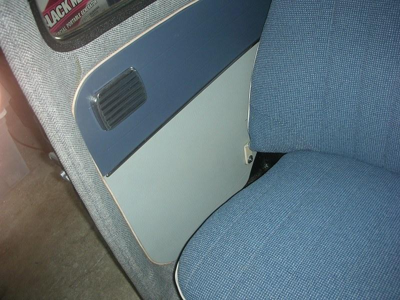

PostPosted: Tue Mar 15, 2016 9:11 am    Post subject: Re: 1958-59 Export Model Interiors Reply with quote
my rears

PostPosted: Tue Mar 15, 2016 9:09 am    Post subject: Re: 1958-59 Export Model Interiors Reply with quote
My buddy restores these door panels these are mine on my 1959, , 58 , 59 interiors are the best looking in my oppinion .

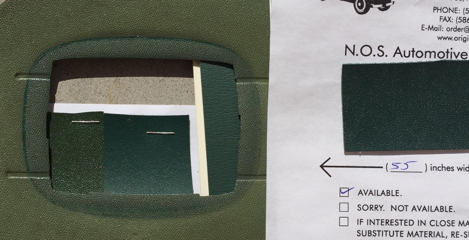

PostPosted: Mon Mar 14, 2016 3:23 pm    Post subject: Re: 1958-59 Export Model Interiors Reply with quote
Further update.
These are material samples compared to my cleaned and original door panel piece.
This is from Original Auto Interiors in Michigan.
Below is showing the two colors, the grey on the left side of the picture is the portion of the door panel covered by the seat. A more accurate color comparison. The green in the ash tray area is also behind the ash tray itself shielded from more sun damage.
Close up.
Another close up.
The two colors from Original Auto are:
#1955 Dk Green Haircell $55/yd
Ivory Haircell Drill Backing $55/yd
Speaking with my upholstery guy, he says 4 yards of grey (Ivory from Original Auto) and 5 yards of green should do it.
I am still waiting on SMS to send samples and have also yet to find a better headliner color match than the Sewfine ivory in the previous post.
I'll report back as soon as I know!
-Ryan
