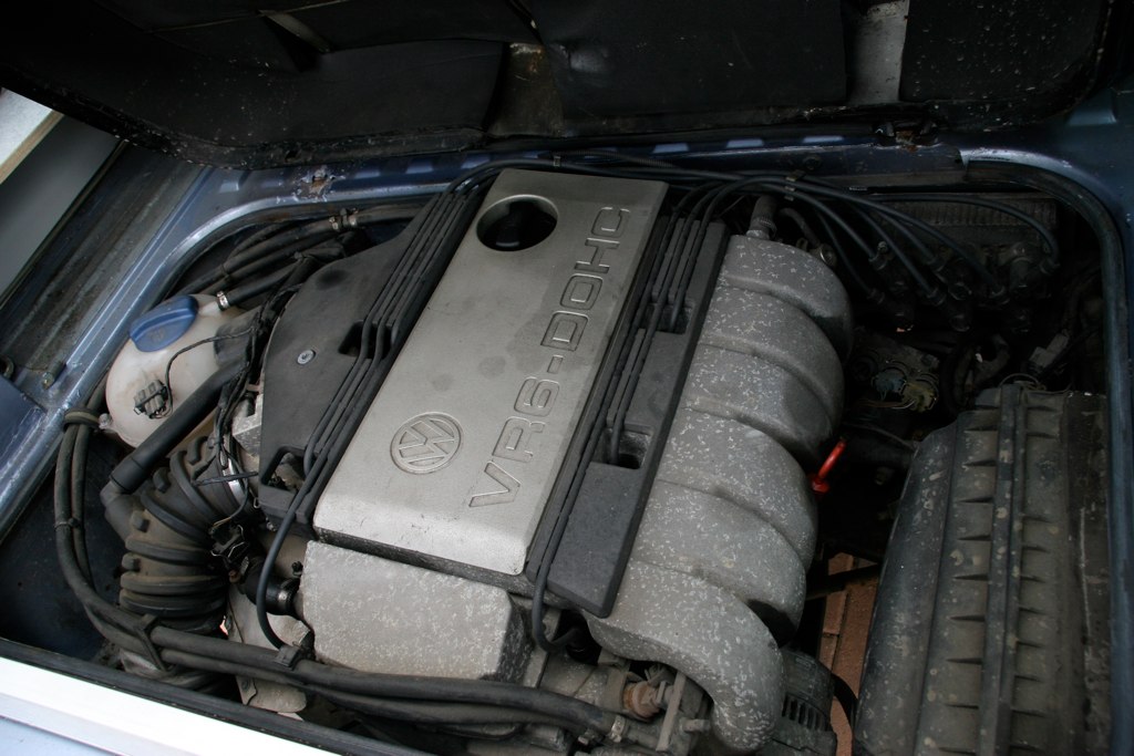

PostPosted: Thu Sep 09, 2010 8:18 pm    Post subject: Reply with quote
from the Vanagon gathering White Salmon thread...This smelled like my brand new 1997 GTI VR6..simply amazing conversion...
Beautiful custom rack
Power!
Under the VR6
Happiness=Portland, Oregon in the rearview mirror!

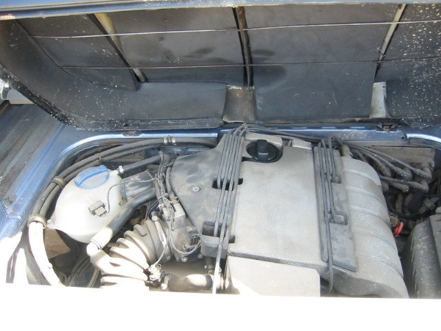

casey79westfalia wrote:
James,
You mentioned that all engine until 2002 are similar, here is a 2000 and it looks like this.
Same engines...different manifold systems.
That's a 12V with the plastic intake manifold. Under it, it's the same old block and head that the Corrado has.
I think it was starting the mid 1999 year that got the plastic manifold on the 12V motor. Then in 2001 only the Eurovan got the the 24 Valve VR6 (different block and head than the 12V) and then in 2002 the Golf got that motor, which then was increased in size for the 2004 R32 Golf.
Any 12V motor from 1992 to 2001.5 is the same as far as the head and block go. Even the early distributor motors can be run as a coil pack with the correct timing chain covers.

James,

Here are some pics of the above vr6 install. I am using this as my inspiration. I actually dont mind the raised decklid when I realize how clean it could be done. Plus I actually like the idea of having storage/tool compartments right around the engine when a problem arises. Even a nice light on the lid so that I can see the engine compartment at night. This is gonna be fun.
My biggest concern is the wiring. I am sure that I can do the mounting and get it to look good in there. What I am not sure of is how I am going to make sense of how the wiring connects to the vr6 and all the computer related stuff. I am going to study all the vr6 swaps so i can get it clear in my head.
[/img]
