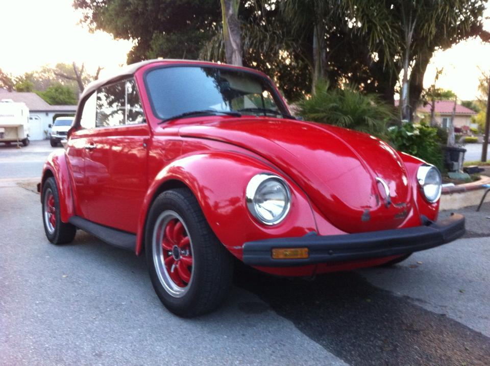

PostPosted: Sun Apr 28, 2013 5:28 pm    Post subject: Reply with quote
some punches at the eyes and wala u have a black eye
theduckwithluck
Joined: April 25, 2013
Posts: 19
theduckwithluck is offline
PostPosted: Sat Apr 27, 2013 3:53 am    Post subject: Reply with quote
theduckwithluck
Posts: 19
PostPosted: Sat Apr 27, 2013 3:52 am    Post subject: Reply with quote
Nepenthe88 wrote:
There... that's better! Very Happy
TjD was right when he said stripes would be too much. Knowing that, I had to say goodbye to the white Hella caps.
https://www.thesamba.com/vw/gallery/pix/1054165.jp...054164.jpg
looking the same jst convertible and im actually gonna paint the rings later today ha but hey nice bug u got there my friend!

PostPosted: Wed Oct 24, 2012 2:42 pm    Post subject: Reply with quote
Nep88 ( I hope you dont mind that I shortened your name a little Smile .) I want to tell you that the 1st thing I read on here was your build on this thread, then the bugtruck, and how you lucked out on that Karman Ghia barn find. Best of luck to you in your restorations.
