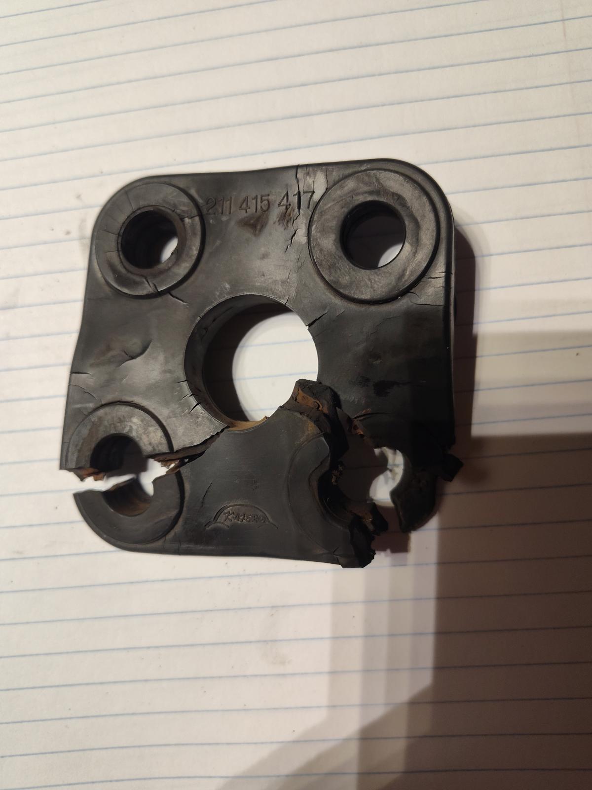

PostPosted: Tue Aug 05, 2025 5:19 pm    Post subject: Re: Steering Coupling Disc 211415417 (coupler) Reply with quote
So, I just threw a new coupler on after about three years of a "Kafer" brand one (at least that's what I can make out on the remains). I ordered one from Bus Depot mostly as a just-in-case spare to keep around because the steering was feeling a bit dubious again, but before leaving on a trip discovered that my "Kafer" coupler was, in fact, torn through on one of the holes and in bad shape otherwise.
Took about an hour and change to throw the new no-name coupler from Bus Depot in and I was on my way. Steering felt better.
Until it was time to parallel park. This thing is about a structurally sound as a melted pile of gummy bears. (see action photo below). I informed Bus Depot and they credited me back 10 of the 13 dollars (minus shipping) that I had spent, and I was told that it would be run up the ladder that the part they're selling is unsafe and they should seek another vendor.
Long story short, where are people getting these "Lares" or "Ok-Bus" couplers here in the states? I'm in Massachusetts.
Action photo with the brand new coupler (with my 7 year old daughter pulling on the steering wheel):
Also, failed Kafer coupler:
[/img]

raygreenwood wrote:
Looking at the diagram of the column and looking at his video where the housing stays stationary but the steering wheel pulls in and out.....one has to ask where the axial movement is coming from.
The suggestion that it is coming from the yoke on the steering box splines seems (from the exploded diagram) to be the most likely cause....yet I just could not see that amount or motion coming from the yoke and it's pinch bolt. Yet I could see a lot of flex from the coupler.
A combination of both?
And, if memory serves, that pinch bolt resides in a groove across the splines steering box shaft so even if it loose.....it should never be able to move more than about 1/16" max.
Question: the bus steering column shaft at a glance appears to be a solid two bolt flange on the steering column shaft. But....is it actually pressed in with splines like a type 1, 3 or type 181 flange?
If so, if it is pressed into the end of the steering shaft....perhaps it's the steering shaft end that is slipping in and out and not the steering box clamp bolt flange. Ray
That is correct - the pinch bolt does reside in a groove across the splines that does not allow much vertical movement at all (about 1/16" like you mentioned). I did double check the pinch bolt was tight and the yoke did not move one bit when performing this test.
To answer your question - the steering column shaft is the solid two bolt flange not the pressed in type.
And yes 1975 busses have the spring under the steering wheel. See below:
