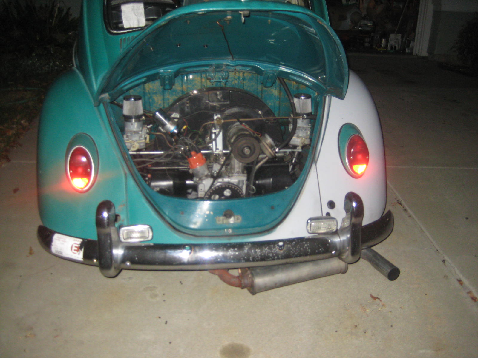

PostPosted: Wed Nov 17, 2010 11:37 pm    Post subject: Reply with quote
Pic after a week of use and abuse...
You cannot fight with STUPID people; becasue you have to get down to their level and they will beat you up with experience.
