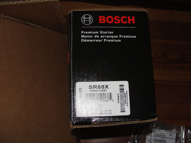

PostPosted: Wed Jan 05, 2011 10:37 am    Post subject: Reply with quote
Someone beat me to the wheels. I guess I'll run stock steels with 27x85r14. May go with Maxxis Bighorns, or Gereral Grabbers. The grabbers are priced right so will probably buy 5. Got more swap goodies in the mail this am:
Full stainless exhaust with cat and 2 O2 senosor ports:
EJ22 oil breather plate and seal kit from ebay vender even comes with new hardware:
High output Porsche starter SR68X thanks to thesamba.com recommendation:
Flex plate adapter and hardware:
So far my dealings with smallcar have been positive. Looks like I have everything, it would help if they included a packing list that itemized everything that should be in the box. That is their only flaw so far and where bostig definitely has them beat. I just didn't have a bostig budget plus I like where the suby power is. Next I have to get wrenching!
