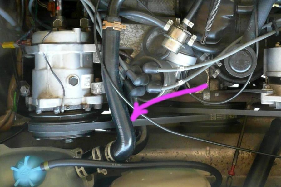

Mine has a slight nick on the bottom side that must have come from that belt -- but for the life of me I cannot see how it made contact. Would like to assure it won't recur before I replace the hose. PS: Motor mounts are nearly new.
Ahwahnee - I didn't see the text below your uploaded image until now. Sorry for not giving a bad answer Laughing I may have accidentally answered it though. My guess is that my whole coolant tank system was jostled forwards a bit, and that push was enough to touch the belt. I can't see it happening any other way.

@Ahwahnee - The hose below the one you have pointed out. The PO had a metal H Pipe made that I don't think is to spec. There was also a rigid plastic pipe connecting what should have been one hose. It's the hose that connects to the water pump. It has 2 bends - hence the need for a diy rig job. Don't know if they couldn't find the OEM hose at the time, but that's what happened.
Also, coolant tank with all the hoses attached was a bit loose - as in sort of free floating Laughing I think what happened was as we drove down some fire roads, hitting big bumps made everything move back and forth. A touch here, a touch there, and before you know it, I was smelling coolant at a rest stop.
Tank system tightened down and a new hose.

BetaVan wrote:
...Only issue was my AC belt sawed a pinhole leak through a hose 100 miles from home...
This hose?

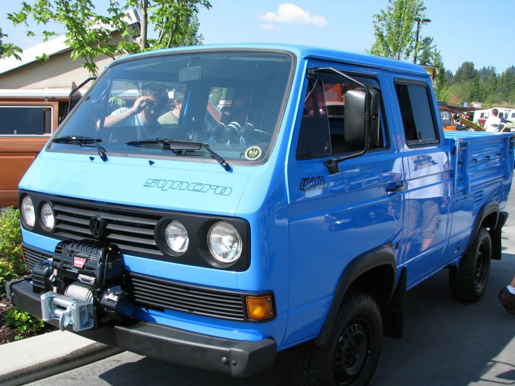

nelinor wrote:
tencentlife wrote:
This one:
Oh, and this was my contribution:
Shocked what color is that? I'm guessing it's not a stock color.
I saw this truck at what I think was its' unveiling, at the Great Canadian VW Show in 2009. I was certainly the second nicest Syncro there - by a long shot. Dude said it was a stock colour, and by looking at behind the seats etc., I'd have to agree...
