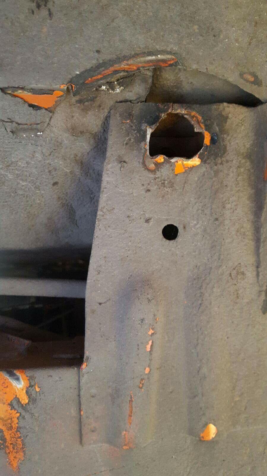

PostPosted: Fri Sep 08, 2017 8:05 am    Post subject: Shock Mounts Rear Reply with quote
Just a heads up.
If shocks are installed with load carrying capacity in mind.
Reinforce the upper shock mounts. The metal is pretty thin in that area.
These pictures where the result of hitting something in the road.
But it has been reported that the shock mounts can experience cracking and tear out, with loaded air shocks and coil overs.
Good luck
