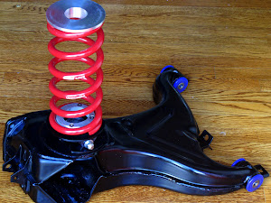

insyncro wrote:
As the rear part of this kit is not adjustable in height and limited to a few stock parameter spring rates, when using the GW Fox setup and the GW springs in vans with engine conversions and or extra rear weight.... the rear will sag compared to a waterboxer powered van with the same setup.
This means that you will have to adjust the front to a lower position for the van to sit level.
It seems like you could use any of the available springs in the front and especially the rear (.org, SC, GW, Trailmaster, Boge...) Spacers or limiting straps could be used if needed.
Even the Eibachs in the rear would probably work with lots of rate options
Why wouldn't an Eibach 5" diameter spring work on the front also? Then there are lots of choices in spring rates. My .org front spring is 5" diameter.
Maybe I am over looking something here?
