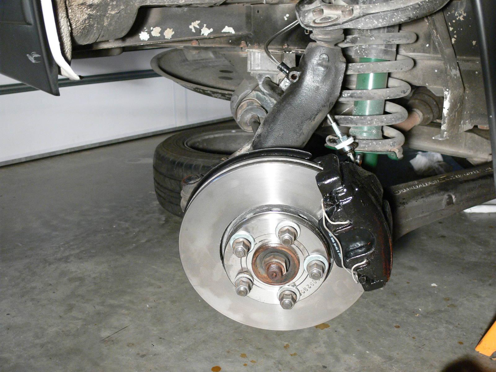

Well, my VC big brake kit is in and while I'm still doing the bed in on the new pads everything is working well and there is already a notable difference in performance.
However, now I have a new problem. The clutch master cylinder, which was working fine, has crapped out. Mad
I guess it couldn't handle new fluid. As part of the brake upgrade I took the time to completely flush all the old fluid out of both systems. The fluid was pretty dark in the clutch system, not so bad in the brakes. I had flushed the brake system back a year or so ago when I rebuilt the rears.
Time for a new clutch master cylinder. I just did this job on the Joker! Confused
Sure wish we could get rebuild kits for these! The one I took out of the Joker looks brand new. Even the bore is clean, just old seals.

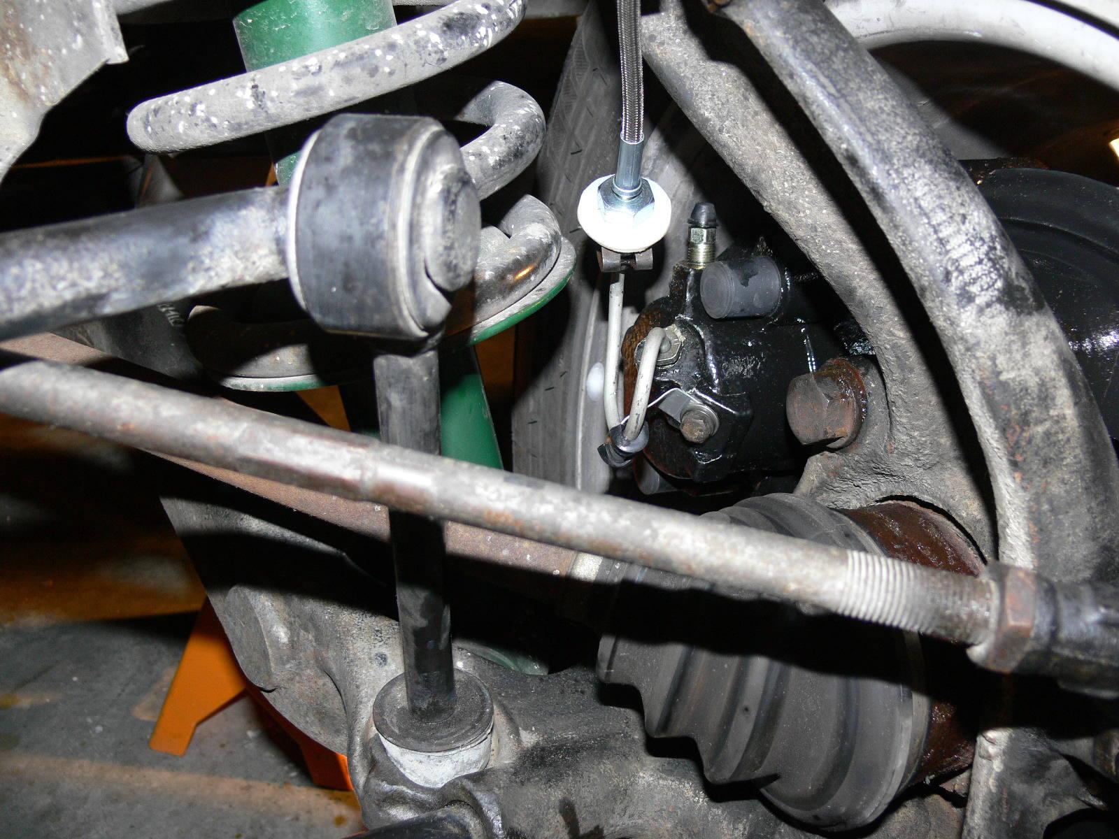

Here is what I ended up doing.
The white washers are made from UHMW plastic, and serve as spacers for the tension spring only.
Everything clears nicely and the homemade mount seems to hold the rigid line pretty firm.

Hi everyone who has VC Big Brakes.
What did you do about the hose support where the flex line meets the hard line at the caliper?
I used a big stainless steel hose clamp - it seems plenty strong to me. But then, I don't have a welder so...

Take flat stock, drill a hole where it will attach to the caliper, heat the center of the stock in a vice, twist it to the desired angle, drill a hole for the union of the lines and assemble.
Some of the SA calipers I have seen in the past lack a tapped hole for this.
If so, I make up my own braided lines with a swivel banjo fitting at the caliper and only support the braided line at the stock location on the upright, knuckle, spindle....what every you want to call it.
If you want to use the lines you have....get a male/male adapter to attach the line directly to the caliper.
If you do this, drop the suspension to full droop while on stands to make sure the line is long enough.
Attach it to the knuckle at full droop.

insyncro wrote:
I fabricate a mount.
GW uses zip ties.
Yep, kinda what I figured. Zip ties just don't seem good enough.
I've got the knowhow, but not the equipment, to fab up something nice looking. Guess I'll have to do what I can with a bench vise, pliers, and a drill.
Insyncro- any photos of your mounts for inspiration?
