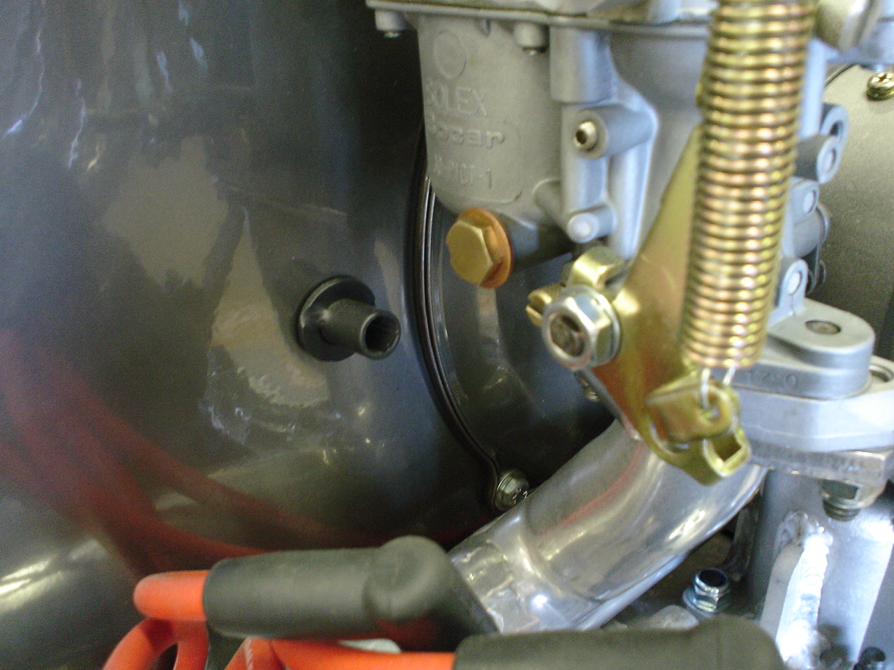

Throttle cable tube like this for the Zenith/Holly helps too.. Its a 3/8 brake line with a washer welded on.

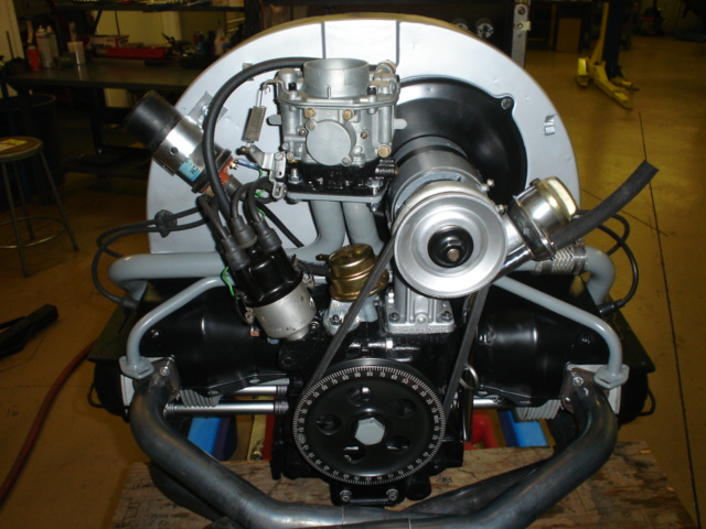

Holly or Zenith? If that was the only choice it would be the Zenith (for sure).. Issues are the throttle cable is a problem to line up on most manifolds, In the old days most builders Just took the oil cooler out and installed the remote oil cooler off the top of the case, and moved the throttle cable over..
Also, Jets for the Zeniths are hard to find, but if you get them set up right they run very nice.. Note this Manifold, it has a twist to allow the throttle cable to fit.
This PIC was on the dyno so the exhaust was changed later, also the heat risers were hooked up and the throttle spring was moved back to the back stud..
This engine I built 5 years ago.. Ran nice, Was in a BAJA. Had high compression..8.5:1 and so the manifold had to be cut.
