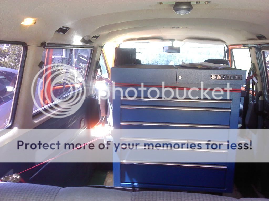

I would pull off the door card opposite to the sliding door, make or mount something solid that has loops to hook a nylon ratchet strap to. I'd strap it to that wall with the drawers accessible. looks like you would need some blocking behind it to keep the top back edge from hitting the window...
but it seems to me that's the most useful spot, like a westy kitchen.

If your new, stronger upper strap were long enough to be able to wrap completely around the box at that point, it would greatly help to minimize any side to side movement.

so im going to leave the orientation like this. not as convenient but i dont need to rotate it this way. i can open all the drawers with the straps attached. i attached the (need to get stonger)straps to the lower upper seatbelt anchors (now i know what those are for Cool) I blocked it between and away from the seat towers with auto ramps placed vertically on end. to prevent it from tipping forward i used what i think is the hole for the rear three point seatbelt mount located just behind the rear seatback pins. Hope these seat belt mounts are strong enough Shocked

the ramps work great. takes about 5 min to setup and push up with one person. the drawers aren't easily removable and are ungainly when loaded with tools.
my next challenge is to figure out how to secure the box when im on the move. ive used some blocks to prevent the box from rolling forward along with some tie down straps attached to the posts that the rear seatback attaches to. this is not ideal as the posts cant be that strong. the other problem is side to side tipping when i go around corners even slowly, the box wants to tip over. im looking at the tracks that the middle seat mounts to...
part of the challenge is not having to undo a rube goldberg setup when i need to access the box. the orientation of it is not ideal. ideal would be the long dimension going across so as to not be tippy, 90 degree turn from the pic with the box all the way forward blocked against the front seat towers. id be alright if i could reduce the tie down straps to one and rotate back into the position in the pic once at the job.
what if i mounted the tie down strap to a modified bolt on the seatbelt anchors near the door vents. it really only needs to hold the box from moving backwards under acceleration. i find acceleration the easiest force and safest to manage to as opposed to worrying about braking to hard or cornering to fast in a "situation"
