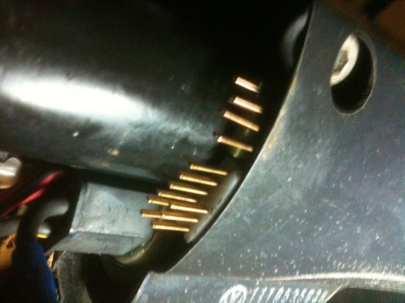

Tx for the reply Al but unfortunately not what I'm looking for.
In the 4th pic up top. The female connectors that are zip tied together. Those 2 are the ones I'm looking for.

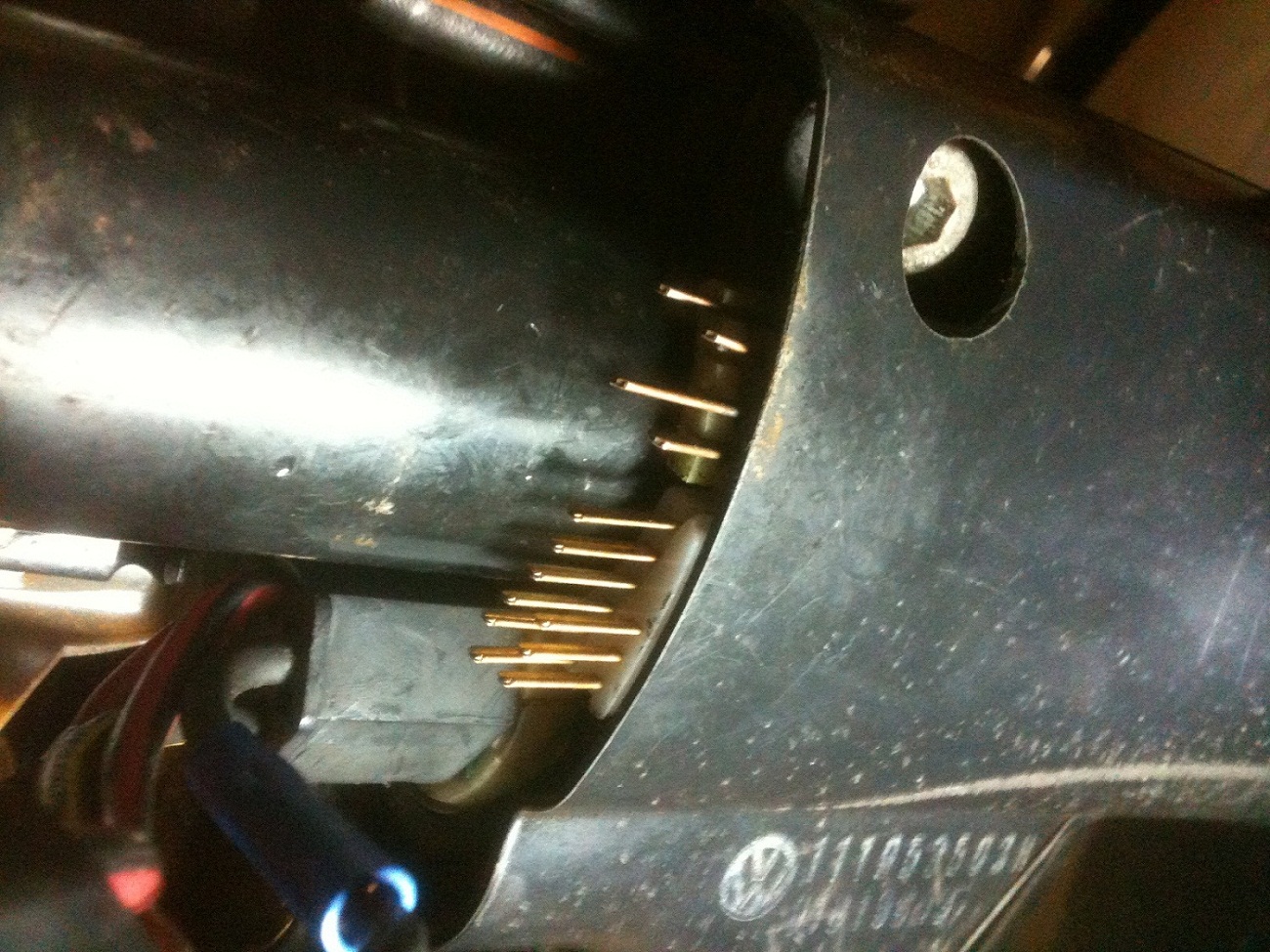

PostPosted: Fri Aug 19, 2011 8:53 pm    Post subject: steering column wiring, turn singal, wiper switch, etc Reply with quote
I am hoping someone has done something about this before. First of all, '73 super beetle, new turn signal switch, but not new wiper switch. If you see the pictures, you can see that I need a new wiper switch.
My problem is that the "plugs" left on the wiring harness that hook into the male plugs at the base of the steering column for the wiper switch, turn signal switch, etc have worn out. The female plugs no longer hold onto the male wires from those switches, and fall out while driving. I have used the "zip-tie" method, but now its gotten to the point to where it is not reliable.
My thoughts
#1 cut the plugs off the harness, and put spade terminals on every wire for all the switches on the column.
#2 do the same, but solder and heat shrink all the wires
#3 try to find some new plug and modify it to make it work.
what are your thoughts?

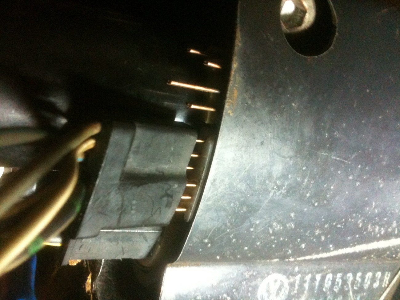

As you can see in photo one, the wires on the plug for the wiper switch have come loose, and you can see in photo 2 that I have moved them. I know that I should get a new one, its on the to do list once I figure out how to make the plugs work

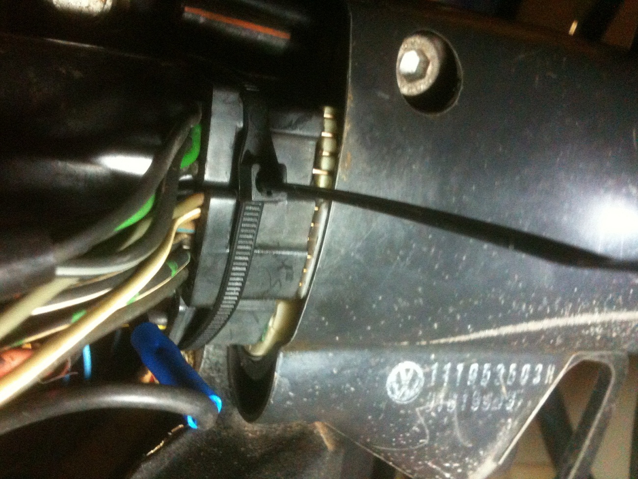

You can see in the next picture that I plugged in the turn signal switch, and it is already falling out
and here is the good 'ol "zip-tie" trick, which no longer works
