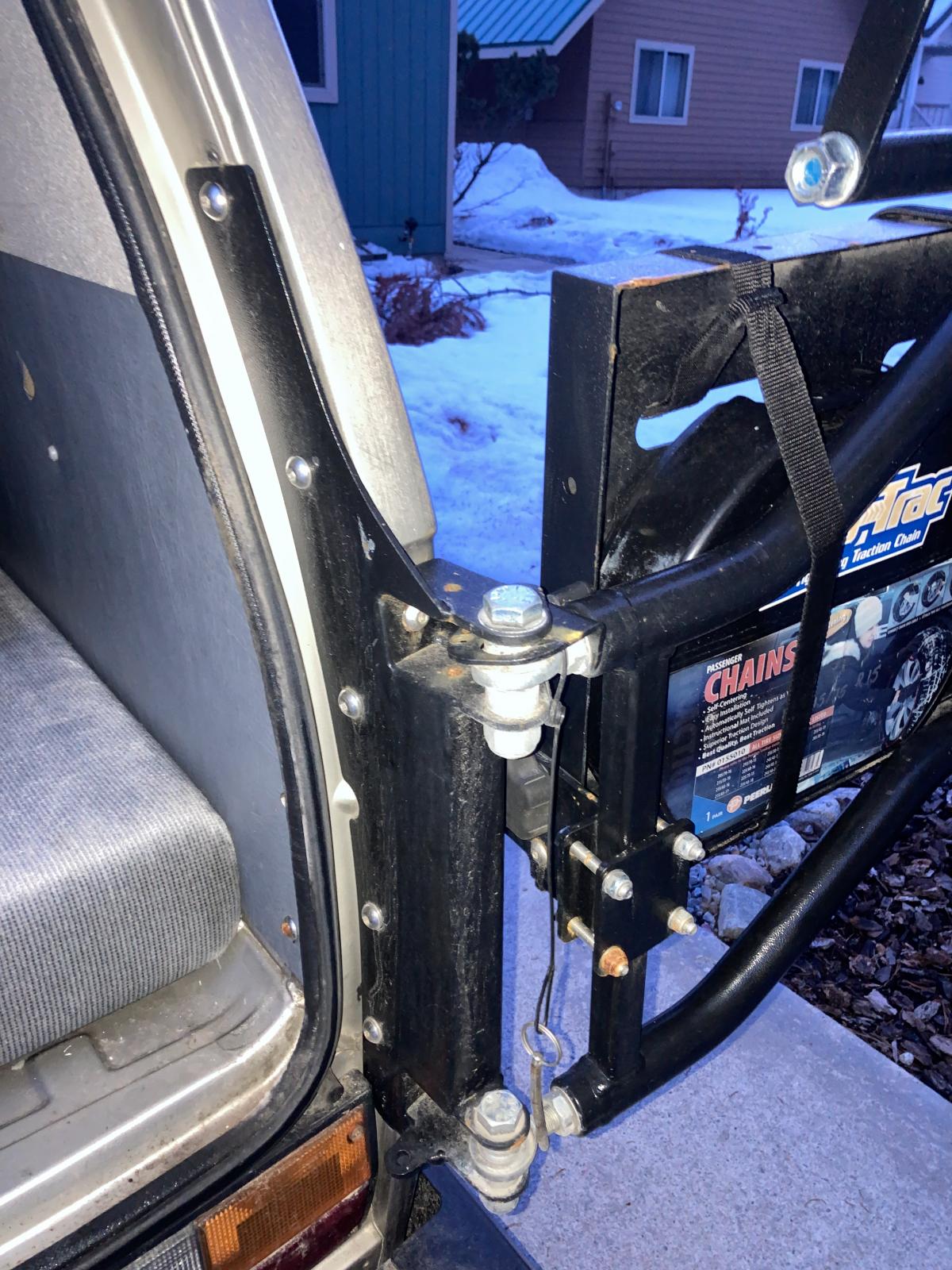

I am trying to replicate the Pathfinder install. Maybe I can get some advice. I note that many mount the Pathfinder carrier with the top bar just below the bottom edge of the hatch window and it ends up pointing down slightly. I find, with my smaller diameter spare tire (Cooper Discoverer 205/65R15C), that I could mount it lower down, with the latch mounted to the hatch lining up with the very bottom edge of the hatch, while still not blocking the view of the license plate with the spare. Since the body quarter panel slopes out at the top hinge and in at the bottom hinge, this helps to level the carrier (and lower the CG of the carrier and spare). The main problem is that the gap along the top edge of the upper hinge increases and there is not enough meat to the top hinge to grind it to make a snug fit to the body over its full footprint. So I need something to fill the gap, something firm enough to take a compression and shear load. Any ideas? Maybe JB Weld? I could mold it with non-stick paper separating it from the body to keep it removable.
Also I am thinking I will make the backing plates linked together with angle iron or something so the lower one is easier to hold in place 'til I get the hinge bolts started. I can make the backing plate assembly using the carrier itself as a jig, off the van. If the backing plates match the carrier and the carrier is a good match to the body, then the backing plates should fit nicely inside. Again, any thoughts?
I will also add a short cable to prevent the carrier from swinging too far and denting the body at the hinge mounts.
Later.....
I think I will try WB Weld's product called SteelStik to fill the gaps between the Pathfinder hinges and the Vanagon body. That is after grinding the hinges to minimize the gaps. I will use non-stick paper between the body and the hinges to allow the carrier to be removed. I will probably use some double sided tape (like shadetreetim as I recall) between the outside of the body and the hinges when I finally install the carrier, just to provide some stick and a little cushioning. Hopefully I can scrape the tape off if needs be.
I will let you know how it turns out.

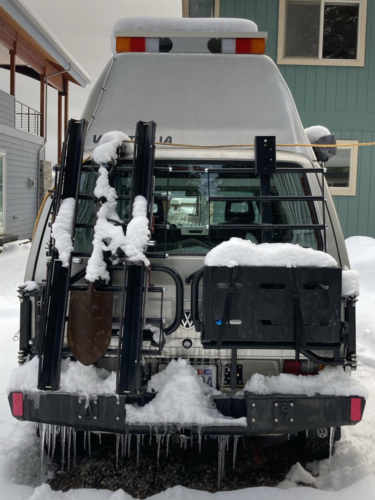

^^^ Three years of carrying way too much stuff (far mor than a spare tire) and the racks and body are holding up just fine. I just took these pics and don't see any problems...
Too much stuff but the racks make it so easy to haul, swing open and open the hatch, etc. Recommended...
For a year or two I considered trying to mount the GW swing outs on the Twin Peaks bumper but didn't see an easy path. Plus, after seeing the GW swing outs Ikm not crazy about the design, fit and finish. FWIW, YMMV.
- Jim
