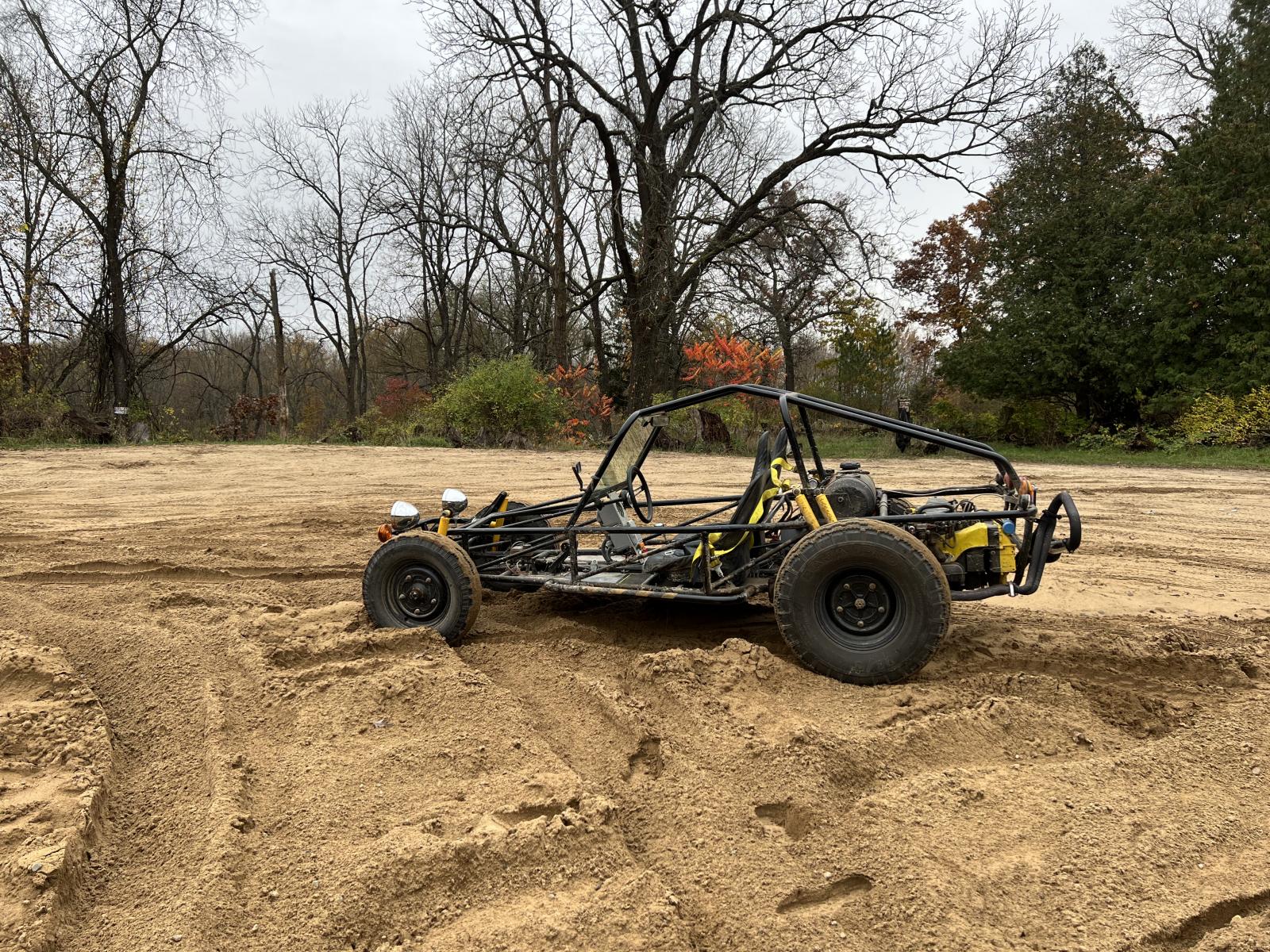

PostPosted: Sun Oct 29, 2023 2:48 pm    Post subject: Re: Project Slowly Underway: Berrien 295 Reply with quote
Last ride of the year. Pretty soaked by the time I got home. Poured cats and dogs about 10 minutes after the second picture. 20 minutes home in the pouring rain. What a way to end the year. Laughing Laughing
