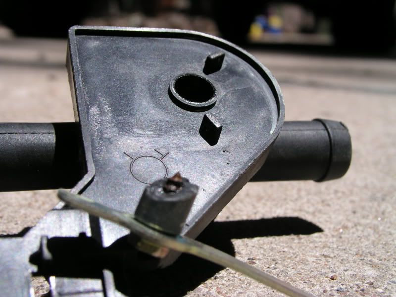

Once I get some time, I'll get some updated info and pics here, but here is the project I worked on today.
Fresh out of the box too.
A big thumbs up to Van-Cafe. I called them after this happened, and explained that I had bought the valve two months ago, just installed it, and this break happened.
They sent me a new valve that same day...awesome customer service!
...and two bags of cookies.

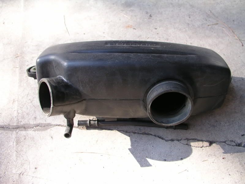

GrindGarage wrote:
Nice wire didn't know that they jacketed 4 wire like that.
What did you use for air intake tube?
I used the early ej22. Sad to say I have my airbox just resting back there, hasn't given me any problem close to 20,000 miles later but big plan is to move the snorkle to drivers side and modify the box to intake from the snorkle.
Well, since my EJ22 is from a 1997, I had a different style of intake and box:
I went with an older set-up, and since my time and access to subarus is limited, I bought mine from Korkwood:
http://www.thesamba.com/vw/classifieds/detail.php?id=567637
The box he supplies comes with an L shaped bracket to bolt to the engine bay for support. He also supplies an "S" pipe that puts the actual intake farther in to the light cavity where the snorkel would typically by.

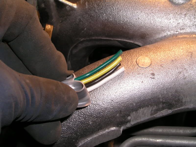

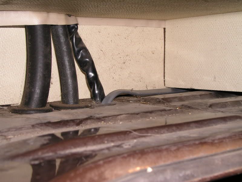

So after going back and forth between running the wires for the CEL and VSS on the exterior or interior of the van, I opted for the interior. I didn't want to run two separate wires all the way up front, so I started looking around for something that would work.
At first, I thought I would go with some trailer wiring, and then cut the ends off, but finding a long enough run was not happening. I found this stuff instead:
And this is what it looks like:
I'll have two wires left over to run anything else I need to, and should be just fine.
To route the wires, I came through the AC wire grommet, and ran the wire under the closet cabinet, and back behind the other cabinets, following existing wiring runs. I'll snake them under the carpet and up to the dash a bit later on.
