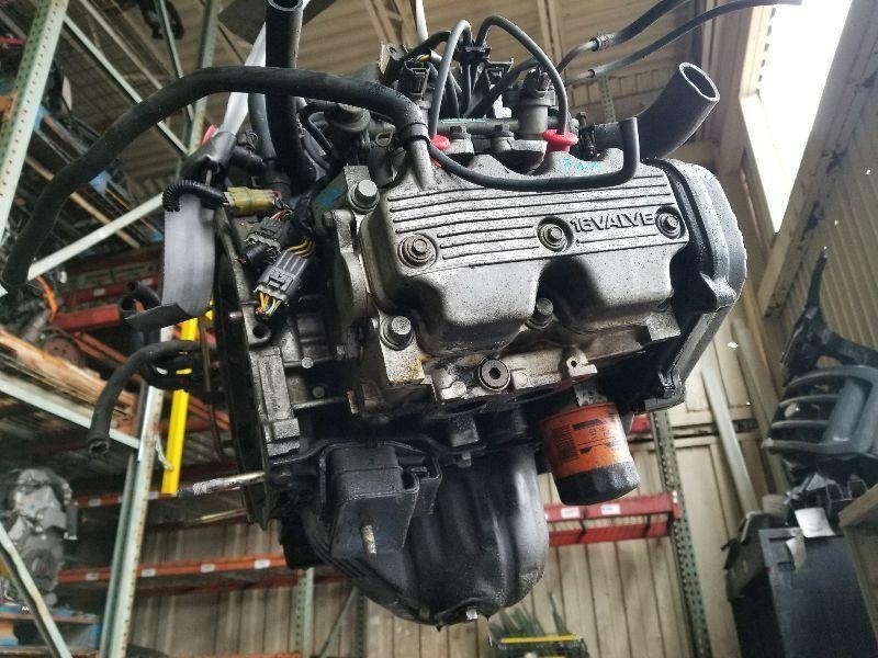

I am not sure that those plugs are a definitive way of telling that it's OBDII. They look very similar to the two grey plugs on my '93 OBDI EJ22.
tjet wrote:
Here's a couple of pics of my '95 EJ22 before I tear it down. Note connectors in rear, which help identity it as a '95 with an OBD II. I've read that the '90-'94 OBD I EJ22 engines do not have this connection point. This may be helpful if you need to I.D. a removed engine.

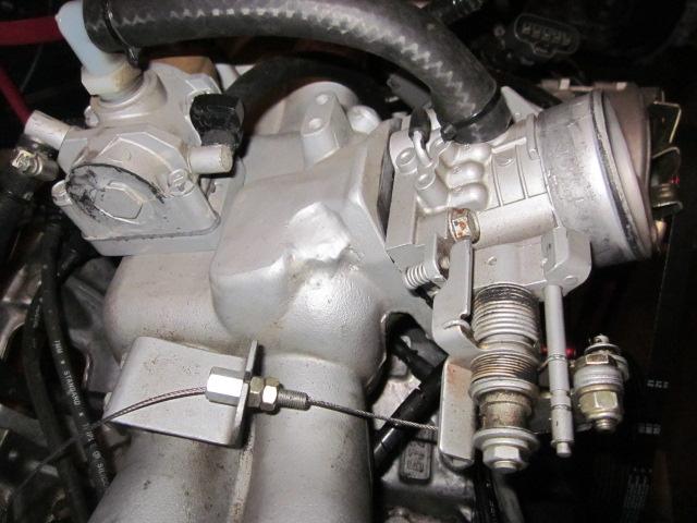

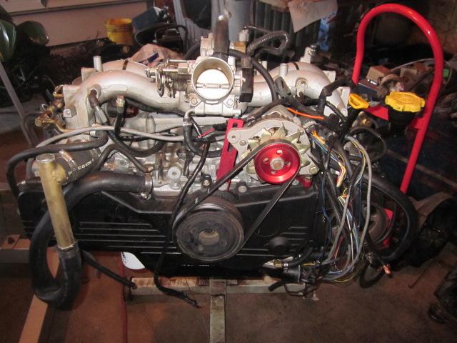

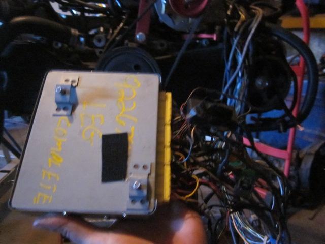

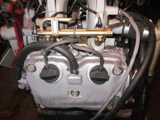

I found some details on the head gaskets needed for a Frankenmotor. Cometic makes a special "hybrid" gasket for putting 90-95 EJ22 heads on a 2.5 block.
p/n: H1631SPK051S
I plan on using an EJ257 STi block.
https://www.amazon.com/Cometic-Gasket-H1631SPK051S-Subaru-Hybrid/dp/B01BT7NUYU

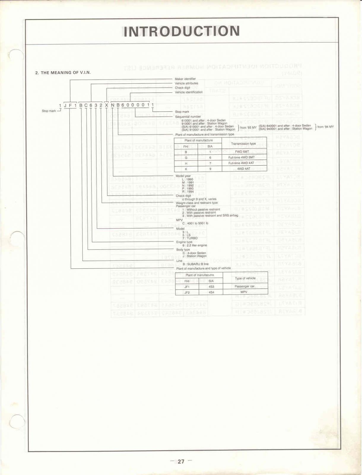

VIN decode for 90-94 EJ22 junkyard hunting.

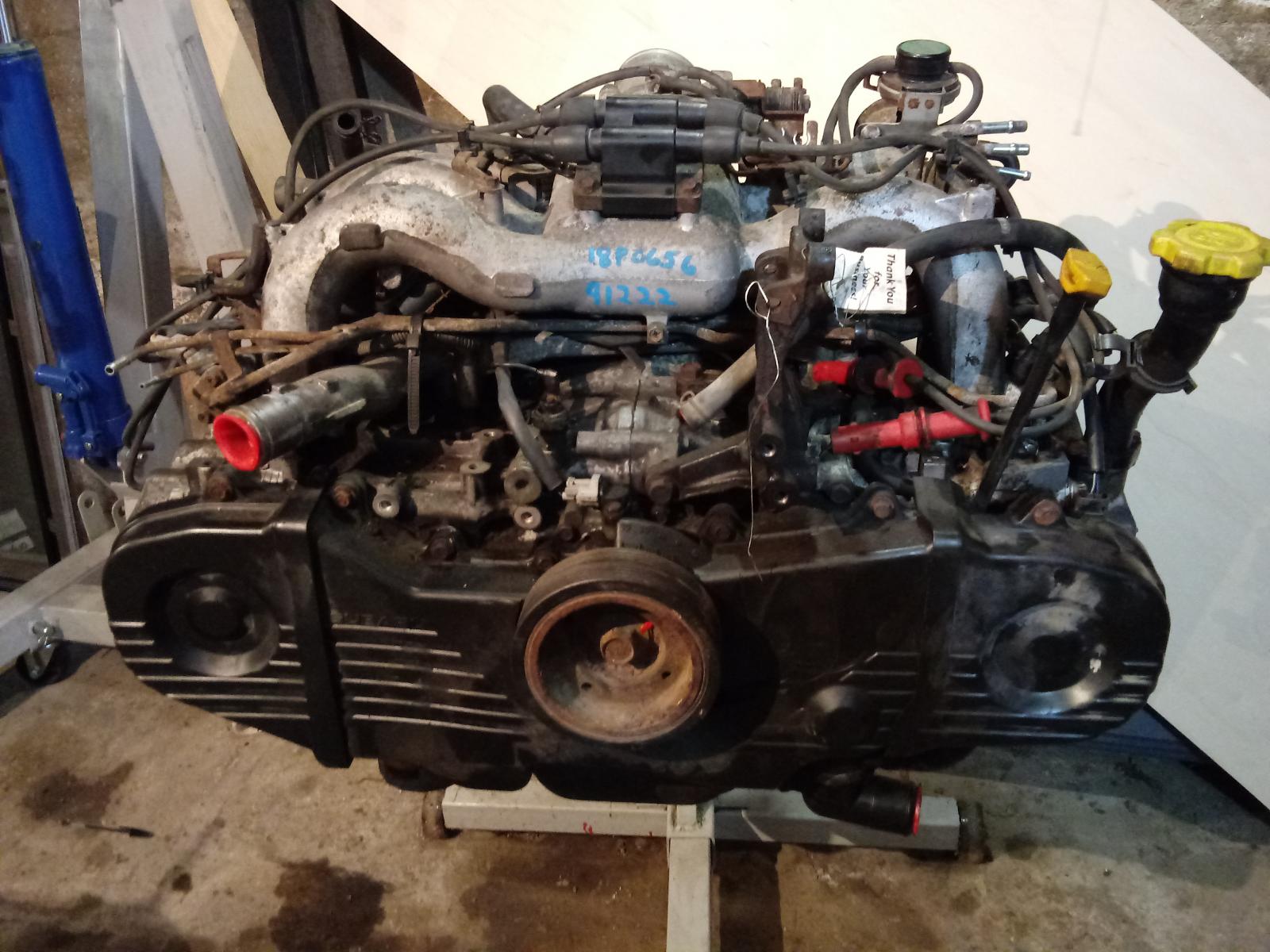

I just bought a '95 EJ22 (see below) & I have a couple of questions. I plan on getting a newer 2,5L block & use the EJ22 heads, intake & assys. I see that some of the builds use a EJ25D block. Will a EJ257 block work?
Also, on this EJ22, how big is it, say compared to a WBX? I need to go pick it up and put it in the trunk of my Jetta. I've transported a WBX in the trunk before. Looking at the pic, it looks like I will need to pull the pan and oil filter off.
Finally, just to confirm, do these "Frankenmotors" retain the non-interference feature of the '90-'96 SOHC EJ22? I will do the rebuild myself. I can get the new pistons relieved if necessary.
Thanks

^^Just a straight SOHC EJ25, not a franken.
IMO - franken-motors are best for CA residents and people that already have 2.2l setups
BTW - my DOHC motor is a Ken Welter build too (ARP studs, Sti oil pump, etc...) His engines are bad ass! Dancing
