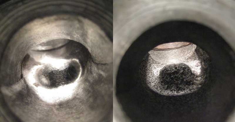

finished the porting work after removing the valve guides...
intake:
exhaust:
Now time for the guides to go in... Rolling Eyes

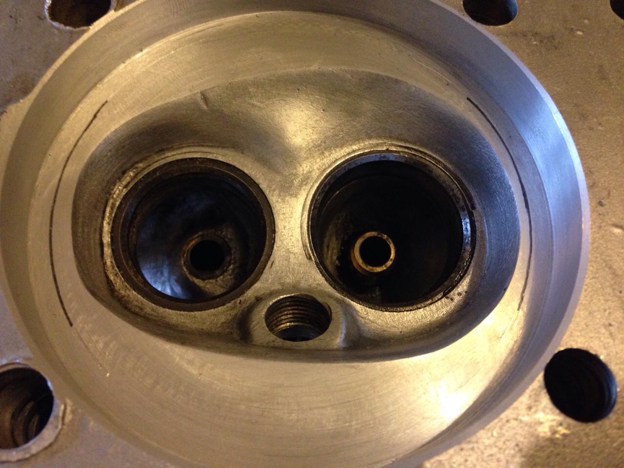

marked the inner cylinder walls on the heads
then draw the area to unshroud
it took me one hour per chamber... tough work!
and the final result, note that I am very conservative...
BTW on the exhaust side of the right chamber, not the small scratch from the dremel tool. There's half of the sealing surface intact, the other half is scratched, not too deep, noticeable, though.
My plan was so just put some fine lapping compound on the cylinder sealing surface and rub a little bit the cylinder against the head, just to smooth it a little bit. I was planning to do that on all 4 cylinders, not just on the scratched one.
What do you think?
Thanks!
