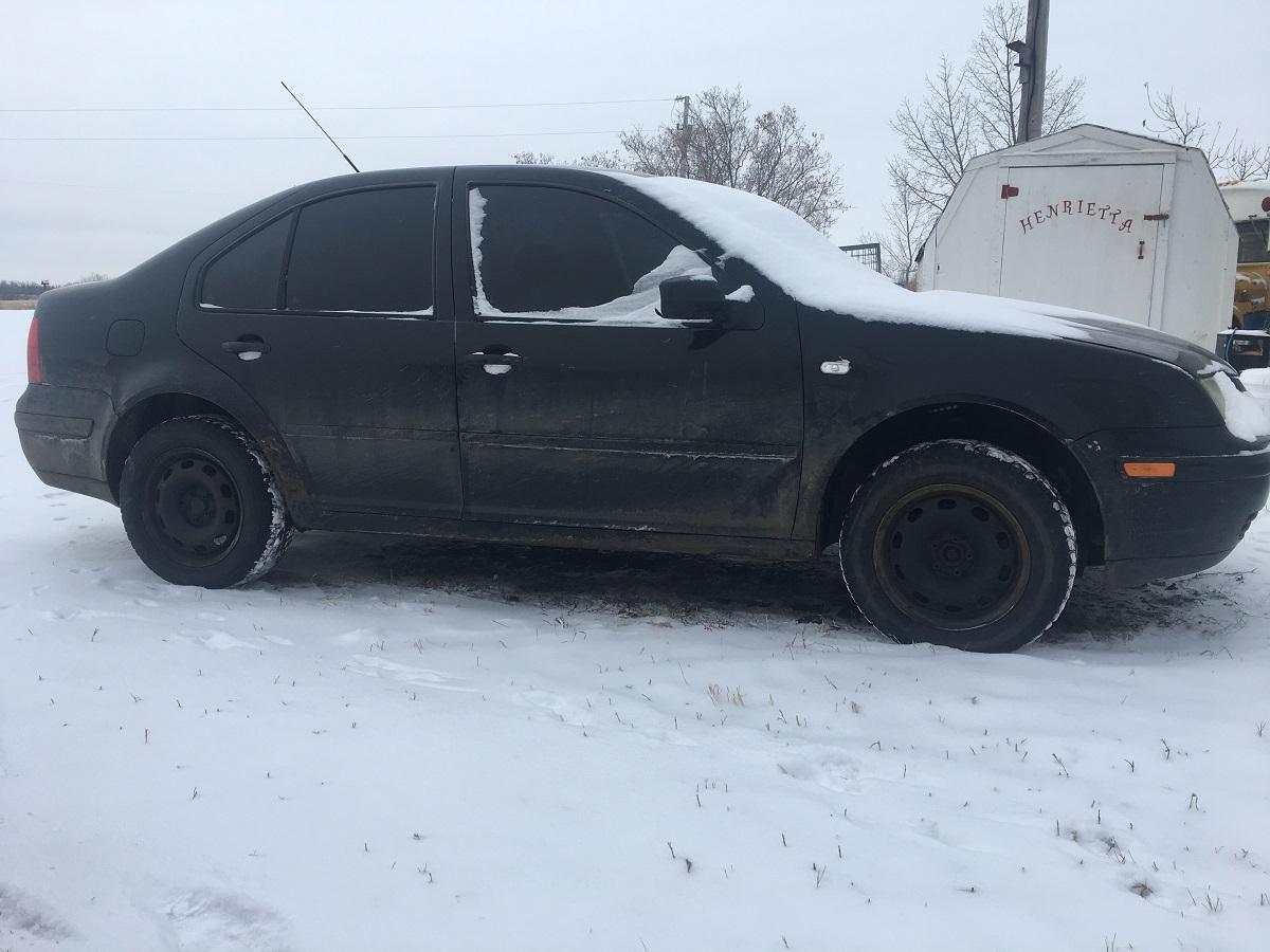

Just finished a 1.5" lift on my son's Gulf. Maybe a touch too much but no more knocking manhole covers off driving down the street! Won't hurt for plowing snow through the mountain passes either.

PostPosted: Wed Dec 25, 2019 4:58 pm    Post subject: Re: Jetta lift kit? Reply with quote
I built some 1.5" spacers for the front and installed them. Happy with the results as the car sits almost level now, just a touch tail high. I can't believe how much it stiffened up the ride! Not unbearable by any means but definitely not the stock ride.

PostPosted: Sat Nov 23, 2019 5:58 am    Post subject: Re: Jetta lift kit? Reply with quote
Interesting! I just swapped in Jetta wagon trailer towing package rear springs which took care of a broken rear spring on our '02 Jetta. Gained a good 2" I would guess. Now looking to get the front up out of the dirt. It seems the front springs are the same wagon/sedan but they are going in anyway. Looking at building 1.5" spacers to go under the front struts, slip onto the bottom of the shock and slide into the spindle.
Thoughts?
