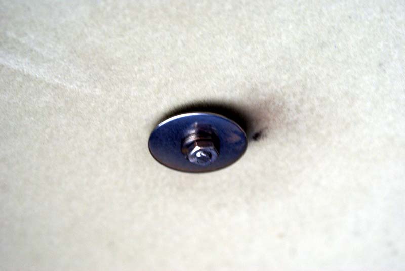

madspaniard wrote:
Thanks Tim,
forgot to mention whether you had a pic of how things look inside the poptop, where is the head of the bolt? inside or outside?
thanks again for inspiring me to get this done
I was going to post pics of that very thing and I couldn't find them? I knew that I took photos of
the inside as well as the outside of the bracket.
Here's the bracket from the top of the roof. I used a Stainless allen bolt with washer through the
bracket and into the compression nut.
On the inside of the roof where the allen bolt comes through, there is alot of bolt to cut off to bring
flush to the compression nut. What I did was to add a Fender washer, lock washer and another
nut. Then I cut off the remaining bolt threads and filed down any sharp edges. I wanted alittle
added security to the panels' bolts, by double nutting them as well as a BFW that would have a
hard time going through the roof.
Hope this helps!
Tim
