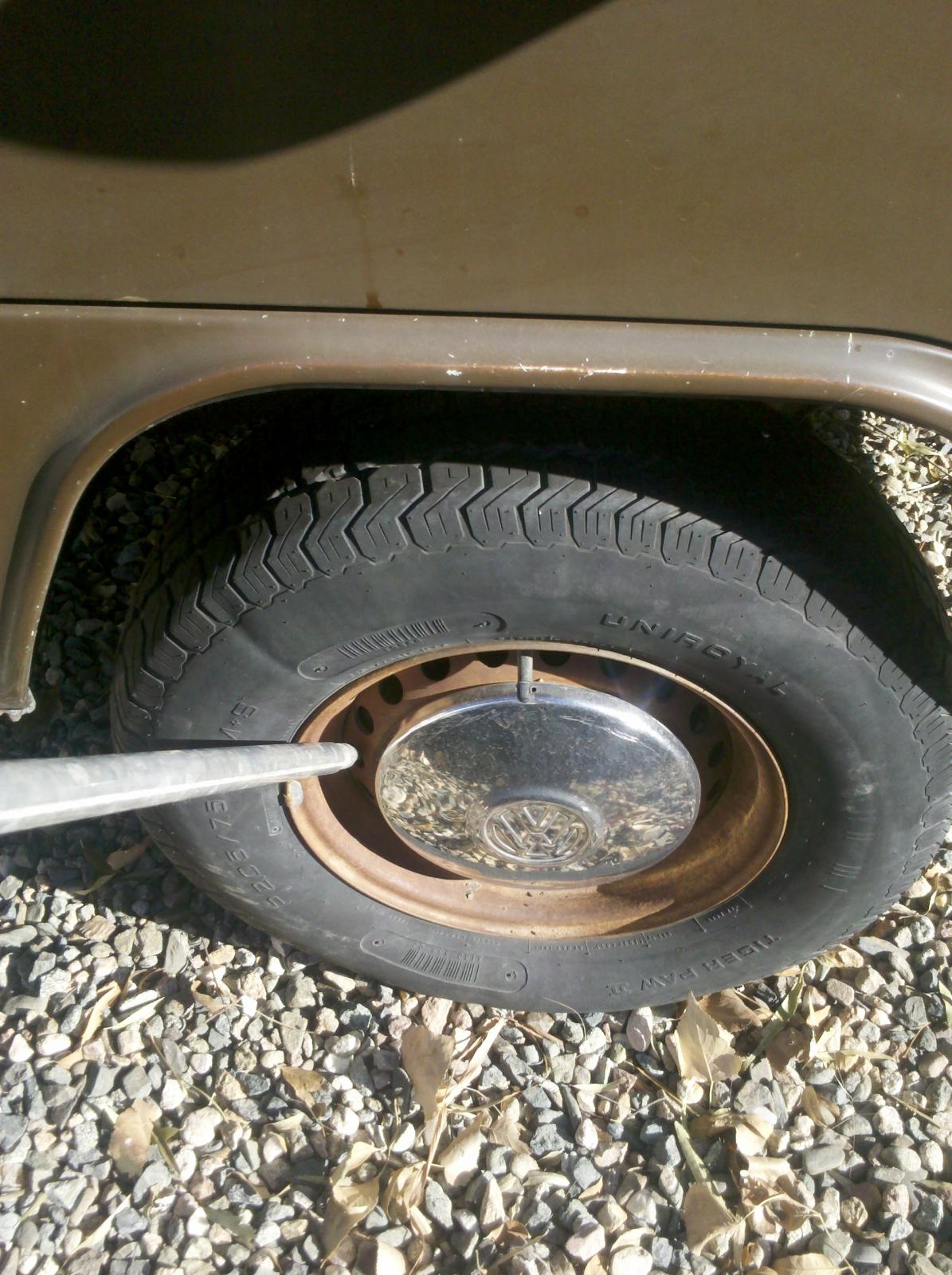

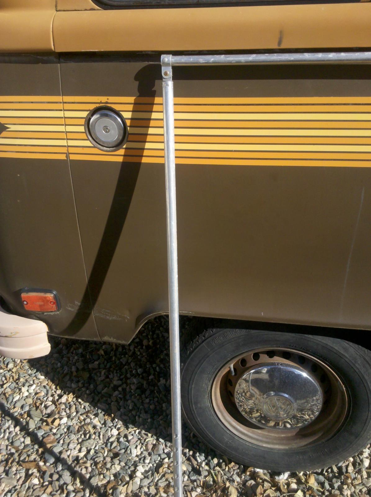

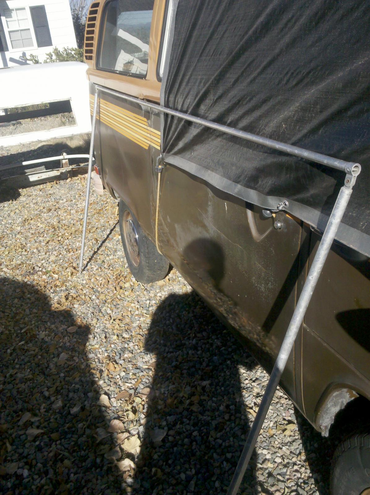

I'm not sure it is the rule to stick them into a wheel like that, but dude I got it from said it does. He most likely is following the pic in the brochure, but I bet sticking it into the ground is an option. Very Happy

^^^ Interesting. I guess early bay drivers need not apply. I don't see those poles fitting wide five 14" wheels.

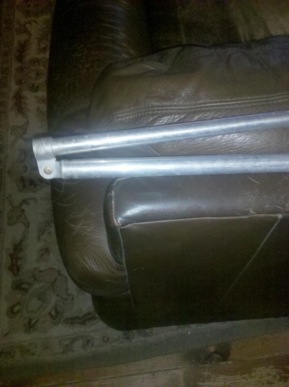

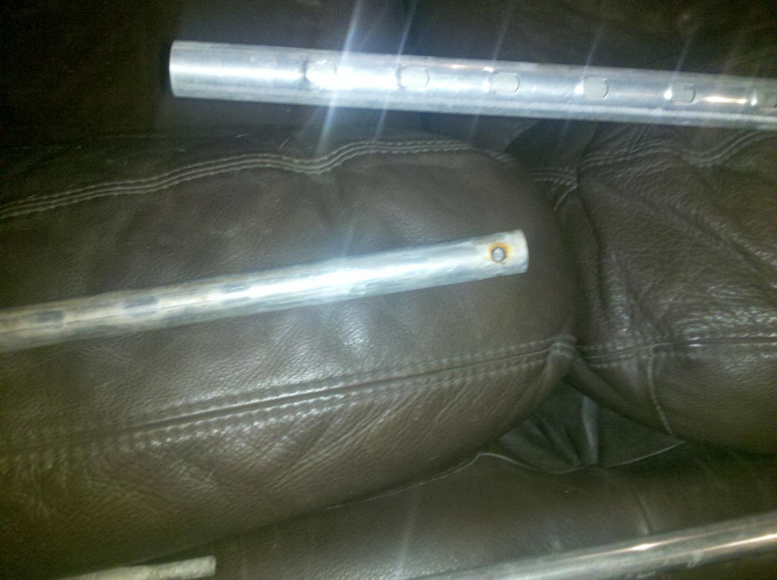

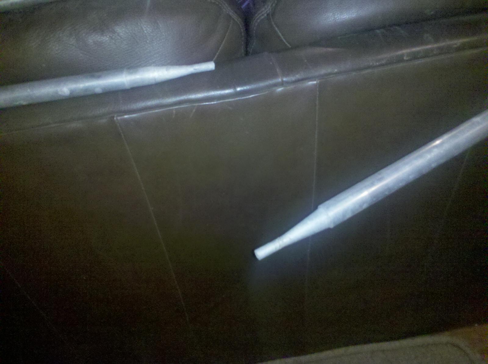

Ok I braved the freezing weather and took these pics today.

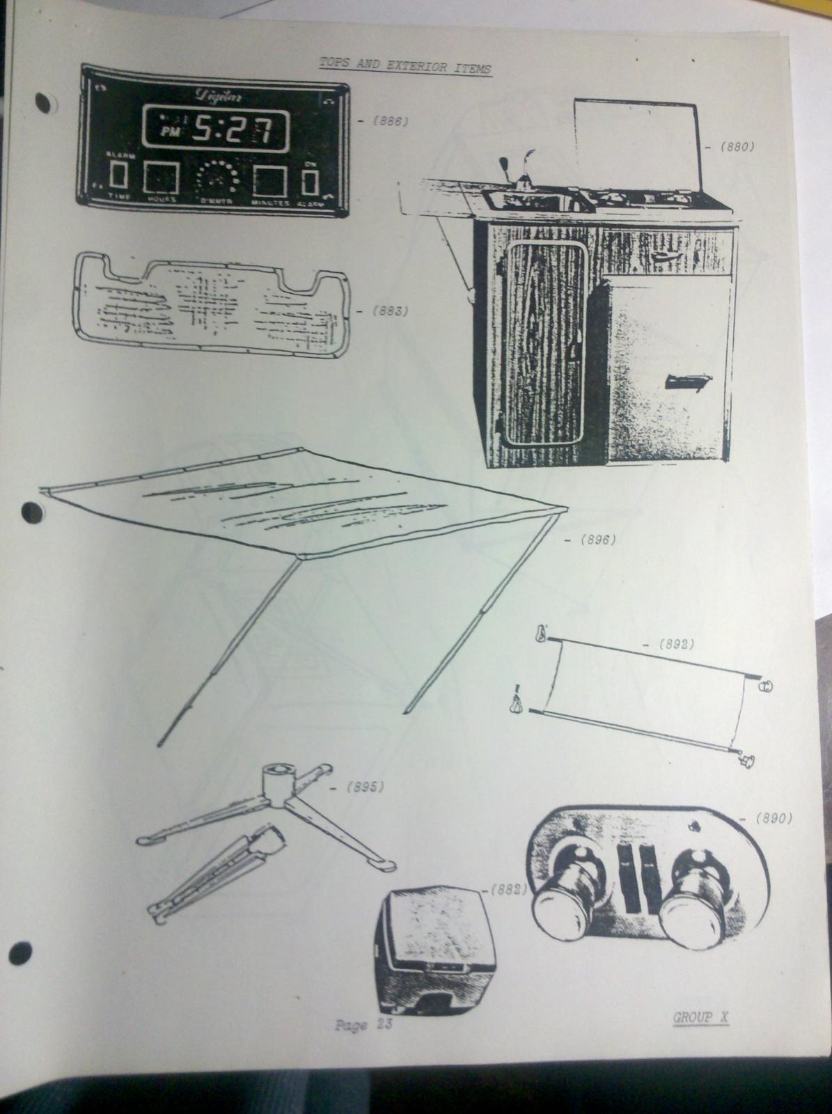

In that brochure is a pic of the awning. I have never seen one before, but now I want one. It says that it is concealed by the pop top when not in use. That would be perfect. I need to figure out how to make one now.
I found one today. I was at a friends house and saw the neighbor and asked him if the Corvair behind him was his. He said "what Corvair"? So I said the car right behind you. And he said "it isn't a Corvair it is a VW." Confused So I walk over and the car I thought was a Corvair turns out to be a 64 type 34 Ghia! So after talking to the guy for a while I asked him if he had any other vw stuff and it turns out he had a Riviera bus that burned up in a fire. He found the awning poles and showed me that they are supposed to be pinned into the wheels of the bus like in the brochure pic. The poles set is in great shape and I hope to use it after making a canopy for it. Cool

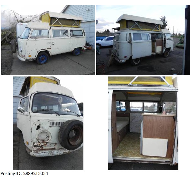

Could you possibly post a pic of the awning rolled up and secured with the top still popped? I'd like to see the method of securing it in place.
This ad for a 70 Riv shows this awning track, but not the awning. Can anyone bring the photos to the samba gallery for posterity? I'm not sure how to do that.
http://seattle.craigslist.org/tac/cto/2889215054.html

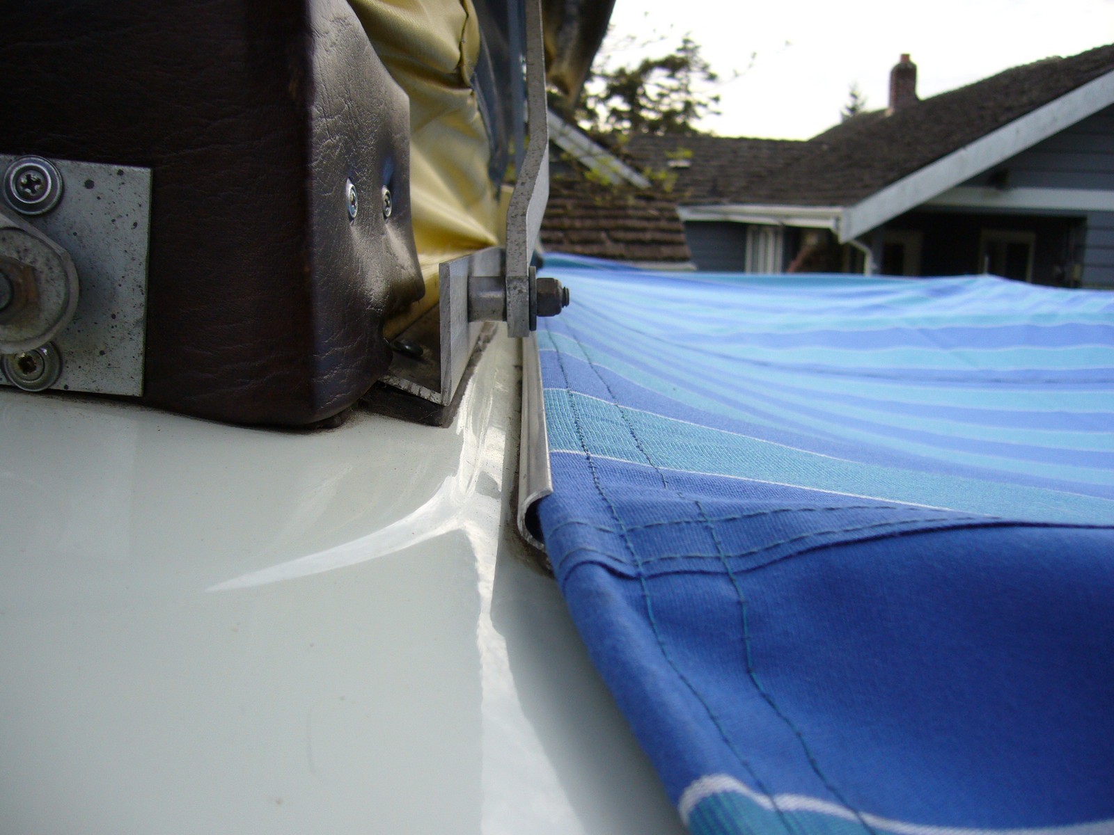

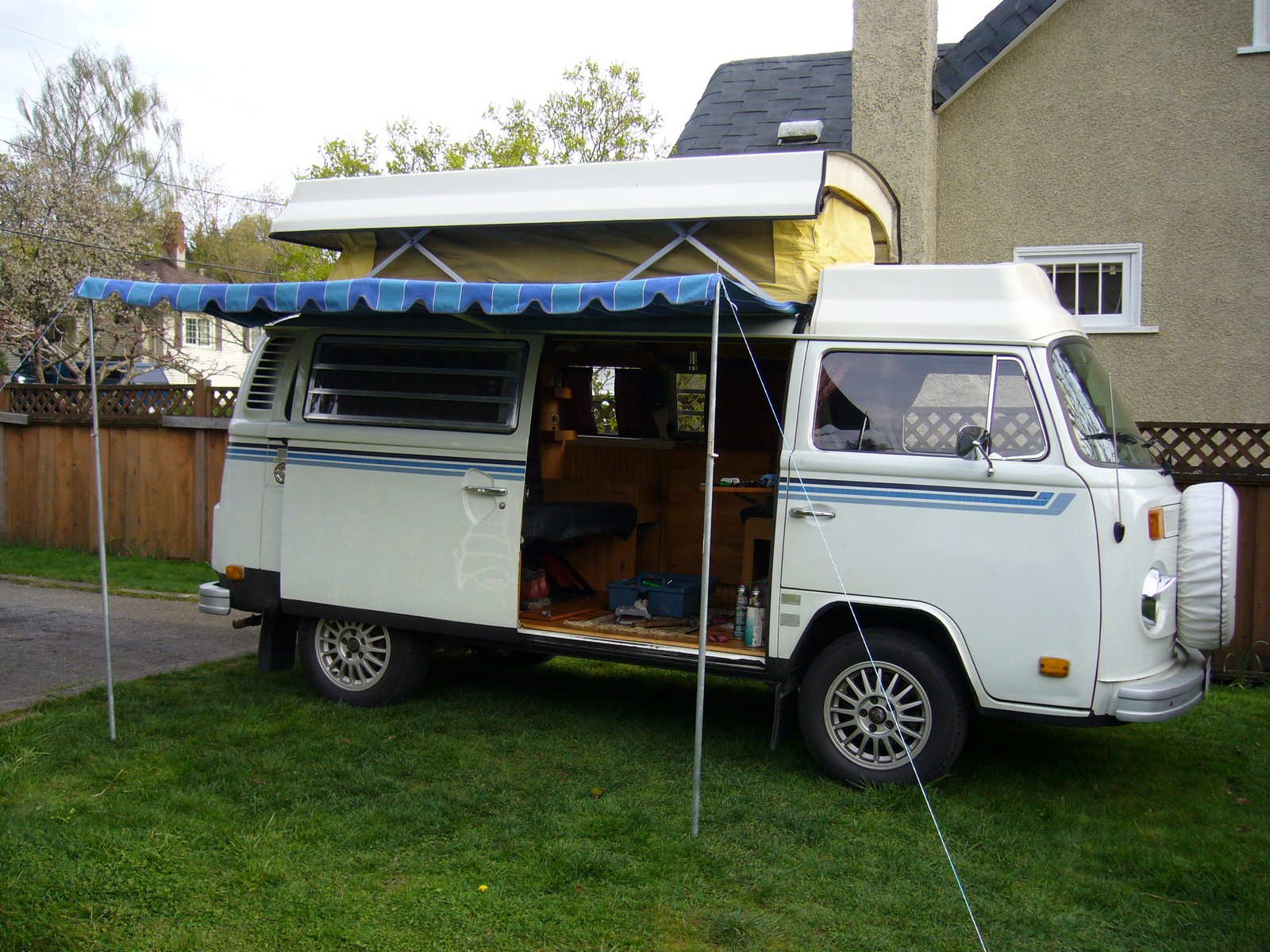

Mine came with the original canopy. The material was a thin blue nylon. I don't have any photos of the original setup.
The only photo I have on here is with the "shortly" replacement fabric, ie full length, half width.
The attachment system is a common one, I call it a rope-guide style. Most awning / upholstery places should be able to help. A couple of places around here still sell the materials.
A rope is sewn into one side of the fabric, which then feeds into a track attached to the bus. Roll up the awning, secure with a couple of Velcro straps and tuck under the pop top. The velcro straps are secured under the track, so it keeps the awning snug to the track.
Originally, aluminum fold out arms are attached through an aluminum tube and that also rolled up with the fabric under the top.
I opted to replace the pole setup with two height adjustable ones, minus the attaching pole. Allows for angle adjustment for wind, rain, sun etc.
I have 3 awnings in total, this one, a 9 x 9 stand alone style dining canopy and a Norseman Apollo. This setup is fairly nice. Less material and doesn't stick out when not in use like the all aluminum Norseman and about equal to the 9 x 9 stand alone, and this one is firmly secured to the bus.
