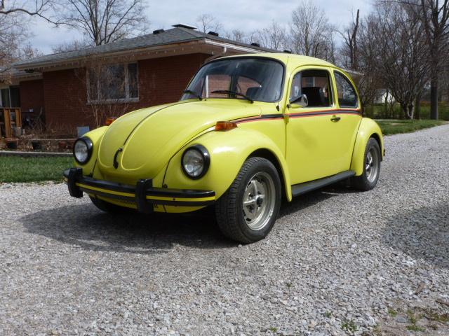

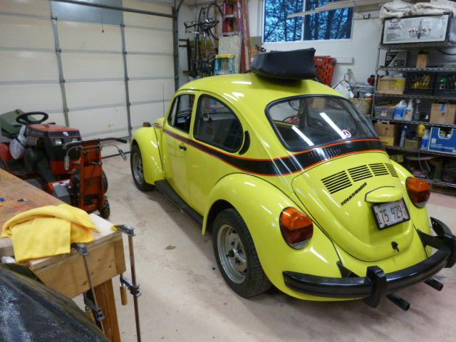

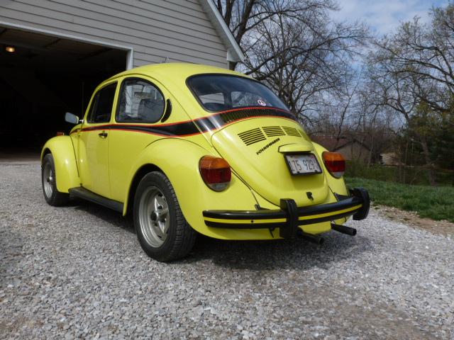

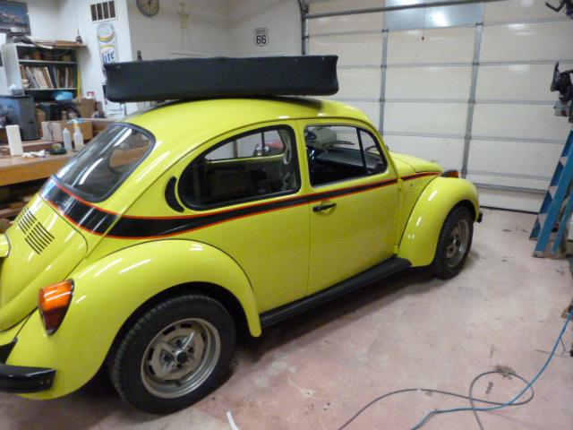

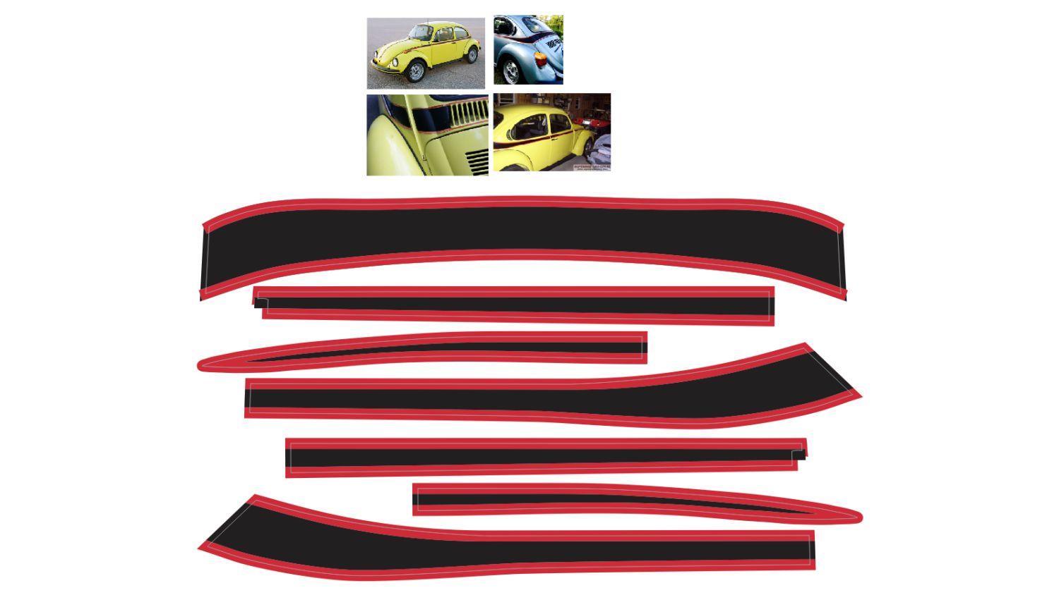

pics of the stripe:
got the stripe from BeaverStripes of AZ. if anyone is interested, contact them via their website - email address, they can quote you a price and shipping.
here is the process and some pics of the job.
first off I replaced the upper Hinge Pin on the Drivers Door cause it had a little bit of play in it and it was bothering me. I had soaked it with bust rust for a long time before trying to remove it.
I also removed the Drivers mirror to get it out of the way.
The stripe kit from Beaverstripes comes Rolled up so unroll it and let it settle out flat for a few days before you start the process. it would help if it was warm in your garage or workspace.

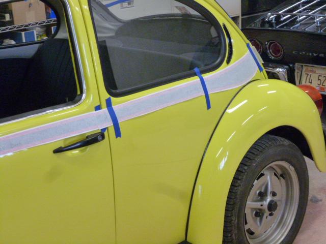

1. remove all of the Trim on the car, and Remove the Plastic clips that hold the Trim on, order a New package of Plastic Trim Clips.
2. Clean the surface really well. I used a standard Wax & Grease Remover that body shops use. same stuff I used when I painted the car. it is a high quality Isopropyl Alcohol.
3. use Masking tape to Lay the Stripe out on the car so you can see how much you need to trim and mock up your layout . I also put small pencil marks on the body where the paper meets the body so I had a reference line to lay the stripe to. measure the Front Ends of arrow to make sure they match on both sides of car leaving the Black trim to run within the Black part of the stripe.
the instructions state that the Stripe is an Air Release stripe - meaning the it cannot be installed with soapy water, stripe experts might disagree with this but I'm no expert so I followed the directions as told.
the stripe kit comes in 7 pieces and included an extra red stripe for the back vent portion to be used if needed.
we worked the Rear Vent first, then worked from Rear to Front working each section at a time - rear quarter, door , then front quarter.
4. instructions state to start from the middle of the stripe and cut off the backing paper working from the Center of the taped portion out to the Right using the squeegee to work out the bubbles. then work the process back from Center to the Left. After getting the section of stripe on then Remove the Top Paper from the stripe to reveal the finished stripe.
the hardest part of this process was getting the bubbles out of the centerline seam that runs down the side. I still have a few bubbles on the seam but I am hoping that when it finally gets warmed up around here it will lay out.
As for the Rear vent, I actually cut out each vent portion and folded the vinyl onto each of the 42 vent rails on each side, I was expecting to use the Aluminum vent cover to go over the stripe anyway, however I could probably get away with just the vinyl stripe in that space.
5. install your new trim clips, you might have to use a small drill bit to make sure the body holes are clean so they will hold the clip. use a small punch to drive the pin into the clip which holds it tight to body, and pop your trim back in place. it is pretty tricky around the Flat superbeetle trim piece that goes on each front quarter panel ( covering the body weld section). that panel can be a pain, but you can make it work Smile
I also picked up some vinyl 3/4" yellow for the Bumpers shown in the photo's. I removed the bumpers to put the vinyl on in one piece.

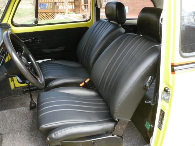

I also added the headrests back on to the seats as shown below. I do kind of like the headrests on and am pretty happy with the results.
thanks to steve at beaverstripes for setting me up and thanks to the other Samba member whom took the old stripe to them to create the copy.

Stripe Kit.
I just received a Stripe kit from beaverstripes in Phoenix and wanted to share with fellow sports bug fans whom might be looking for the same.
this kit looks pretty good, steve of beaverstripes made a copy from an original vw kit ( that a fellow samba member brought in to him).
I will be putting the stripes on and will update this thread with progress.

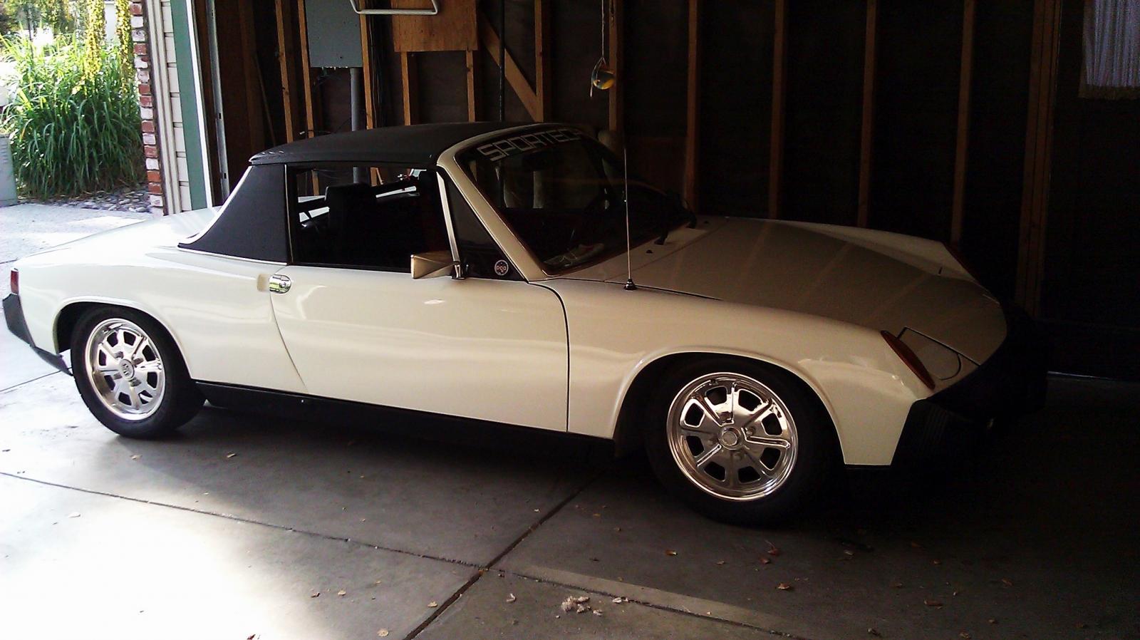

This is the one I did a few years ago....
Killer in sheep's clothing
Doc

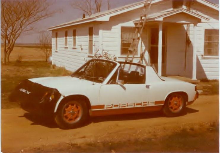

when I got that creamsicle back in '77 it only had 37,000 miles on it ! it was sweet! amazing what they are worth today!.. but the 911 targa I traded it for would be worth a big chunk today also.. so I guess that's the way the ball bounces.
914's are fun cars!. yours looks very nice!

docdanracy
Joined: June 26, 2012
Posts: 1119
Location: Auburn, CA
docdanracy is offline
PostPosted: Tue Dec 18, 2012 7:51 pm    Post subject: Reply with quote

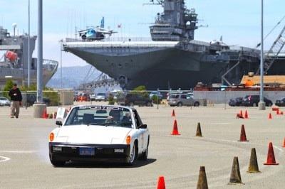

I've had 5 914s
That old creamsicle would be worth a ton of money now!
Last was a '75 2.0L that I totally restored.
Doc

docdanracy wrote:
Seats came out great! Applause Applause Applause
thanks!..
still undecided about the Headrests - on or off
I'm getting bored since I've just about completed this car.. after working on it just about daily for the last 8 months.
