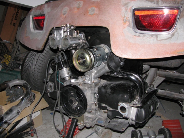

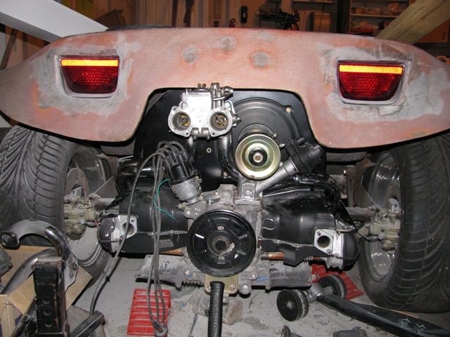

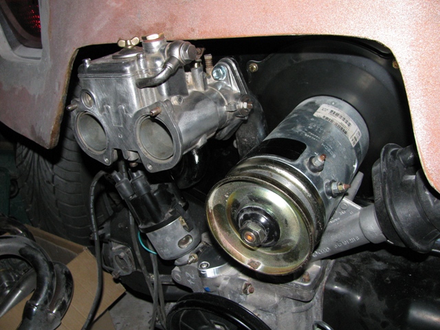

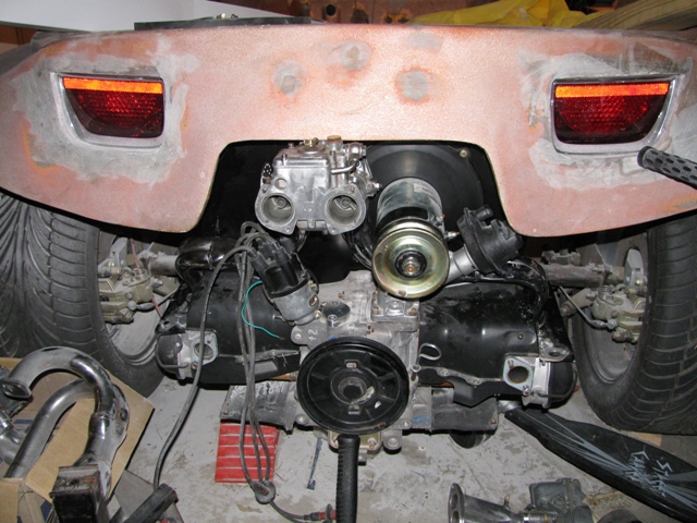

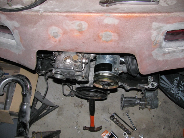

PostPosted: Wed May 23, 2012 5:12 am    Post subject: Reply with quote
Well I just installed the center mount set up. Still need to get some stackes and rebuild it. I am just not sure who to send it too.here are some pics.

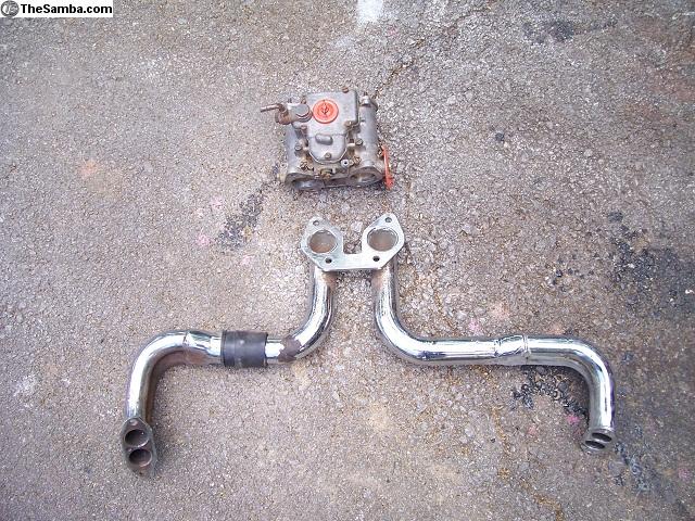

Looks like the manifold and carb bolt together. I have a car craft manifold that runs oil through it and it bolts to the carb and it's welded to the turbo or you have to run a hose and clamp to connect to the turbo. This manifold is designed for the carb to bolt directly to it. You could build a spacer of some sort and run oil beneath it to warm it.

PostPosted: Thu May 17, 2012 10:04 am    Post subject: Reply with quote
Idea The manifold is facing outwards for the sidedraft but still needs the piece for the oil cooling to the Turbo connection.
Three pieces....Carb....center section for the oil to go thru...Turbo itself.
Center section needs hot oil or will ice up and sweat.

PostPosted: Thu May 17, 2012 4:47 am    Post subject: Reply with quote
why do you say it is facing the wrong way, now I am confused. OH SH#* I hope this will work.

PostPosted: Wed May 16, 2012 9:05 pm    Post subject: Reply with quote
May have to fit a 911 shroud

PostPosted: Wed May 16, 2012 7:26 pm    Post subject: Reply with quote
Wow, you're right, the manifold was welded the wrong way! The carb will interfere with the fan shroud. Shocked

PostPosted: Wed May 16, 2012 5:12 pm    Post subject: Reply with quote
Look at that manifold again.

PostPosted: Wed May 16, 2012 3:28 pm    Post subject: Reply with quote
Idea Stupid question here.
How does a person run a 40 DCOE SIDE DRAFT carb on a vertical intake manifold?....suppose a weld job could solve that issue.
I have the same carb on my 1776cc Turbo engine thats over 20 ys running.
