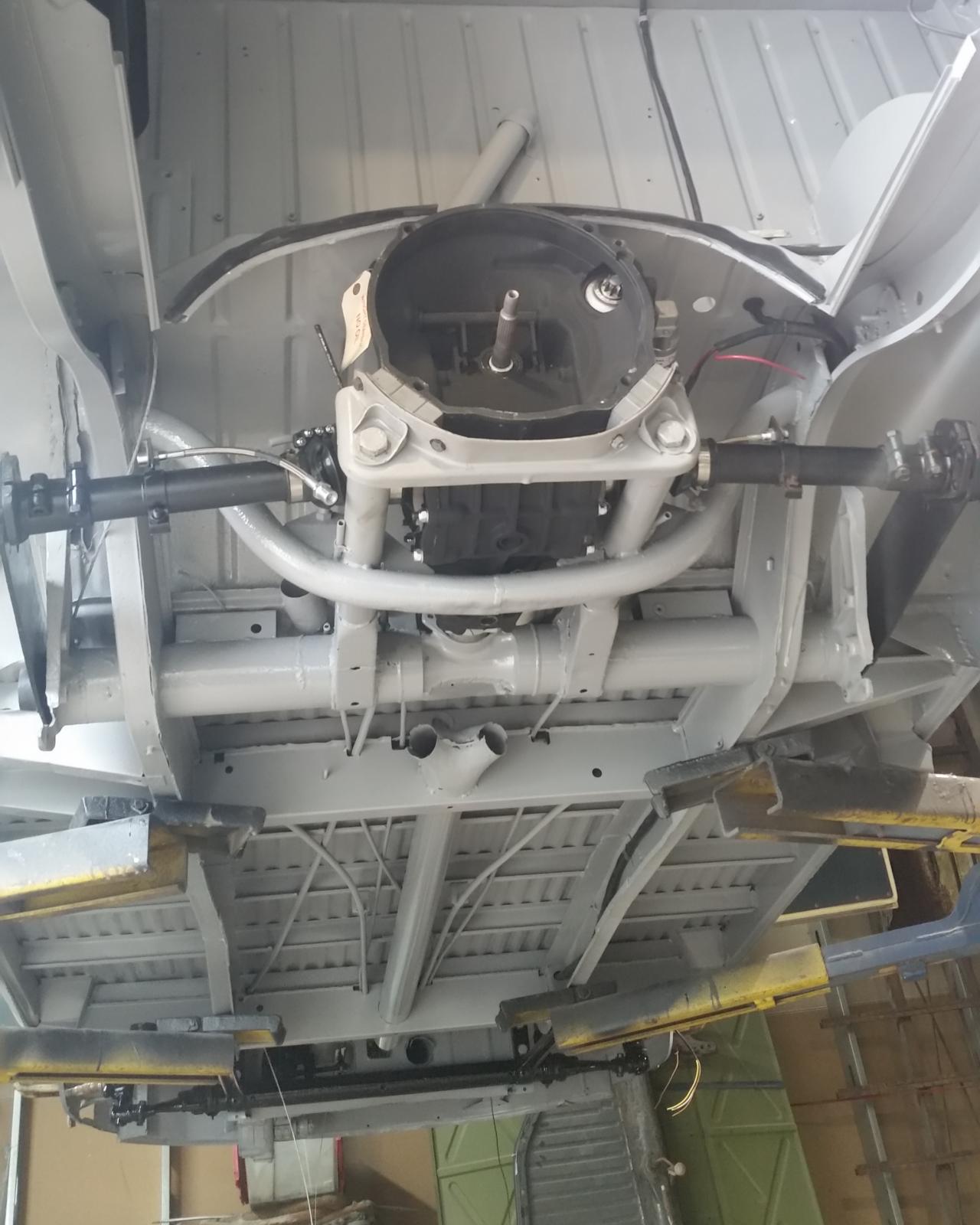

I see that the seam of the axle boots are put straight upwards at 12 hrs... In the manual it is written to put the seam at 9 or 3 hrs. WHY?
Hi Peter,
as the axle travels up and down the seam has to be at 3 or 9 o`clock. Otherwise the seam is pushed or strechted which can suffer it.
But there are many out there who drive around with 12 o`clock position without big problems...
Greetz, Felix

I see that the seam of the axle boots are put straight upwards at 12 hrs... In the manual it is written to put the seam at 9 or 3 hrs. WHY? it is much easier to bend the seam as to press it in and stretch it when the axle moves only up and down... THe oil will not leak as that tube is not full of oil. Just to inform you.

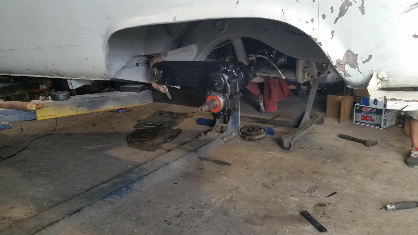

Greg,
Your biggest gripe is hurst bumpers?
It's what the owner wants to do so we oblige.

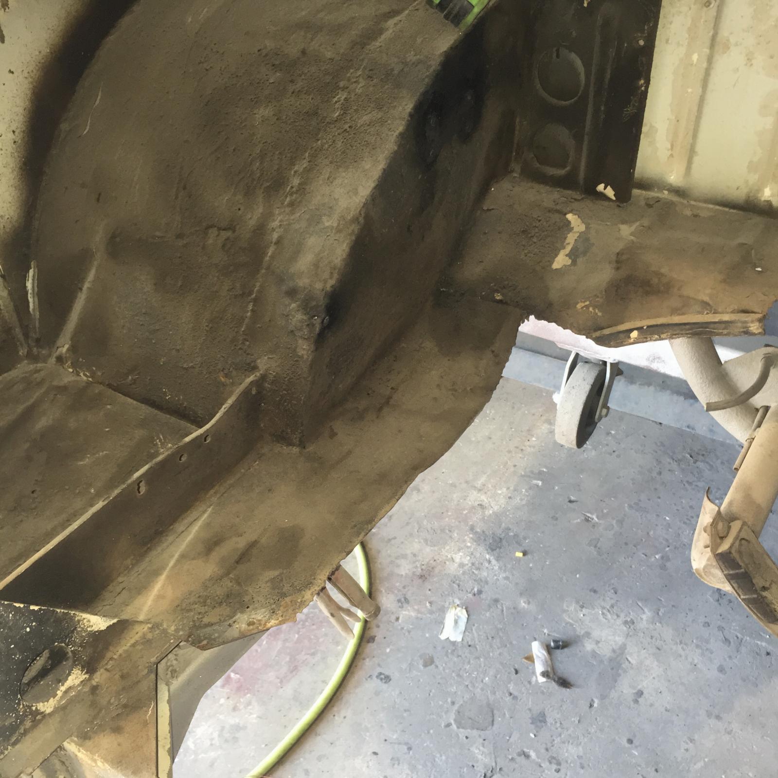

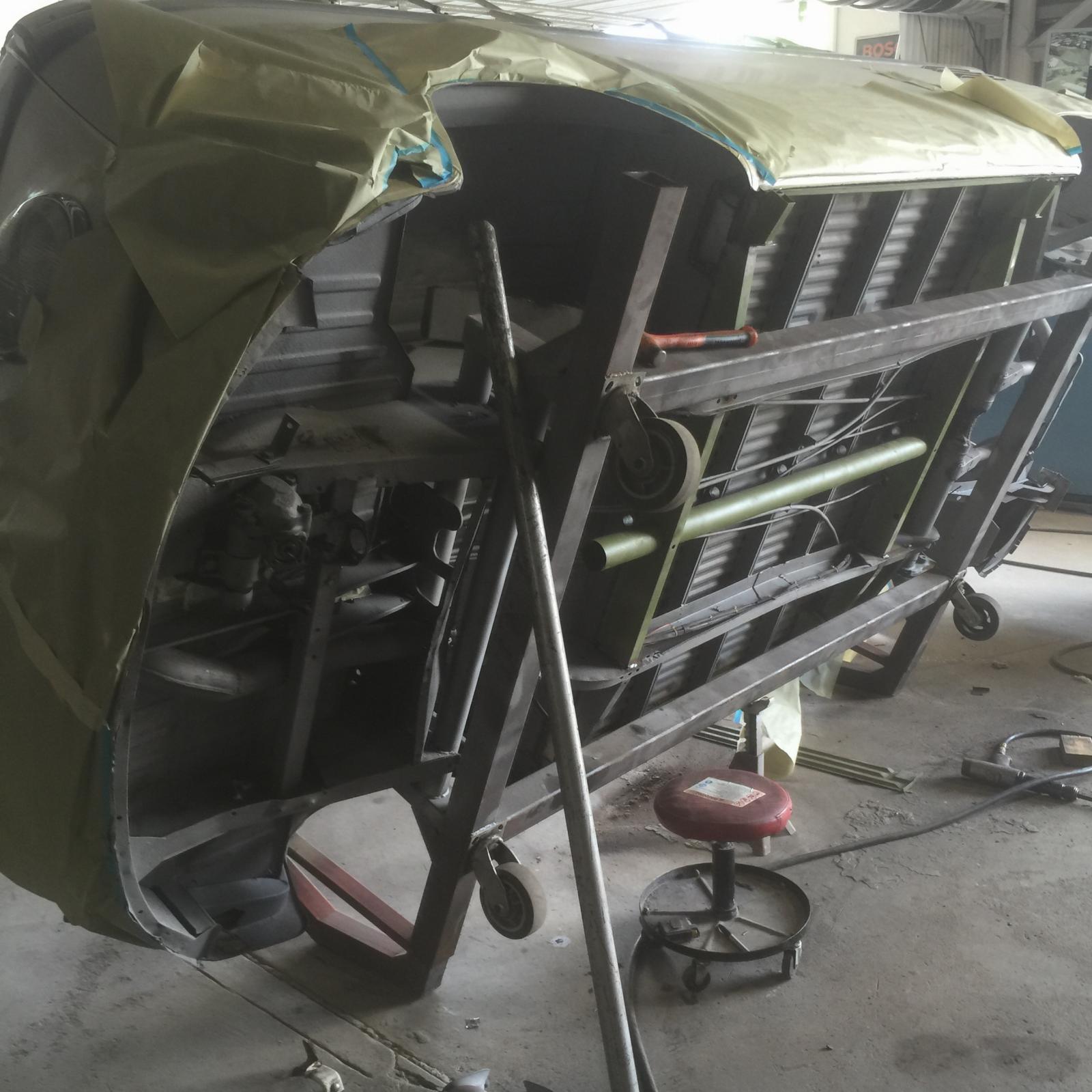

He wanted the underside reserved as well as the engine bay while preserving the exterior in its current condition.
We also restored the Barndoor reduction boxes and the front beam. It will have the 356 drums on it. And Barndoor drums in the rear. And a super 90 356 motor. And the reproduction 16"356 rims from Concept1.
Here are some more pictures of what we did all while preserving the exterior to keep it in its hayday of the Brooks Stevens Excalibur sports car theme.
Btw the owner will be using this bus as a driver and not a show piece.
So I would disagree that it is being "ruined" as would many others
Jason Stratton 407 497 9944
Stratton Motorsports, Winter Park, Florida
follow me on instagram "Strattonmotorsports"

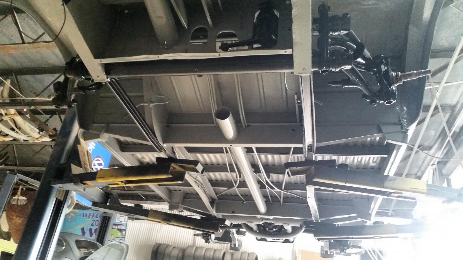

Thanks Jason vw, this is my favorite photo to understand the Barndoor bus chassis, keep up the good work. Back to Bus School.

Jason vw
Joined: February 18, 2004
Posts: 194
Location: WinterPark Fla
Jason vw is offline
PostPosted: Thu May 12, 2016 7:18 am    Post subject: Re: 1954 Brooks Stevens Campingbox Westy Reply with quote

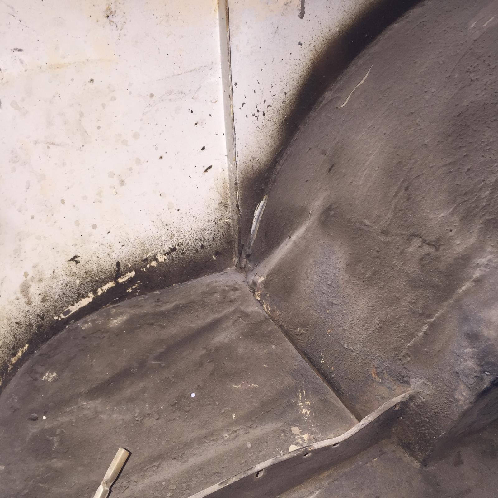

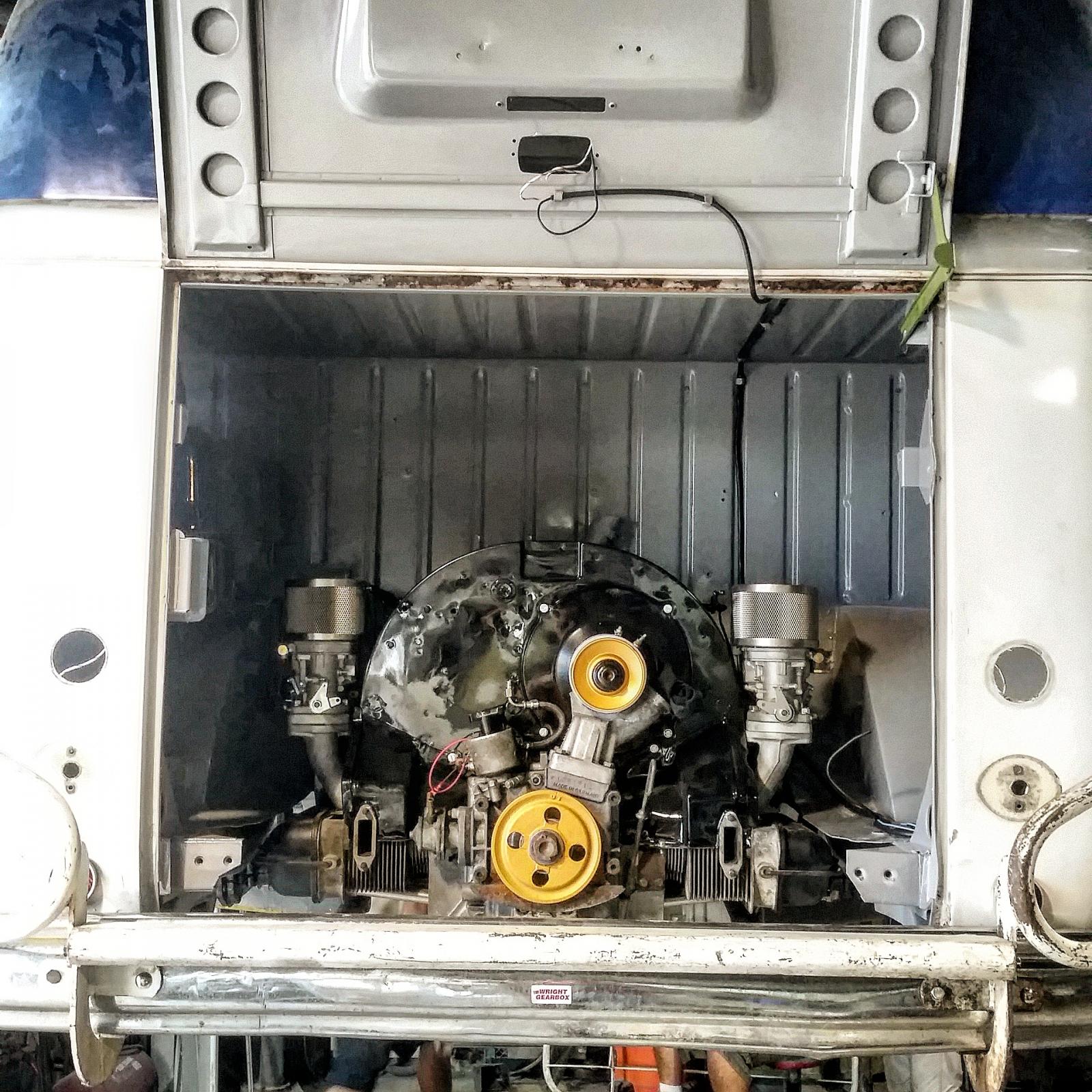

The 1954 Brooks Stevens Westy in its current condition. The underside is getting restore to fix rust and damage incurred over the years with special care to preserve the outside original condition that the bus is known for.
The engine sheet metal is getting fixed. The transmission is getting upgraded it will still retain its barndoor reduction boxes and front beam but will have a 912 motor put back in it just as The pictures above show it. And will running 16" barndoor rims with Porsche drum brakes.
