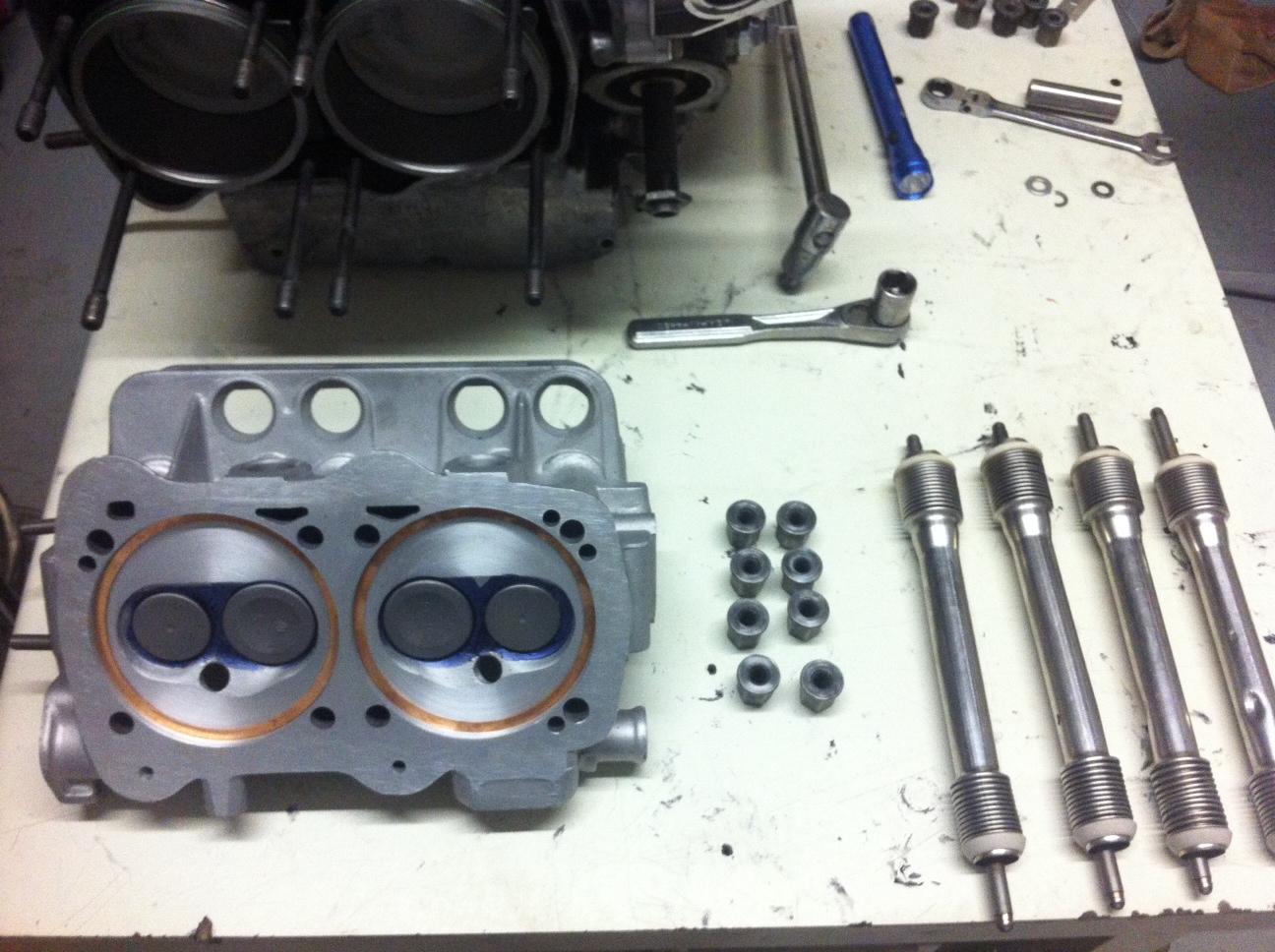

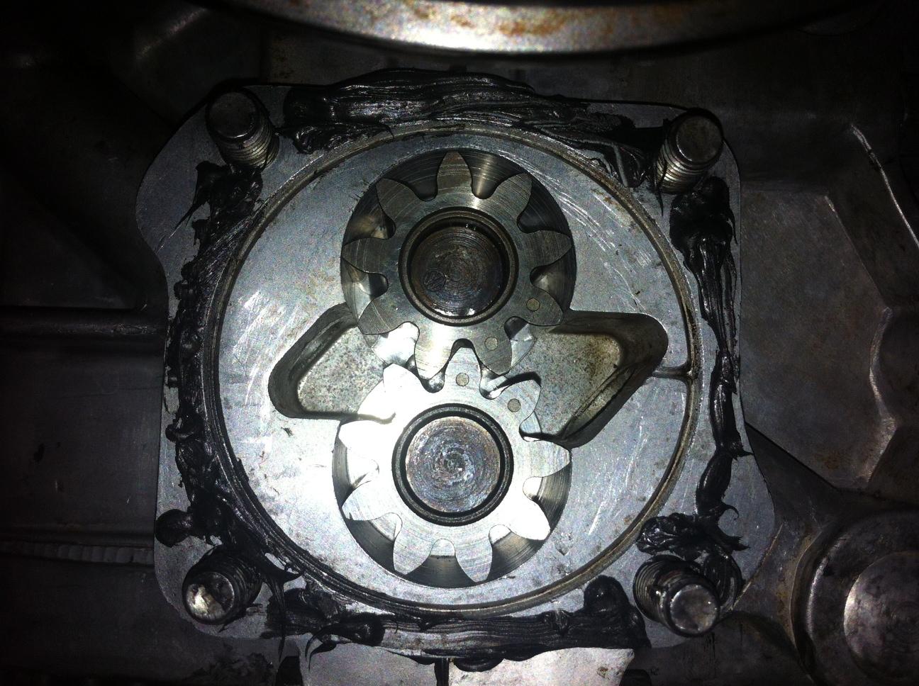

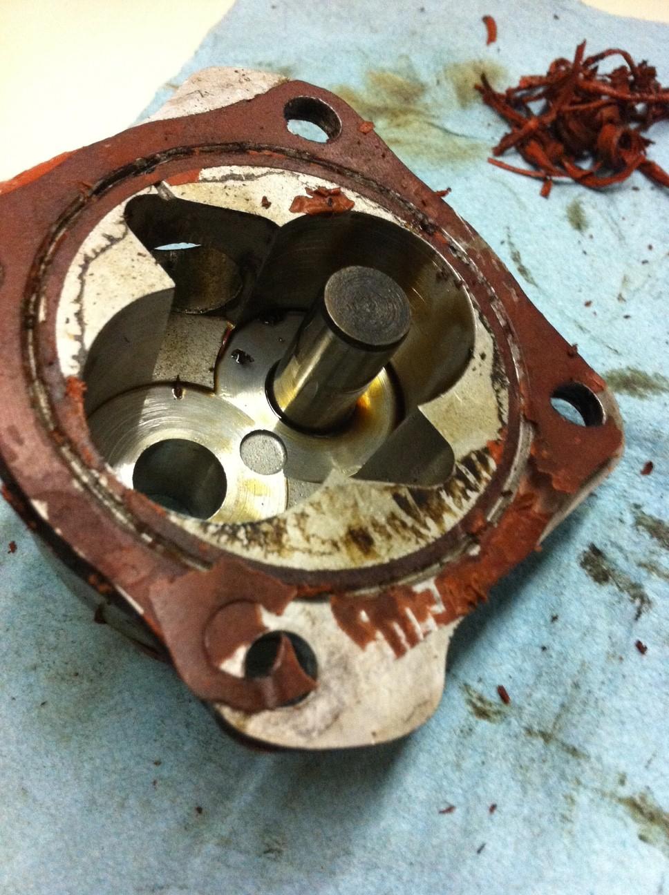

At first I thought the last guy who changed this knew what he was doing but sure enough there were gaskets on both sides under the plethora of RTV
I didn't have feeler gauges but I placed a magnetic straight edge over the gears and measured the play by pushing the gears down and letting the magnet pull them back up. I had 0.0035” so I skipped the gaskets, just the right stuff.
Replacing water pump studs with bolts: 8x35mm, 1.25 thread, 13mm wrench
Set up to put the heads on. Sealing surface on heads lightly sanded

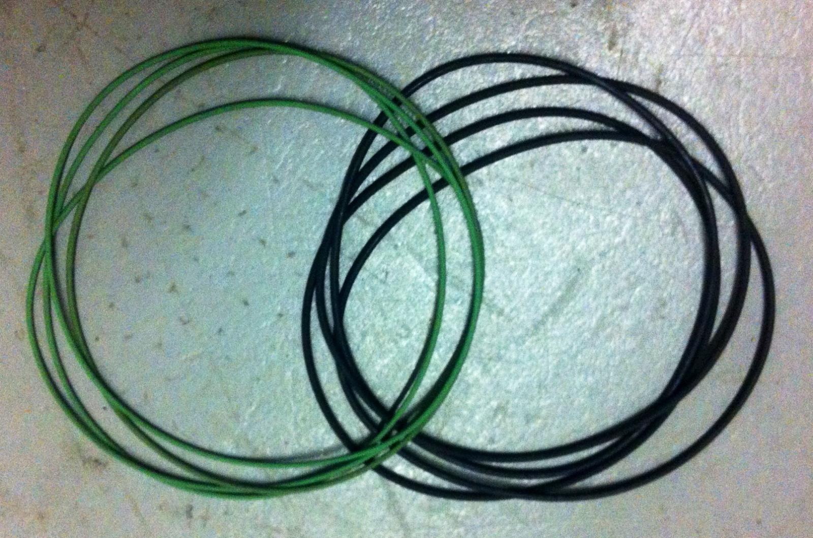

I also gave the water jacket seals a quick buzz to form a good seal
Engine strapped down. I put a wrench on the pulley bolt to hold the crankshaft still while I torqued the flywheel down.

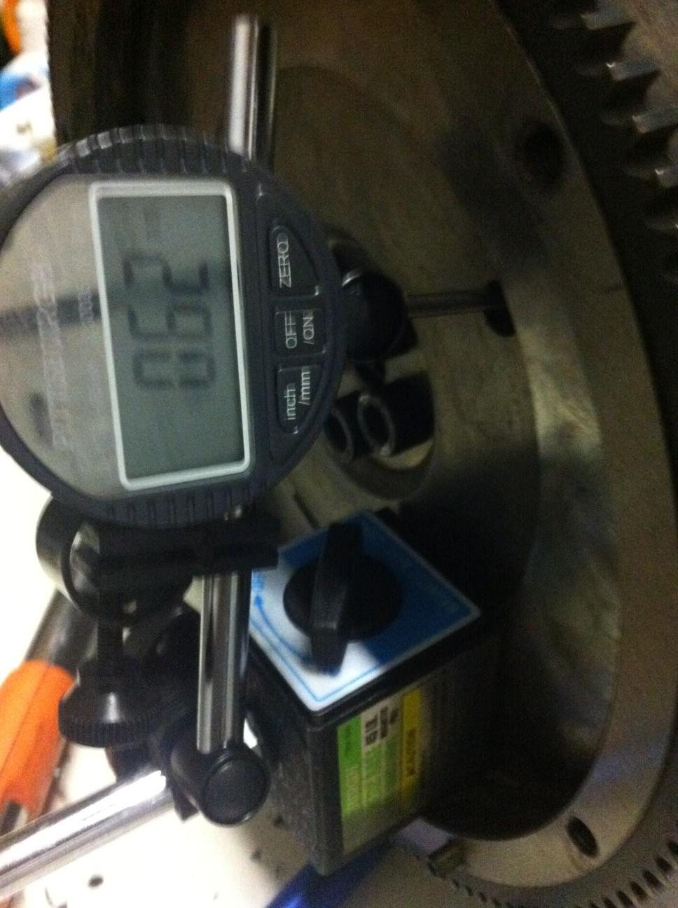

Crankshaft end play is very high. I had to order two .38mm shims to get it down to .10mm.

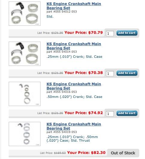

Robw_z wrote:
So what size main bearings did you end up going with?
-Rob

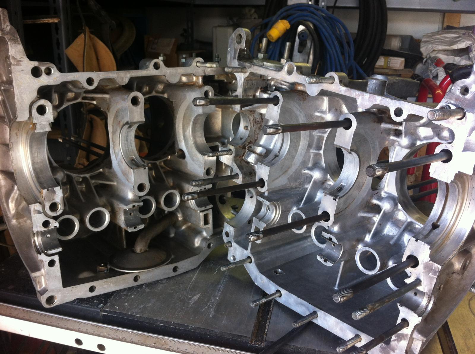

Standard sized bearings. I ended up just using my calipers to measure my crank. If you go to a machine shop for anything, I would recommend you also just have them measure your crank so you don't have to buy a micrometer. I took my crank in to have them pull the gears pulled off. They charged me for 15 minutes so I wish I had a short list of misc requests to get my money's worth.

Robw_z
Joined: April 28, 2007
Posts: 997
Robw_z is offline
PostPosted: Sun Aug 19, 2012 2:45 pm    Post subject: Reply with quote
-Rob
