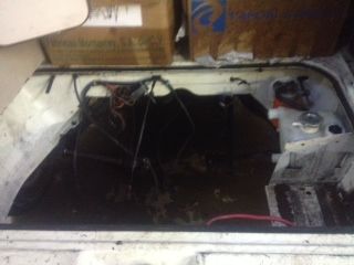

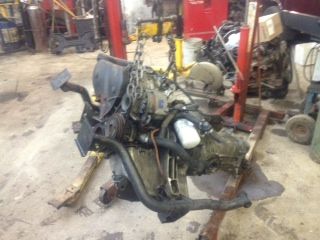

PostPosted: Fri Aug 31, 2012 5:16 am    Post subject: Reply with quote
Pics of last night's work [img]
[/img]
Step one of many on the mechanical is done!
