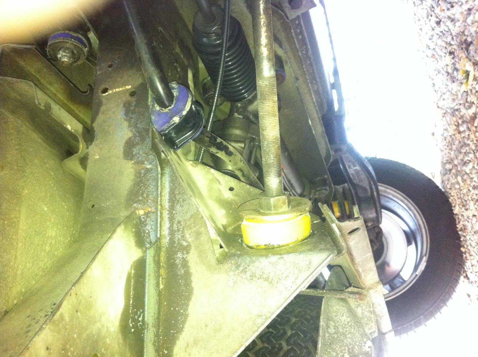

PostPosted: Mon Sep 10, 2012 7:27 am    Post subject: Reply with quote
I would do this.
Rebuild your susepnsion as you have planned.. but do NOT replace the strearing rack bushings, yet. Drive it a bit.. Get it aligned. Drive a little more.
Get a feel for the seteering with a mostly new front end.
THEN put those little purlpe marvels in, replacing the OEM style bushings on the steering rack. It is not a difficult job and will not impact anlignment.
Go for a drive.. FWY speeds. A winding road. Subtle but difinitive improvement.
It is REALLY rewarding to be able to sense the improvments of small incrmenetal changes.
And the little purple marvels are a fantastic examples of how a small change can lead to real improvement.
-89 GL Westy, SVX.. finally.
-57 pan f/g buggy with a 67 pancake Type 3 "S"
"Jimi Hendrix owned one. Richard Nixon did not"
-Grand Tour, Season 1, episodes 4 and 5

The poly steering rack bushings are the way to go. Just adding
those to an otherwise stock bushed van makes a difference you
can feel. Plus their easy to install after removing the stock
ones.
Going with Lemforder is a smart choice. Avoid Meyle stuff
at all costs. Everything I installed from Meyle lately has
been poor quality.
You will be fine going with the rubber bushings you have
chosen don't let the lure of poly make you think otherwise.
Your maintaining your van to stock specs helps keep its
value and dependability. Driving it will be a pleasure again.
Bill M

PostPosted: Sun Sep 09, 2012 9:33 am    Post subject: Reply with quote
So, I have made up my mind - I am going with rubber parts for my rebuild, and am considering poly for steering rack bushings (but may be persuaded toward rubber).
This is what Van Cafe is currently shipping with their kit:
Upper Control Arm Bushings ----------- Febi/Germany
Lower Control Arm Bushings ----------- Febi/Germany
Radius Arm Bushings -------------------- Flennor/Germany
Sway Bar to Body Bushing -------------- Flennor/Germany
End Link to Control Arm Bushing ------ Volkswagen
End Link to Sway Bar Bushings -------- Flennor/Germany
Upper Shock Bushing -------------------- Volkswagen
Other than going with Lemforder for the Lower Ball Joints and Lower Control Arm Bushing (don't know if VC stocks them, but BD does), should I go with their kit? Or are any of these parts known to be bad / to fail quickly? I would also consider going with poly for the particularly fail-prone parts, in hopes that I never have to do them again. Like I mentioned earlier - I am open to a blended solution.
Any particular reason why I should go with poly for the steering rack vs. rubber?

insyncro wrote:
I am testing the Powerflex radius rod bushing set, yellow, soft, on my 91 Syncro Westy currently.
It has been raised to the max and had been having slight alignment issues.
Very nice so far.
Glad you like them, took a bit of messing out they did.

When I had some front end work done (decided to pay for it for a change) I had both upper and lower ball joints replaced, lower control arm bushings done and the radius rod bushings, as well as front axles and lift springs and shocks.
I used T3 - Chris - for the lower control arm bushings from Powerflex and couldn't be happier. I used the factory rubber bushings for the radius rods, only because the Powerflex ones weren't available at that time.
I changed a lot of things, but I have used quality poly bushes in a lot of vehicles in the past and never been disappointed. I will use T3 for the upper control arm bushes when then need replacement next.
