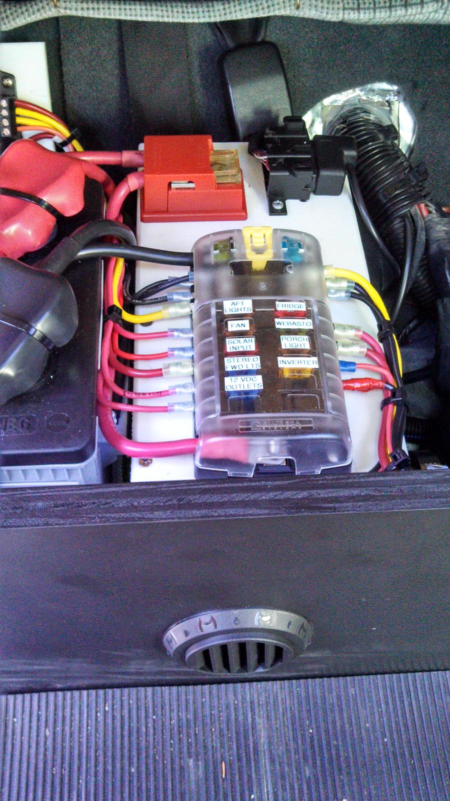

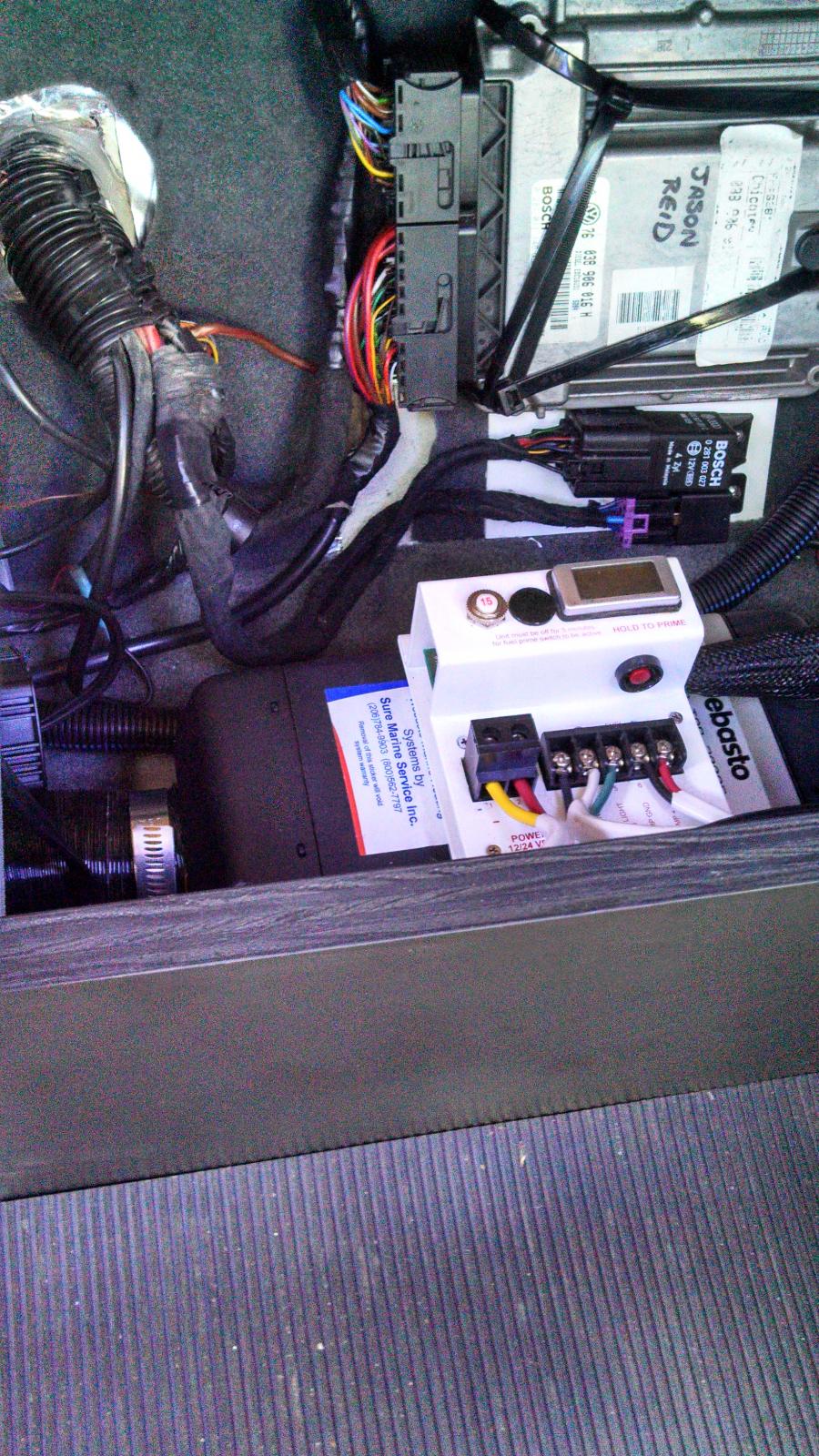

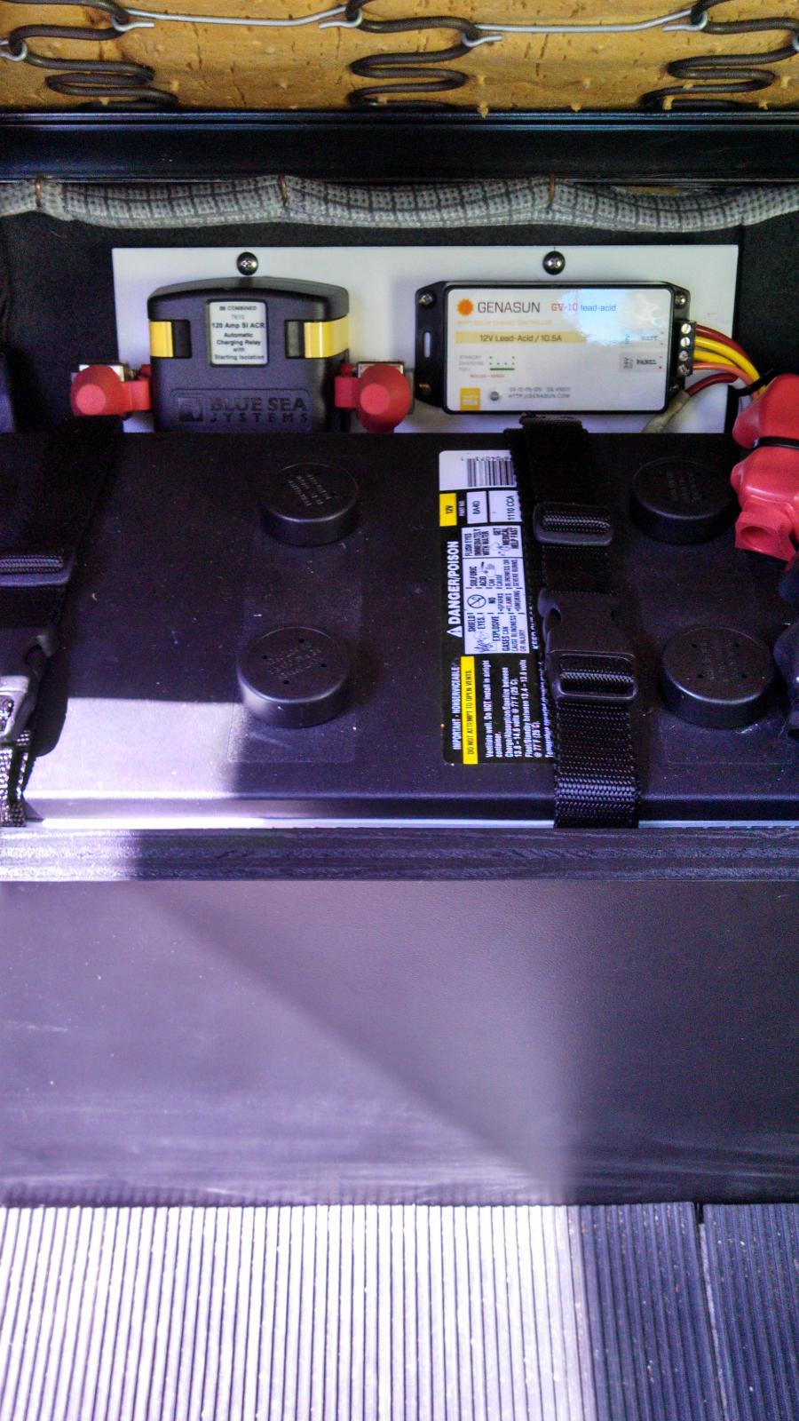

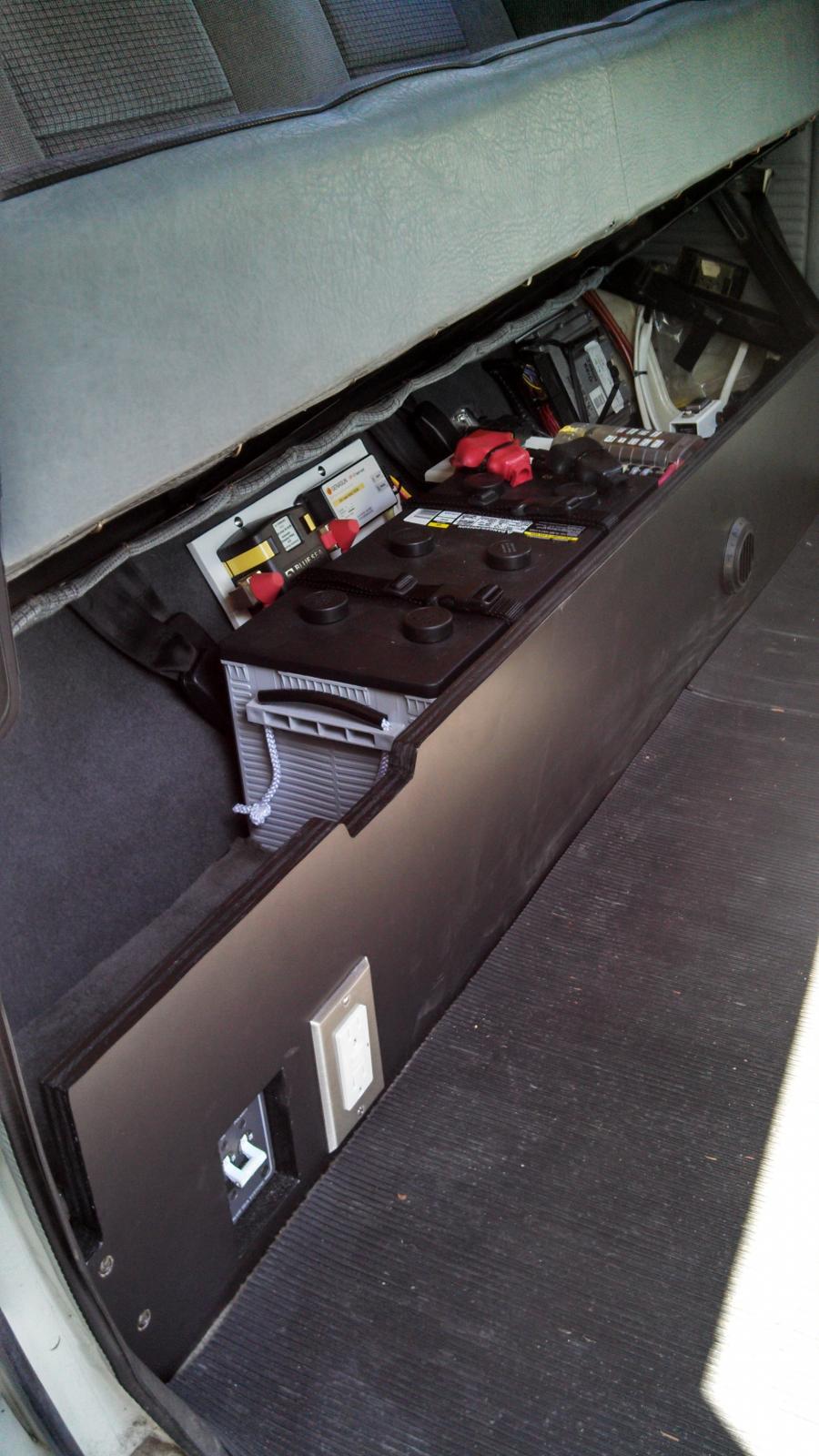

Sorry to take the post on a tangent but, to mount the 4D I blew out the under seat heater since that is where my Webasto outlet is and the factory heater was never used.
Battery along with new face frame with factory heater outlet deleted.
Charger controller and ACR above battery.
Fuse Block
Webasto control board and TDI ECM and relays.
86 Syncro, weekender carat interior, the rest is bone stock for now

jstar89crx wrote:
I have mine hooked up to a 4D AGM under the back seat and it also charges the flooded start battery through a Blue Sea ACR.
Which controller is that?
I am going see if I tacan get a timing rate of PV input for the EPSolar Tracer MPPT controllers.
As an aside: WOW, where you mount that 4D monster?
Pictures or it ain't real.....

PostPosted: Mon Oct 08, 2012 2:20 pm    Post subject: Reply with quote
