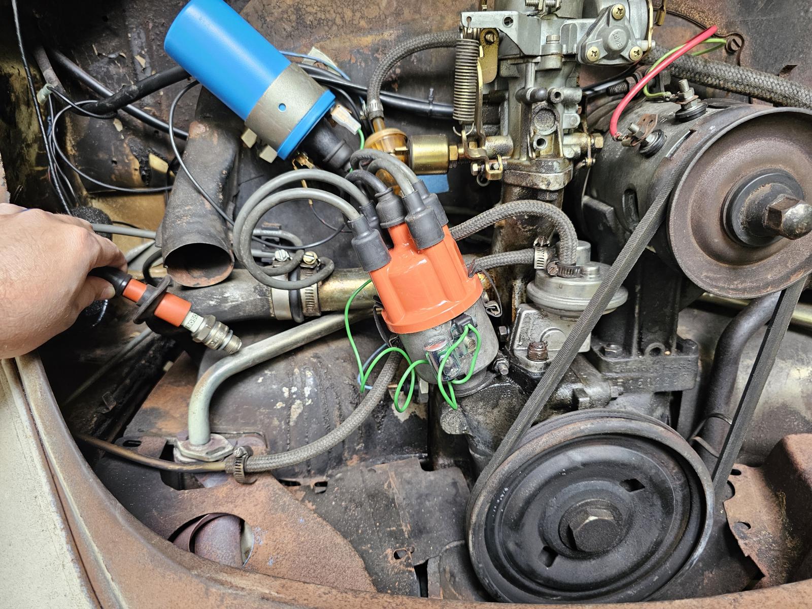

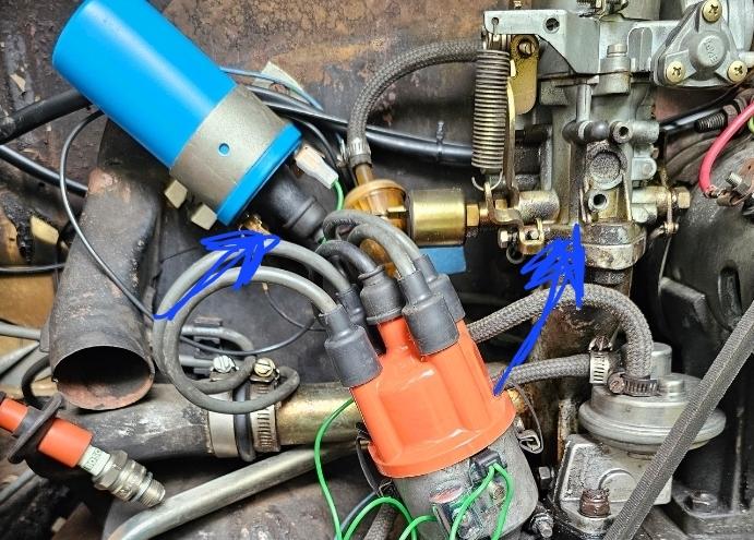

Is there something obviously wrong with my wiring? My car won't start. I tried disconnecting the central wire going to the distributer and held it close to the intake to see if I could get a spark and nada.
Looks okay.
Why is the fuel line sitting on the exhaust? Not a good idea.
Jimbo

PostPosted: Wed Jul 31, 2024 11:48 am    Post subject: Re: 67 Beetle will turn over but not start Reply with quote
Remove the black wire(s) on the hot side of the coil. These lead to the idle solenoid and choke. Then test with a light or VOM and see if the points are opening and closing.
Those two devices are connected to the hot coil lead, and thus are unfused. A short in either wire or device can prevent the coil from charging.
Note with the idle solenoid unplugged you won't get fuel, so it won't run thus way. but it removes one more variable/failure point while you are troubleshooting the ignition.

PostPosted: Wed Jul 31, 2024 12:57 am    Post subject: Re: 67 Beetle will turn over but not start Reply with quote
This is where I put the multimeter to check for voltage. Got 12 volts going from the positive side of the coil to the air intake.
Also, rotated the engine around until the contactor? was separated and checked for continuity with the contacts. I was getting continuity with the contactor separated. I checked the resistance of the primary and secondary coil and got about 4 ohms on the primary and maybe 5000 on the secondary. It matched the value of the previous coil.
The top half of the distributer is new.
Have replaced the the coil, condenser on the distributer, the distributer cap and the rotor.
Just can't seem to get a spark to develop. Battery voltage is also good at 12 volts.
