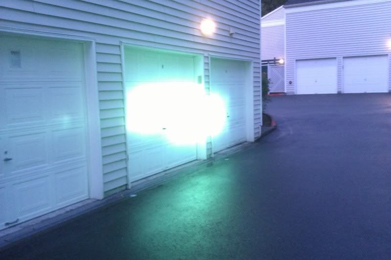

PostPosted: Thu Oct 03, 2013 8:12 am    Post subject: Reply with quote
Hey, sure.
I know how varied opinions on HID use can be out there, depending on whom you are speaking with.
I feel differently about use of a incan vs a HID bulb, its the bulb, a specific form factor requirement paired to the design/curvature of the housing which allow the light to be cast as desired, change that light point, you have to re-aim.
When fitting, I changed one bulb over to hid, turned them on, and they seemed to represent the same light pattern, just a lot brighter. I wish I kept my before/after pics.
Sure there is some "flood" which you cant get away from.. but I also blacked out the lense edges to reduce that as well. (painted/blacked the edges, except for the face of the glass)
I've had a friend try to pick me outta traffic on a busy freeway at night in the rain from 1 mi, 1/2, 1/4 mi.. he said oh yea.. you're bright, but not blinding, pretty much look like every other hid light on the road, bluish/purple hue..
So, I also aimed down a little more than normal.. (to be nice)
Given the amount of light they're throwing down (both lows, highs, fogs..) its great for backroad driving, easy infact. I cant, and wont argue with the fact there is now heinous amount of light when I need it.

PostPosted: Thu Oct 03, 2013 7:42 am    Post subject: Reply with quote
Do you have a photo of the HIDs on low beam? I have never seen an HID installed in a reflector lens that offers anything approaching a proper beam pattern. I have removed lots of HIDs from reflector headlights for people trying to get good lighting, but never installed a plug and play conversion kit that I would let out on the road.
For high beam use in the small inner high beam lenses, a set of decent quailty 35W H3 HID bulbs and ballasts might be a worthwhile option, since you won't be using them in traffic and the increased lumen output could be a welcome addition on dark country roads. I would only caution to be leery of the cheap "slim" ballasts that are included with some low priced kits, as they often fail after just a few hours of use.

I see, they also have 4"..
http://www.amazon.com/Truck-Lite-80275-Auxiliary-L...63-8008169
So, that's like dropping 1K on lights.. 250 per on the outers, egad.. costly.
What about HID?
I HID'd my square headlights, Highs and lows, in 6000K. something like 50 a kit, covering two lights, ballasts, wiring harness.
I did the Kensun kits, used relays to power them, never get highbeamed from others.. and they're super bright.
Highbeams alone.
between a set of four of these and square KC highlighters.. and a air horn..
I don't get cut off.. for long.
