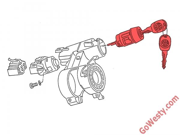

Sodo, I tend to agree, hence my interest when I saw it being discussed in the thread.
I'm testing out the performance using key in power but might switch to use key on power.
I'm still curious how the key, the lock cylinder, and the ignition switch all integrate, and if cleaning and lubricating can improve performance or not. I notice that If one just barely inserts the key, the key in power is applied. A "plunger" was mentioned. Wondering if this pushes down and contacts the ign switch ? I have not taken the lock cylinder apart but am looking at some images.
I also see that the cylinder and switch via GoWesty are very inexpensive, which tends to tell me that they are cheap aftermarket and likely crap ?

Is the intermittent "key in" power described a result of wear in the Ignition Lock Cylinder, OR the ignition switch contacts?
I'm asking as I am pilot testing a kill switch on the Fuel Pump that uses Key In power to a latching relay. I have noticed that IF one wiggles the ignition key, or otherwise moves the key, once it's inserted, that key in power can be lost.
Not a good situation IF your Fuel pump ground is dependent on it. I am considering using Key On power IF Key In is not reliable BUT am interested in seeing IF the key In power issue can possibly be improved by cleaning or lubricating the contacts / parts.

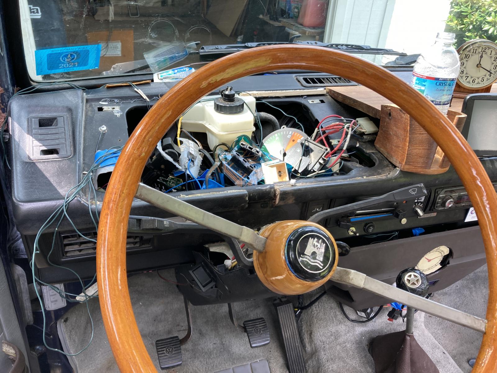

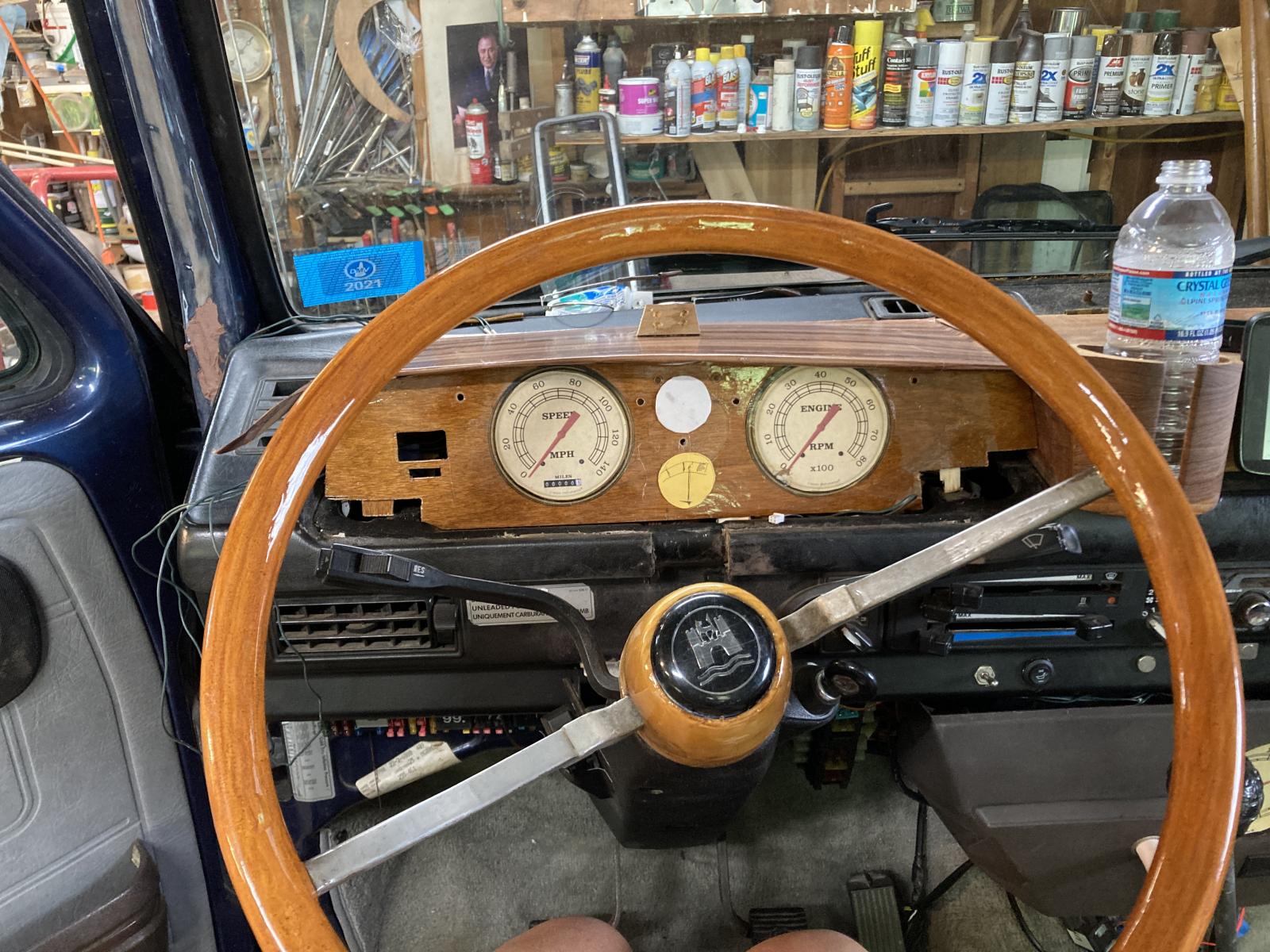

Odd this topic popped up right when I'm in the process of eliminating the OG ignition switch. However, long ago I relayed everything so the ignition switch saw only coil currents.
This is where I'm currently headed.
The look I'm after. Grew up with cars of this era and I'm also a boat builder--was a boat builder, so........
There are really cool vintage ignition switches with lever operation, One is barely visible in the pic above just to the left of the steering wheel. But they tend to be in poor condition or blindingly expensive. So have decided to go with chrome pull knobs for all switches...........except the ignition.
There have been a bunch of posts about thefts and kill switches that have made a lot of sense.
So this is the way I will start my car.
The key will remain in the OG switch in the on position to unlock the steering column. I need the key anyway for the gas cap--well sorta--and for the door locks. However, it will have no power going to it unless later on I decide I need a momentary switch for something and can use the starter position for that.
I have an unused cruise control which will never get fixed or upgraded. Thus, turn on slide switch cruise control which will activate a relay and give power to what the ignition switch normally provided--all 15 current path loads. Then make a right turn signal with the stalk which will lock the fuel pump relay ground interuptor. Then push the momentary button at the end of the stalk which was for increasing speed? This will activate the start relay. Let's see a thief figure that one out. I'll have a note I can show for my mechanic and others..
Yes, I realize that I will lose the load interruption feature, but I never start my car with headlights, fans or any of the other loads that handles anyway. I could relay that as well, but don't think it's worth the effort unless someone tells me differently.
Duncan
