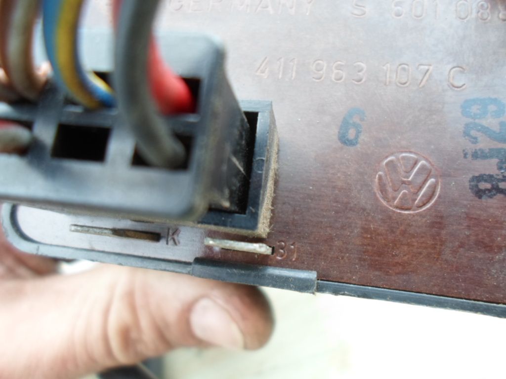

K usually indicates an indicator light or switch, 31 is always ground. Of course a look at the wiring diagram in the manual wouldn't hurt: http://www.thesamba.com/vw/archives/manuals/1977eberspacher_ba6_repair_manual.php

Here are some wiring diagrams. Not sure if you have seen them. It looks like the 'K' wire is used. I don't see a '31' on there. Terminal 31 is the ground circuit on German cars. Can you tell by looking at the terminal if there is any wear or signs of it not being used?

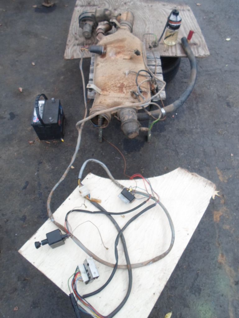

Got the gas heater laying here. The fuel pump spits gas, i've got a bunch of wires & i was hoping to make a quick wiring harness so i can make it run. Do i need to remove the switch from the dash & all the wiring loom to hook this up proper, or does anyone have a simpler way to bench test them? I found some black & white wiring diagrams that are pretty hard to figure out.

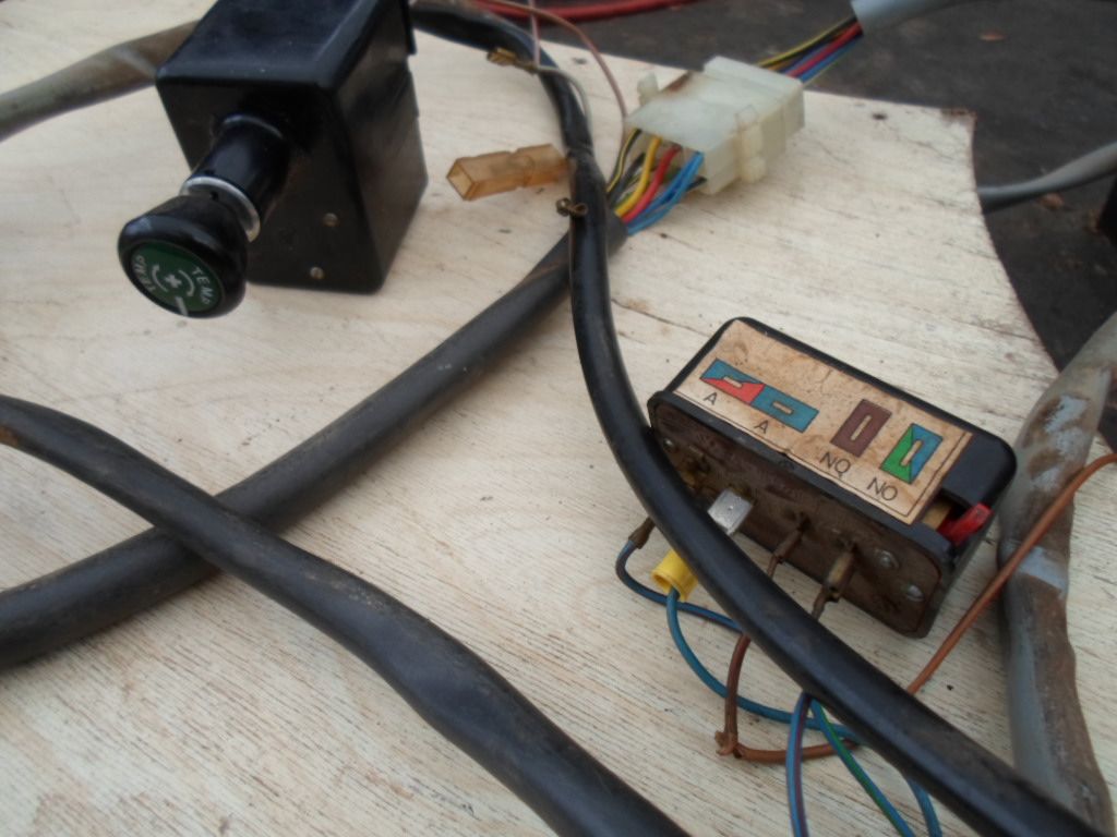

In order to run it on the bench you really need to pull out the wiring harness. There is a safety switch and a triple relay under the dash and the harness plugs into them. Also 2 wires go to #9 and #10 in the fuse box and 1 wire goes to the switch on the heater lever that turns on the fan. If you pull off those wires and pull out the relay and the safety switch the harness is all self contained and is fairly easy to get out of the bus. I have taken 4 of them out in about 1 hour at a junkyard. It's just held on with zip ties under the bus. Don't try wiring it up yourself, that's not really a good idea. Also having the wiring harness out makes it easy to inspect the wires and see if any are shorting (yes I have had them not run because of that). PM me if you need any help, I have rebuilt a few of these and their smaller brother the BA4.
Well, i pulled the harness out along with all the relays & switches. Came out a lot easier then i would have thought. The wiring all seems to be in great shape. Now i'm wondering a few things about what kind of ground wires to run & where? Most of it is all hooked up ready to run now.
This part of the switch only had 1 wire going to it, and it was brown (ground). Been trying to look at some diagrams to find out if the wire was going to the 'K' or the '31' on this switch

PostPosted: Thu Aug 15, 2013 2:45 pm    Post subject: GAS HEATER!!!! Reply with quote

PostPosted: Wed Aug 07, 2013 6:56 pm    Post subject: Reply with quote
Pulled the gas heater, and i'm going to see if i can fire it up this week.
cool old eberspacher fuel pump
here is the ignition coil
and here is where fuel meets up with spark & makes fire hopefully Laughing
