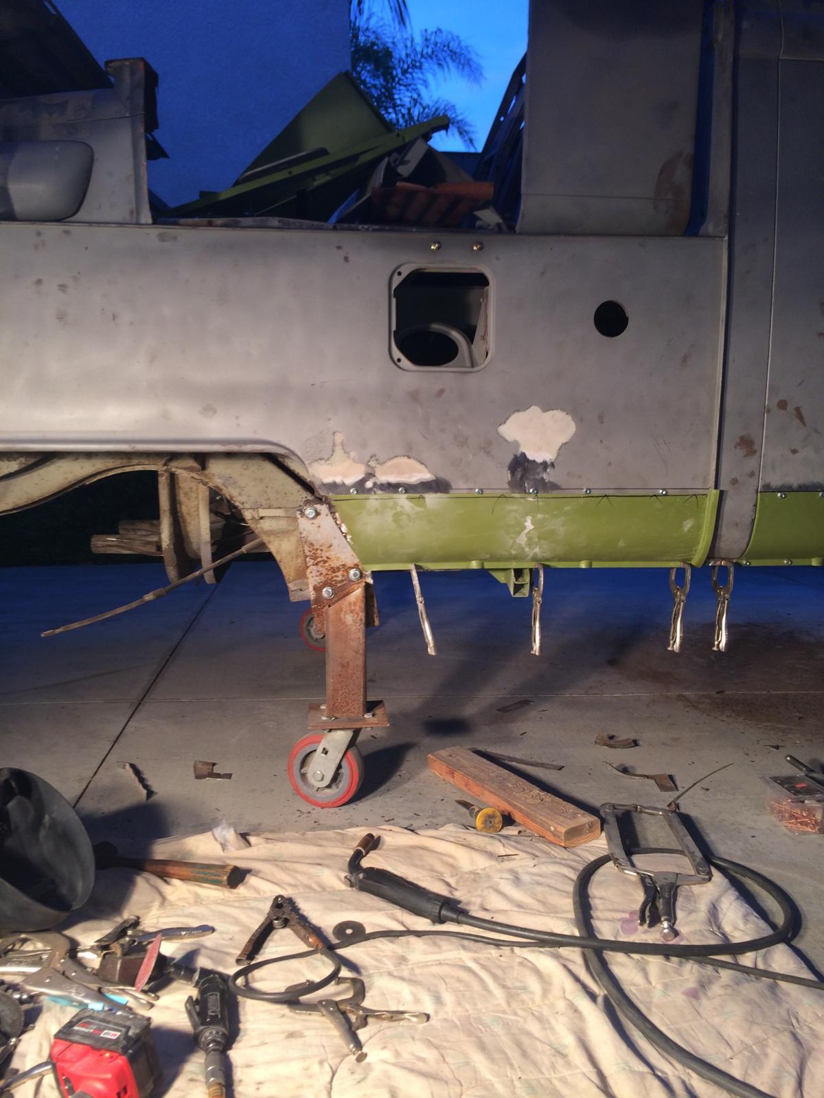

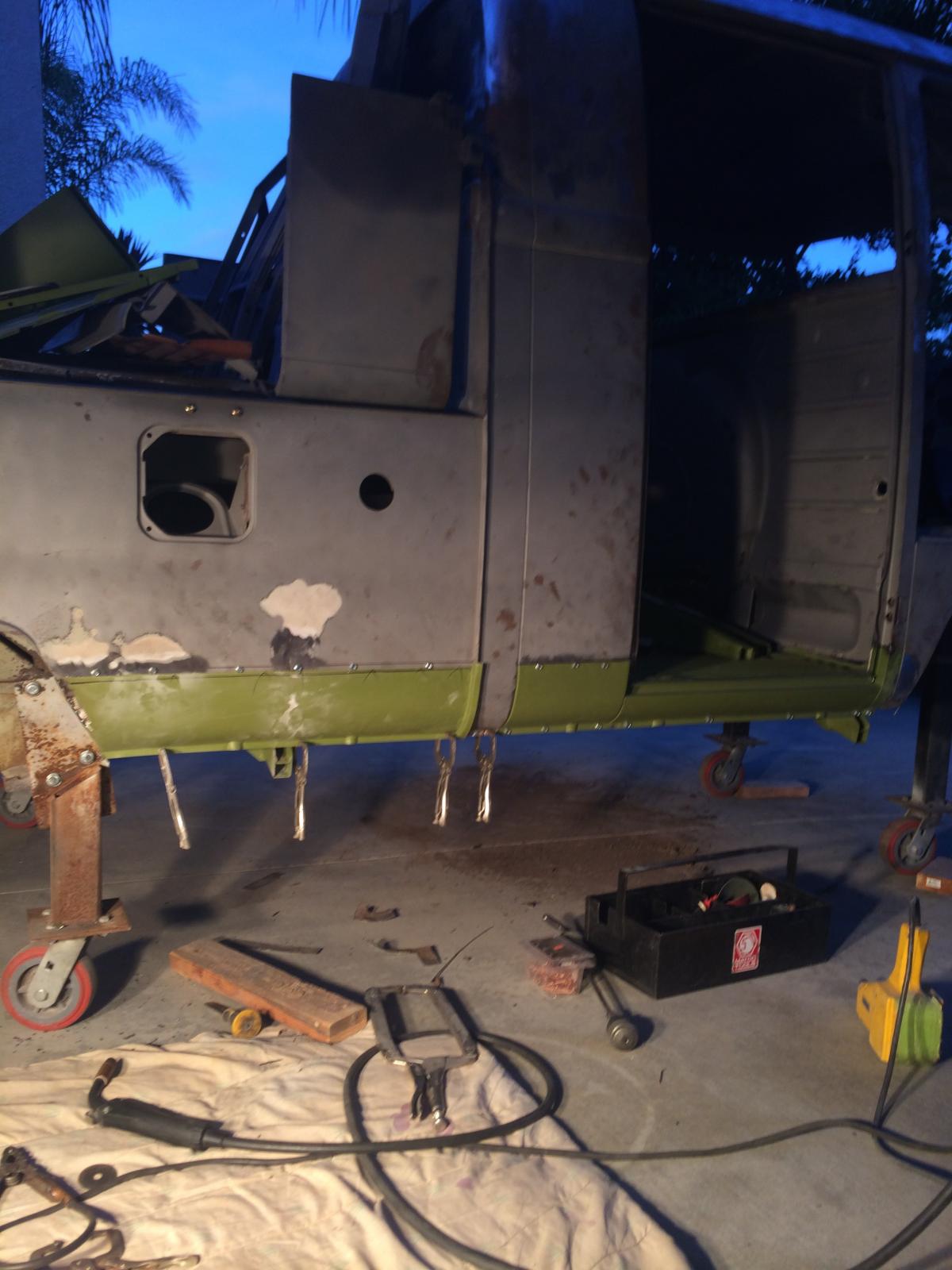

PostPosted: Mon May 05, 2014 10:38 am    Post subject: Rockin the rockers Reply with quote
All rockers positioned and ready for welding.
A lil modification to the Klassic Fab part to make it fit
Ready for welding!
-Roy

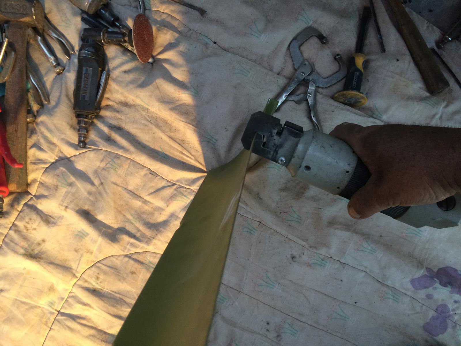

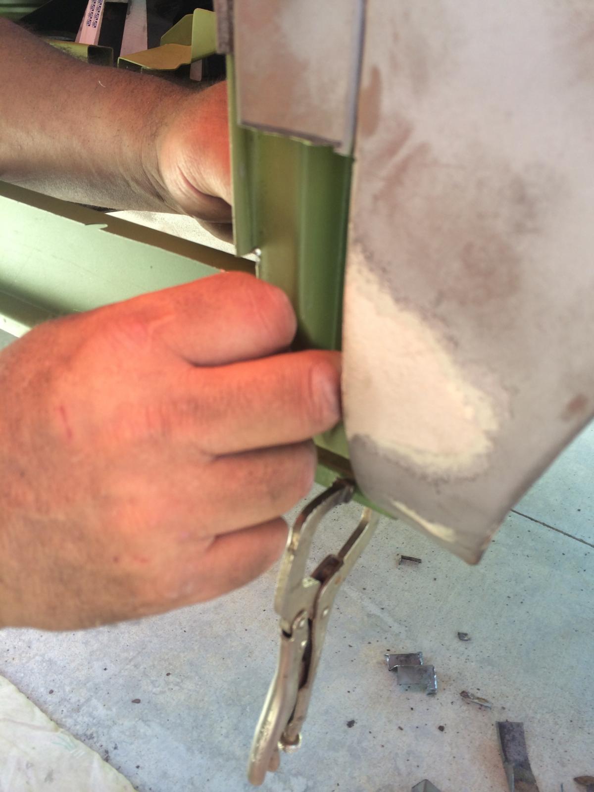

PostPosted: Mon May 05, 2014 9:59 am    Post subject: NEW METAL!!!! Reply with quote
The Day has finally come. Time for things to stop coming out and stuff to start going back in.
Top Hat and inner rocker
B pillar section
Now for the stuff thats seen. This is all just fit in no welding other than a tack or two to help with the fit.
Its going to be difficult or next to impossible to weld in the support under cargo door in between the outer and inner rocker so after we fit everything the inner rocker will be unscrewed and the support bracket will be welded from the back side then the inner rocker followed by the floor section.

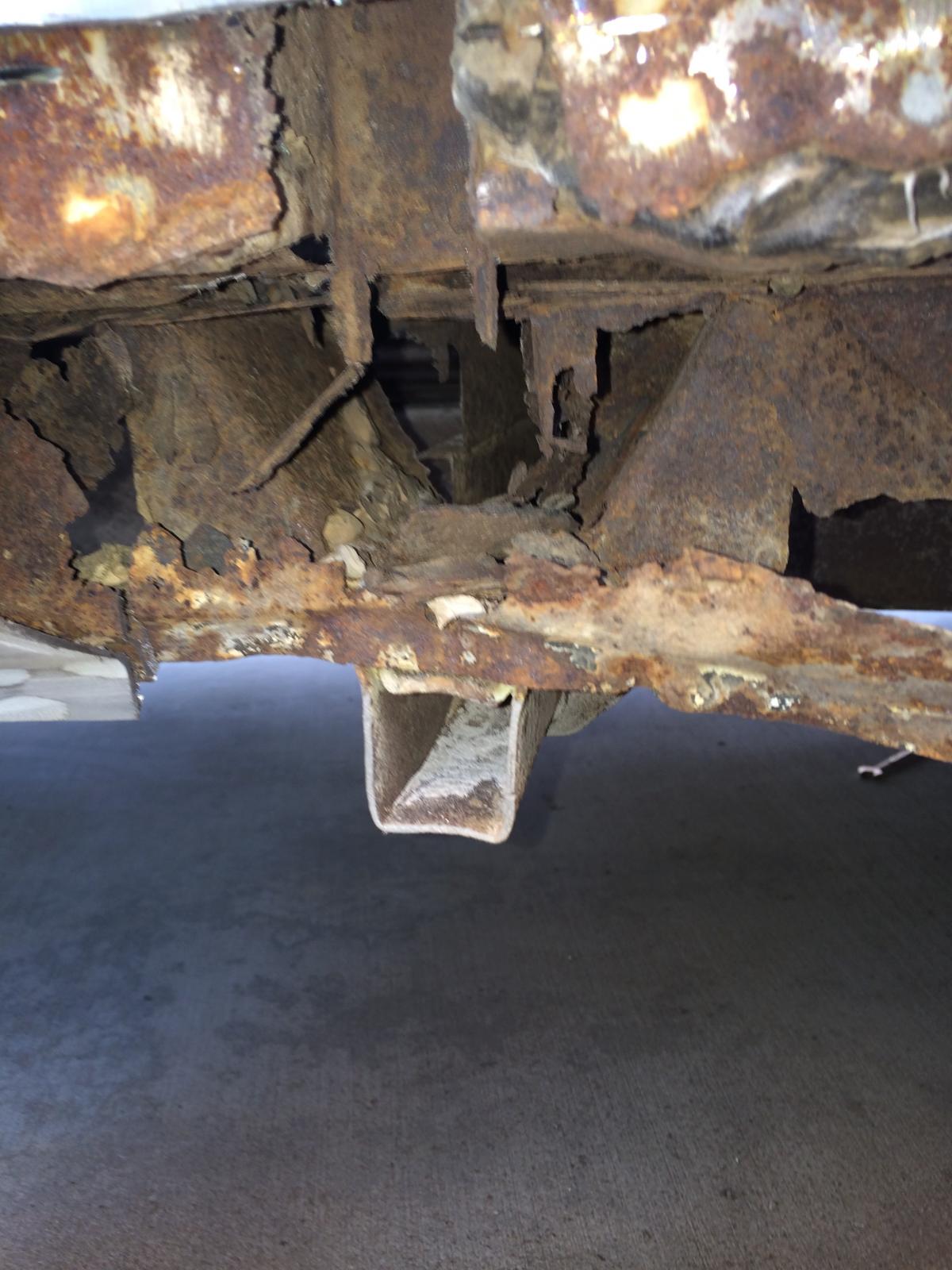

PostPosted: Mon May 05, 2014 7:56 am    Post subject: Reply with quote
Tear down of the old rockers and support structure under the side floor sections. She looks pretty bad in there.
If you have a weak stomach, WARNING the next photos are GRAFIC
