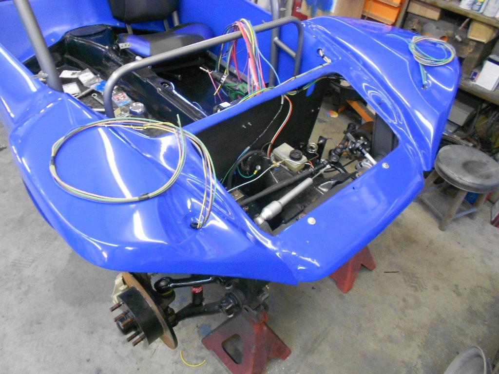

jspbtown wrote:
It is very important to mock up the whole assembly. Windshield, hood, dash, wiring, headlight, brake and turn light placement and fuel filler.
Not sure if I would lump wiring in with that group.
I agree.
I do my wiring once all fabrication is complete, painting process is complete and roll cage/body is bolted to the chassis.
If you are concerned about scratching paint, lay a protector over the body area you are working on, like a blanket.
Not so much the wires themselves, I'm mean the holes you have to drill to fasten the harness holders, junction blocks, fuse boxes, relay panel and the entry and exit holes through the body. The less chances you have to scratch the paint on things, the better! Plus, it's a lot easier to mock up the wiring with the hood off.
