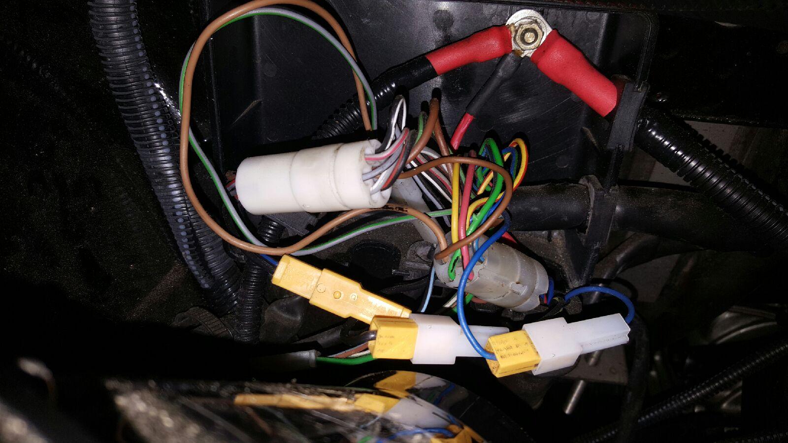

Here's a couple shots of mine. Hope it helps

In the picture (2nd up) I see your positive post has the wire going to alternator. Do you also have the other wire from post to starter?

np. Is the engine cranking? Do you hear the fuel pump kick on when you turn key half way on? Fuel pump is noisy enough to hear.
