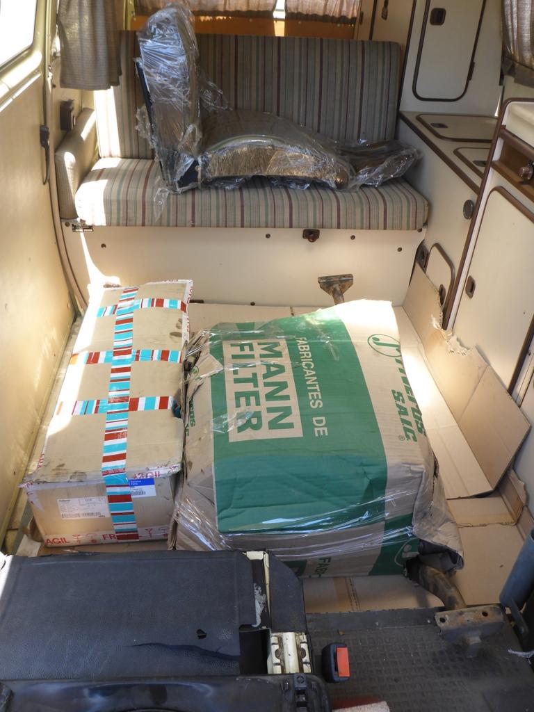

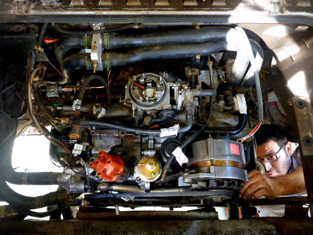

Within a few days of the motor's arrival in Santiago, Juan Pablo had dismantled the engine, sent us photos and assessed that the engine was a good candidate for a rebuild as all the interior workings were in relatively good shape. No red flags. The big problem would be extracting the head studs two had already snapped and another two had the same problem when torqued on. The block would have to go to a machine shop to have the studs removed. Fearful of how reputable the machine shop might be, a good friend in Santiago, Jose Antonio, had his mechanic friend (another Christian) confirm that the shop doing the work was reputable. Absolutely! The problem was that it is summer in Chile and February is a hard time to get things done as many are away on vacation. The first machinist started on January 14th over time was able to extract 6 of the 16. Then it was sent to another shop, that extracted 4 before giving up. Another shop did another 4 before stopping and a final machinist did the last 2. All bolts were out on Feb 25. Here is what was left of them:
One stud required over drilling at a larger diameter. All the others are stock size. The studs were locally constructed here in Chile as they needed to fit the one custom hole, are constructed of the same material with surface treatment and were cheaper than buying from the states. These were finished on March 1. Here is the new team:
The main problem we had with this process was time...it took over 1.5 months just to get the studs out! During this time I was able to do a few things in preparation.
(1) Find out which parts we would need for the engine rebuild
(2) Find out which parts we would need for projects on other systems.
(3) Fly to the US to buy and import the parts (and various other reasons)
(4) Do as many as possible of the repairs on other systems in the van.
In California
The internet is a scary place to buy parts...it is easy to get carried away..."I'll take one of those and one of those, and, oh, that looks useful." Based on time spent over, under and inside our vehicle parked engineless in Concepcion (labeling all kinds of things with tape) as well as time spend talking with the mechanics in Santiago, I decided on a purchase of the following items:
For the motor:
-water pump, thermostat, full gasket kit, new clutch kit, all new engine bearings, distributor and cap, lifters, piston rings, oil drain plug.
For the brakes:
-new pads and shoes, front caliper rebuild kits (rubber and steel parts), steel flex hoses, copper hardlines for rears, emergency break cables, grind rear drums
For the trans/suspension/rolling:
-new sealing for shift selector and shift rod boot, one CV joint kit as a spare, full bearing set for front
For Interior/Camper parts
-New 3 window tent to replace highly ripped one, rain fly for tent, curtain ring parts, LED lights to for dash, door panel clips, skylight handle. Fuse box cover, 2 handles for climate controls, Lights-R-On kit, spare fuses.
For the brain: Haynes and Bentley manuals
I had an opportunity to run home and accomplish many things at once (important family visits, computer repair, camping equip purchase, vanagon parts pick up, etc.) When arriving back to Chile I declared all the parts and was waved through customs.

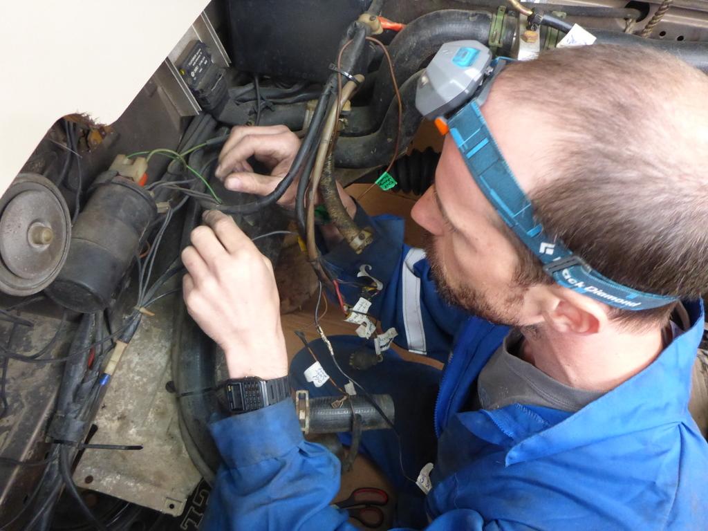

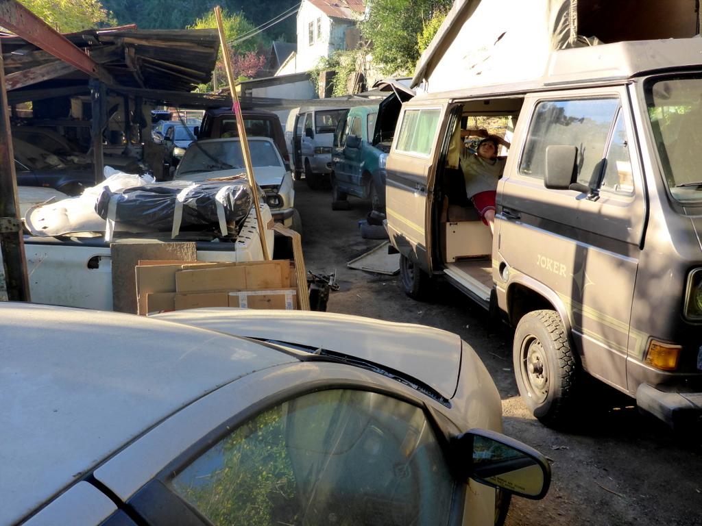

At this point I was able to start in earnest in repairs to our vehicle at Mitchel's garage. He was kind enough to give us a space at the very end of his storage/work space where we could tinker away at things. I had permission to use his tools and ask for advice when I was uncomfortable with something. The shop was a family operation with dirt floors, undefined hours and a comfortable atmosphere. The guard dogs were more interested in cats than burglars. I bought some simple tools at a few local shops, some overalls and started to get dirty.
We started with the simple things that we were confident in such as wiping up the oily engine compartment, labeling wires or flushing the coolant hoses, heater core and radiator.
Gradually we incremented up to replacing flexible fuel lines, and doing electrical and brake work. Once done, Mitchel did a full check of my work, confirming that I had not screwed up anything. I read a lot and the kids helped at times.

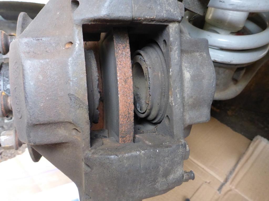

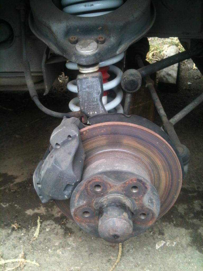

Our car has the ATE Teves calipers in the front.
Before:
After:
On the driver's side, the pads were in ok shape but the dust covers were completely fired with hard, brittle edges likely from over-application during the tow. This was the side that the brake-smoke was coming from. The pistons on this side came out easily with air pressure.
On the passenger side, one pad was only about 2mm thick and the piston behind it was stuck and refused to come out with air pressure.
I was able to use a C-clamp to lightly crank it squarely back into the cylinder a little, breaking what ever rust or gunk was holding it in place. With all pistons out of the calipers, I cleaned all parts, lubed with brake fluid and installed rubber rings, pistons and dust covers. The disks are thin and will need replacing soon. I replaced the flex tubing in the front and back with the expensive steel stuff cause I could not live with myself if I bought rubber and they failed (I know, unlikely). I also replace the hard lines that connect the flex to the drums because I had issues getting the press fittings out gracefully.

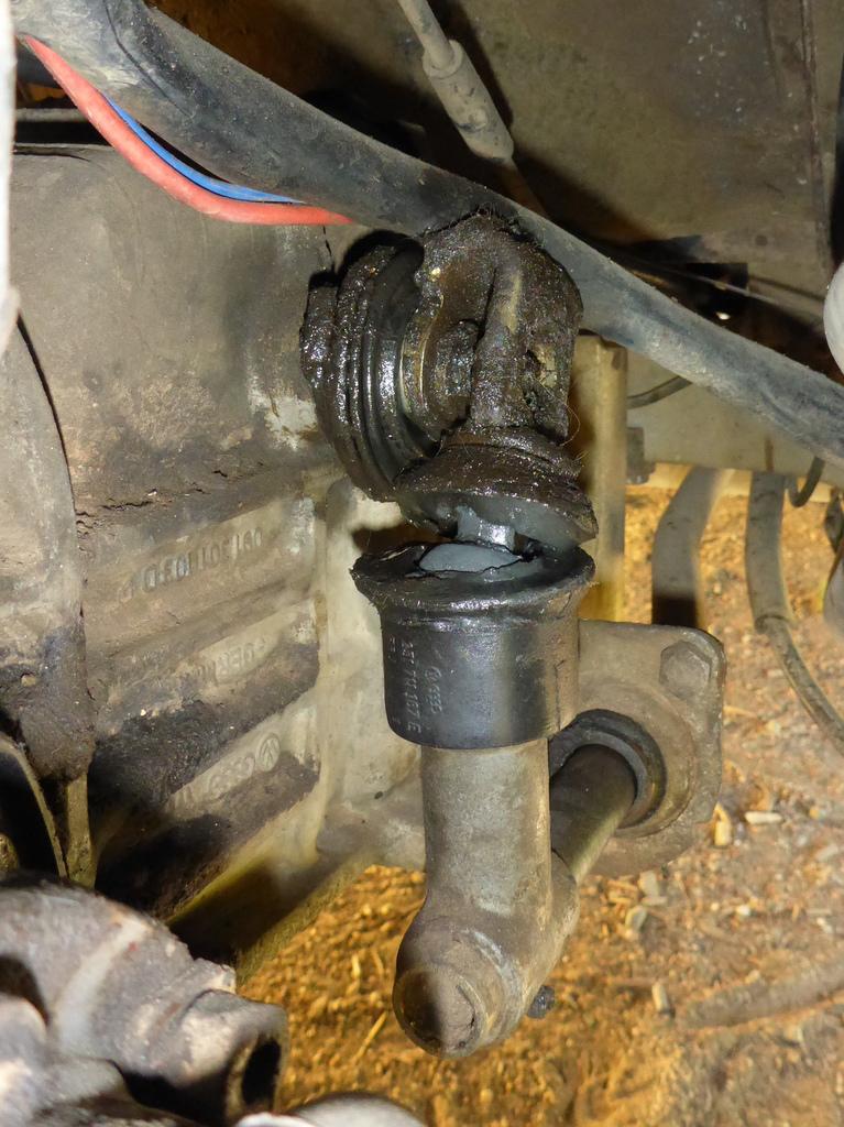

I also replaced the transmission shaft selector seal as there was lots of fluid leaking out and replaced a number of torn rubber boots on the shift rod.
Before:
After:

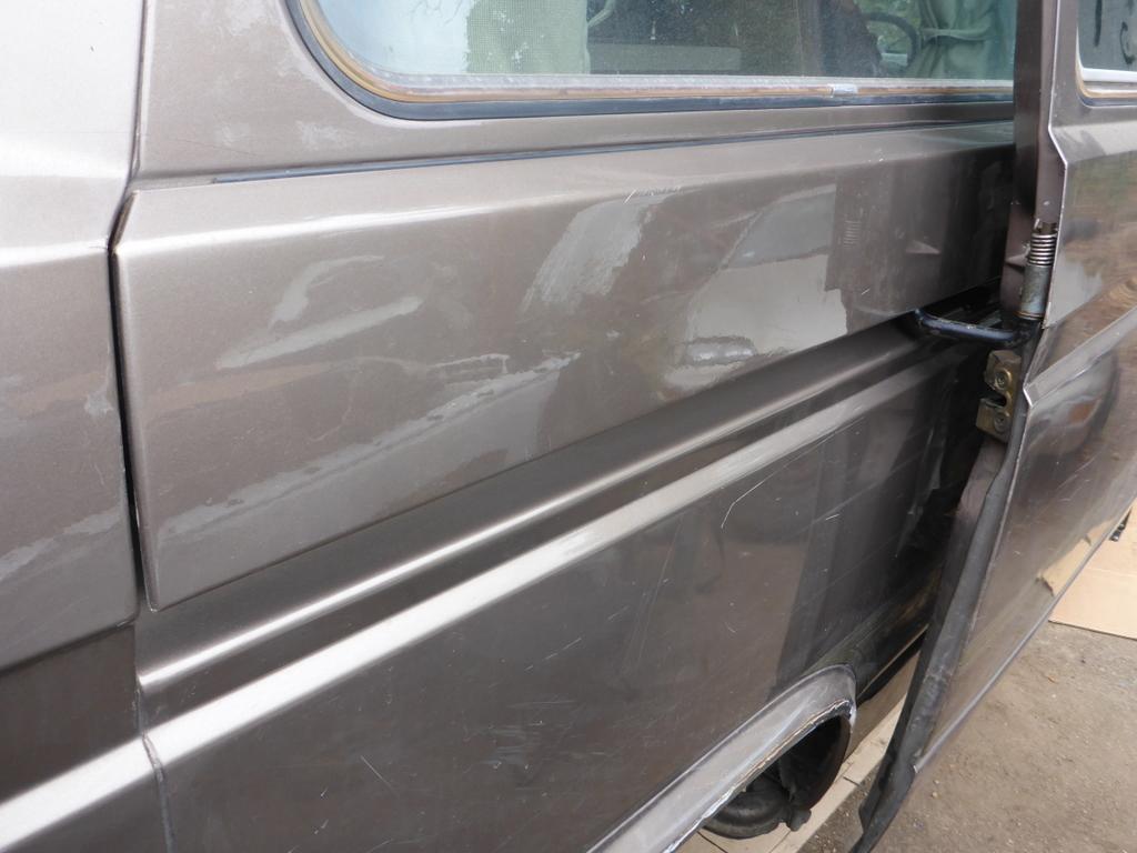

Cana did an awesome job cleaning and rebuilding the sliding door mechanism and I pulled the old eberspacher heater from under the vehicle...is this thing worth rebuilding and reinstalling?

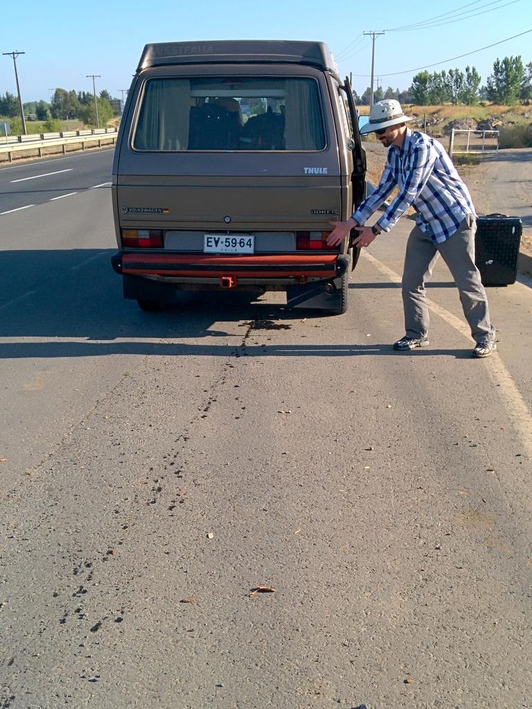

After a thrilling 6 hours of ownership and ~300km of travel, disaster struck. I first noticed the oil warning light (an indicator of low oil pressure) come on a toll booth as I slowed down. But the light went away as I accelerated back to modest highway speeds (~80km/hr). About 20 minutes later I felt a rapid loss in power and immediately a passing car signaled to us that white smoke was coming out the back of the vehicle. Sure enough. I pulled over (fortunately at a bus stop!) and quickly assessed the damage. A trail of oil marked our path to the side of the road and a pool was slowly accumulating. Smoke billowed from under the car. Fire extinguisher in hand, I pulled the licence plate flap open... no flames. Good. Unloaded baggage, pulled off the engine lid and saw splatters of oil on the right side, near the head/water jacket seal. No clear source, nothing obviously broken or deformed. Oil still dripping. I started the engine once, it started, ran roughly and I turned it off. Looked in the coolant reservoir. Low level and a grey, soupy mix of oil and coolant. Dead engine.
Fortunately, the tolls on the Pan-American highway in Chile (Ruta 5) go toward a free towing service. If you have a problem, just call the number on the back of the receipt from the previous toll booth and a technician arrives, assess the situation and helps you toward a solution. In our case the awesome highway team did four things. (1) Confirmed that we would not drive our way out of this situation, (2) set up safety cones, (3) arranged a tow to the nearest official exit with an overpass and nearby food source and (4) successfully flagged down a commercial, double decker bus and arranged seats from my parents to Concepcion. My brother and I would stay with the vehicle to resolve our situation somehow.
Competent highway team at work (Mom's shadow with camera):
Dad assessing the progress:
Sunset unloading at a cloverleaf exit in nowhere in particular:
Waiting for the tow back to Concepcion:
Once at the cloverleaf I began to make calls to friends back in Concepcion to arrange a rescue. Enter first two Chilean angels: Claudio contacts his mechanic, Mitchel, who agrees to come with a friend to tow us home. He drives 2.5 hours north and meets us at around midnight. Fortunately they brought a rigid tow bar to connect the vehicles. Unfortunately, the ends were attached to the vehicles using thin, suspect rope. One end was tied to the weak-looking tow loop under the vanagon's front bumper. The other end was tied to a sturdy loop on the towing vehicle's bumper. In case that knot failed, the rope was also tied to the ladder leading up the back of the towing vehicles back door. On multiple occasions, I imagined any number of failure scenarios...under tension the ladder would zipper off the back of the towing vehicle...under compression the tow bar would penetrate up through the floor of the vanagon and skewer me...etc. The mechanic's friend drove his vehicle, the lead car, and the mechanic would pilot my vanagon. I got to watch from the passenger seat, located roughly 10 feet from the back of the towing vehicle.
Almost to Concepcion:
This tow home was one of the most frightening experiences of my life. (Note that I often find myself into questionable situations.) How then, you ask, could this situation be so bad?
First, the car battery died around 2 hours into the 5 hour trip home. That meant that we were close to invisible to the traffic approaching us from behind. The vanagon was wider than the towing vehicle and thus blocking its lights. During the decent into Concepcion, logging trucks and huge buses were passing us at roughly 3 times our speed. My brother was so concerned, he programmed his smartphone to blink a red screen, which he held up to the back window when he saw one coming. Eventually that died too. The other downside of this situation was that the driver had no quick way of communicating to the lead car if we had a problem (no horn to honk, to lights to flash). I asked whether we should stop, charge up and then continue in the morning. The driver replied no, as we had to get home before daylight when traffic would increase and our jerry-rigged tow set-up would be scrutinized by the police. Remember, no insurance, no permission to circulate.
Second, the two drivers had worked all day and completed the tow between 10 pm and 5:30 am. On multiple occasions I saw my driver rubbing his eyes, jerking his head up and rolling down the window for fresh air. I did my best to keep conversation lively...but my broken Spanish was probably more frustrating than entertaining. I asked, "Shall we rest?" Nope. Need to keep moving.
Third, about an hour out of Concepcion I noticed we kept bumping into the tow bar and the smell of hot brakes. The driver switched to using gears to regulate speed. Clearly the brakes were no longer useful. By the time we were at the outskirts of Concepcion, the handbrake was the only thing available to sort-of slow the car.
My brother and I hopped out downtown and walked home as the others towed the car another 10 minutes to the mechanic's shop. I thanked them for all their work and arranged to make discuss repairs later. I kissed the sidewalk. I was tired from strained conversation, depressed about my broken car (now with fried breaks) and rattled from fear of getting sandwiched between a semi and the tow vehicle. My brother and I looked at each other, gave each other a hug and admitted that we were glad/lucky to be alive. "I'm never doing that again."

Most vanagons in Chile are from Europe. There are a handful of American vans here but most are the European 'Joker' models. As such, many have original or modified diesel engines. Body quality tends to be quite high because the more populated parts of the country are dry and the vans spend little time in snow or rain. There are many 'high-top' and other mark campers including Carthago's and Dehler Profi's. As there is not a large stock of vans here, it is difficult to find quality, original parts or experienced mechanics, thus most work done on these vans is done by owners or sometimes experts in T2 buses which are abundantly supplied from Brazil. Waterboxer experience mechanics are hard to find (more on this later).
How did we ultimately find our Jules?
After looking at a number of the vehicles for sale and test driving them, we were contacted by an owner who read our 'looking to buy' post on the KlienBus classified forum. NOTE: if you are in Chile under a tourist visa, you can (relatively easily) either buy a car from a Chilean or another tourist. If you have a resident visa (temporary or not) or are a citizen, you cannot buy a car from a traveling tourist.

This thread chronicles the purchase, failure and subsequent restoration of a 1985 Jubilee Joker acquired explicitly to carry our family from Chile back home to the states. I will focus on progress in various projects, titled using all-caps as above. Specific issues or questions I come up with will be posed in separate threads and linked. As this is my first foray into the world of Westy/Vanagon/Transporter/T2.5/T3, I welcome any feedback, advice, scolding etc. Because our adventures in vanagon ownership started in December I will provide a few brief summary posts to bring us up to the present, then focus on active projects.
Here is one of the seductive photos the previous owner sent me.
Here is a rather unseductive photo about six hours after the purchase. Note oil track, puddle and tow truck.
