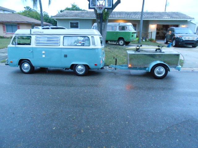

Trailer is fantastic. Love the fact you can see the torsion housing covers.

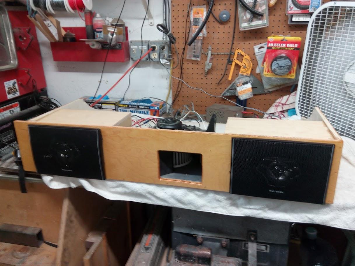

now that the a/c unit is installed I went on to building a device to catch the condensation produced during operation. This will be installed at the base of the mounting plate. The photos will show what I am yacking about.
I will install it tomorrow.

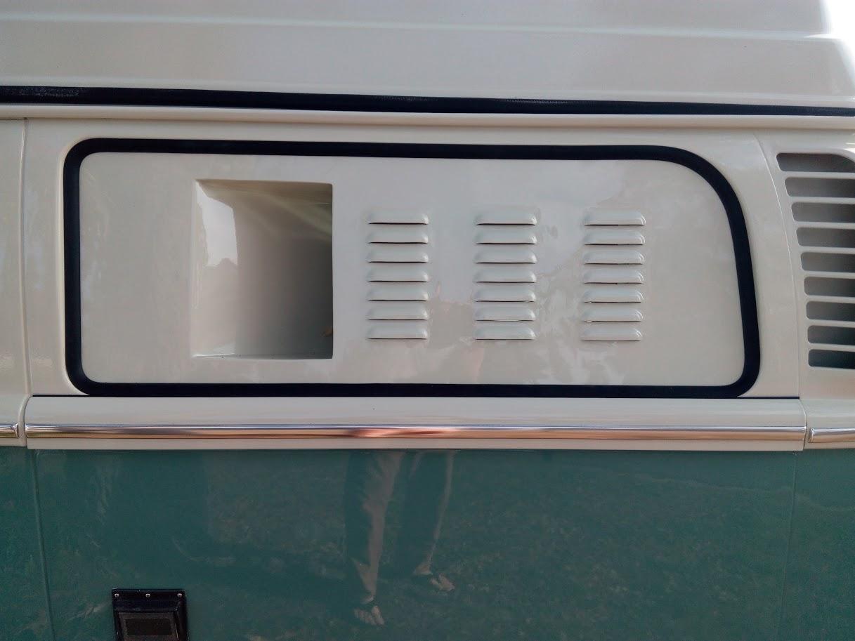

To Keep water from coming in during a rain I will have a magnet panel that will attach to the scoop portion

how about some air conditioning talk? this unit is a 6000 btu model with a super high seer rating. the fit is very snug but I wanted the end result to look factory installed. when the unit is running its really quiet and belts out some serious cold air. I used the exact dimension of the piece of glass I removed so that a factory window seal will work of it ever needs to be removed. What do you think?

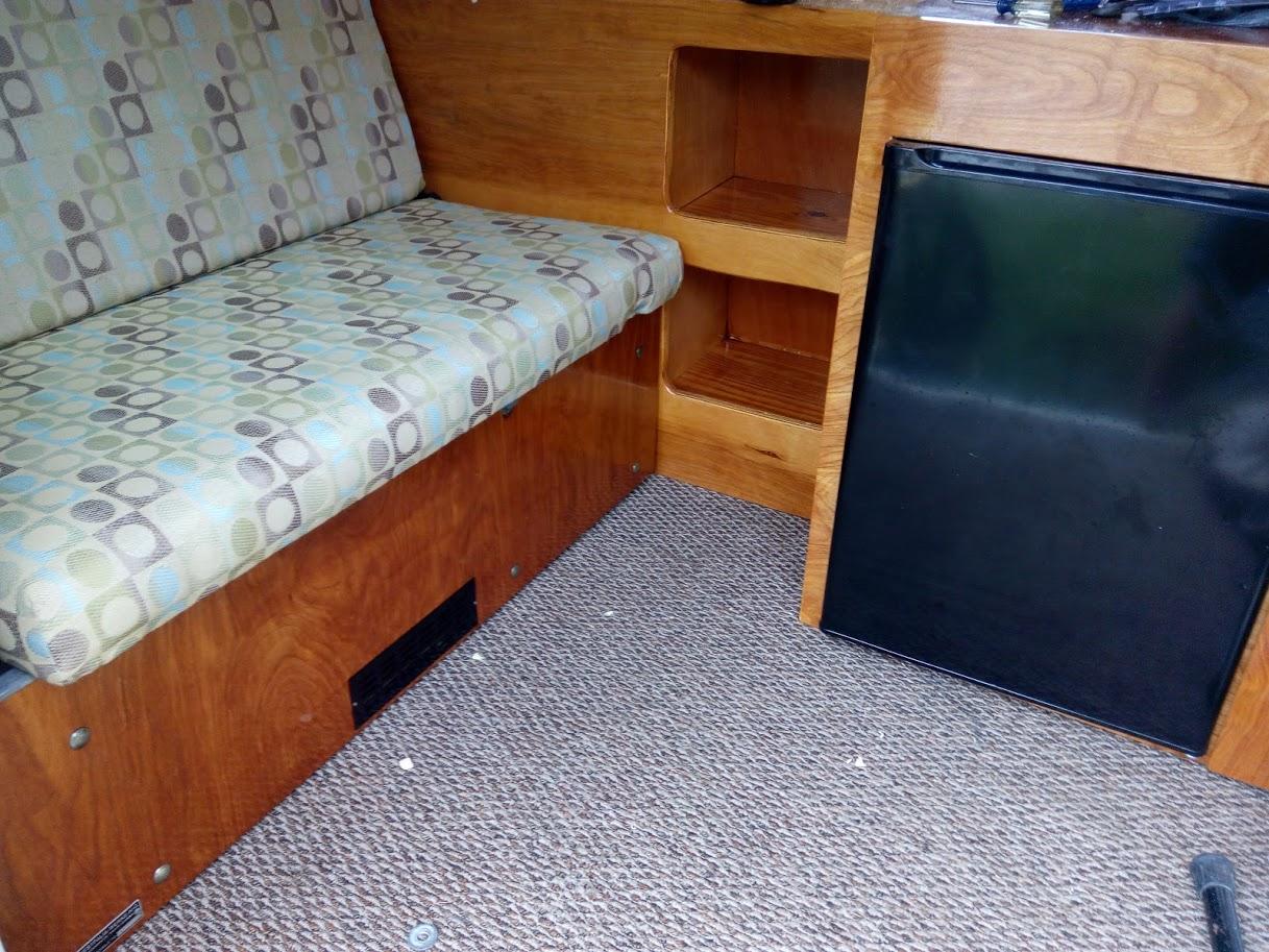

now for the interior cabinets. getting all the cabinets just right was a chore. after much install and removing several times the fit great, I predrilled the holes for the electrical and it helped a lot once i ran the lines. I used and outlet for the fridge and install a switch for the ac to isolate it during driving. this was the fridge will run all the time keeping the grub chilled. I liked the idea of the spare tire just behind the drivers seat so I kept it there. I had some space left so I installed a pull out tall draw with soft close slides to help keep it closed during travel. When installing the invert-er I opted for a remote location power switch so I can hide the inverted under the seat.

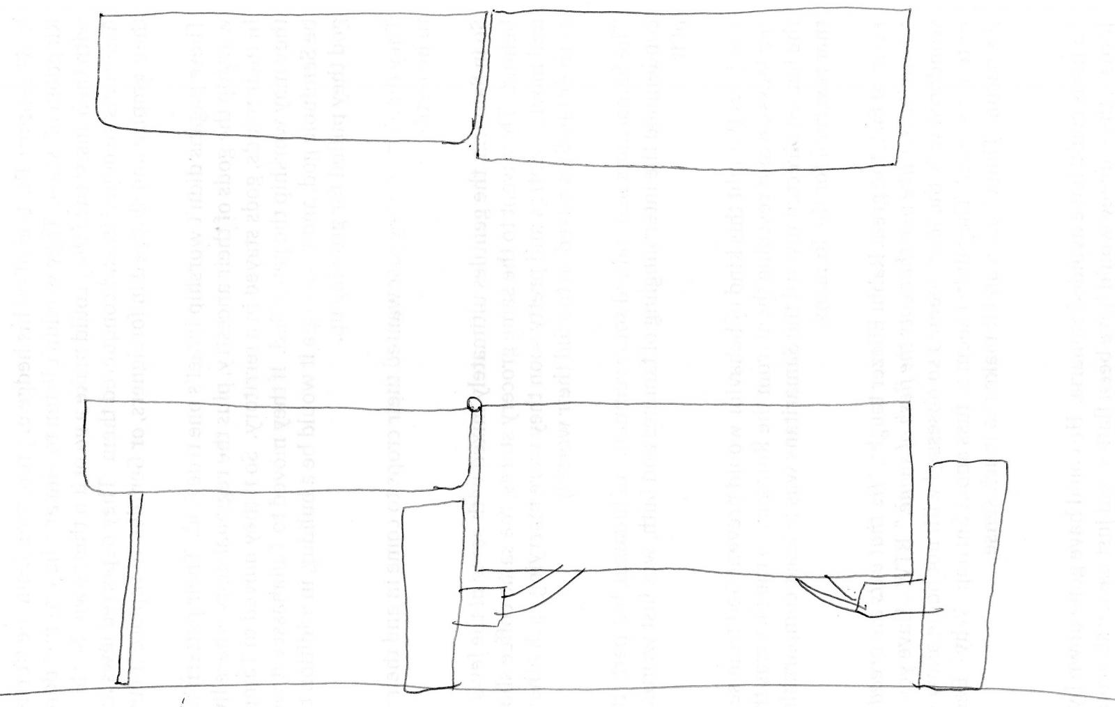

when making all new cabinets I also decided to make the bed base. I used all the metal from the donor and used all new wood

PostPosted: Sun Aug 14, 2016 7:28 pm    Post subject: Re: 1978 Westy Full Restoration with Matching Custom Trailer Reply with quote
this is the unit bolts to the ceiling, I used bass baffles for the speakers and installed the blower motor to pass the cold air from the a/c units to the front of the bus.
[img]
[/img]
[img]
[/img]
