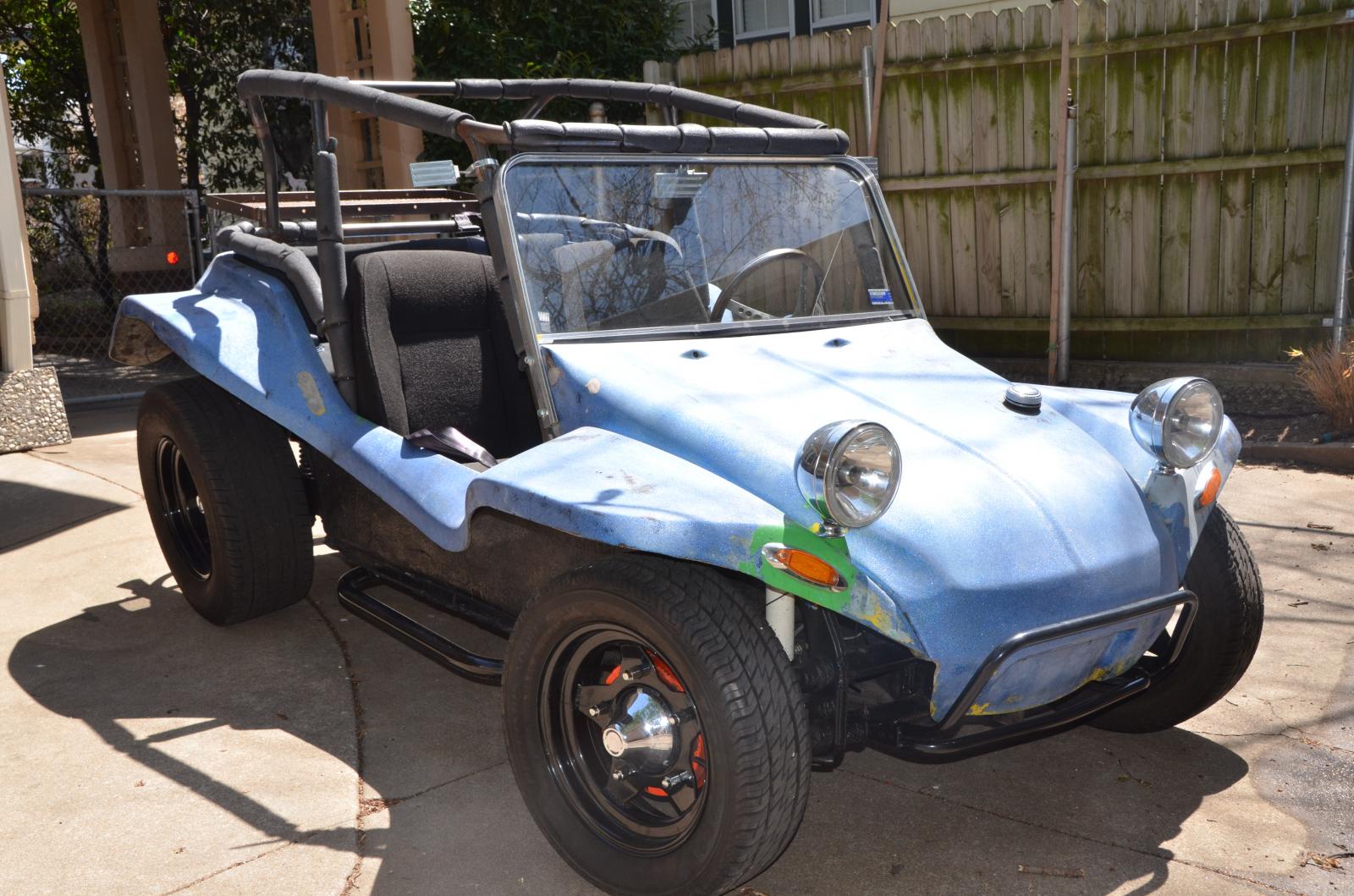

AkioOhtori
Joined: March 02, 2014
Posts: 89
Location: Tulsa, OK
AkioOhtori is offline
PostPosted: Mon Apr 21, 2014 12:49 pm    Post subject: Re: video Reply with quote
herbsflat4 wrote:
Haha. Just watched the video. I enjoyed the "F-it shrug". We have all been there at some point or another I am betting. Very well done video though!
7 coats is a lot isn't it? I thought most of the vidoes online mention 4-5 coats.
Thanks!
I a couple of things contributed to the seven coats:
*The largest consideration was I could get about 7.75 coats out of the two gallons I bought and didn't want much extra. Smile
*Light Blue doesn't cover as well as some of the newer or darker colors, so more coats are required.
*My first couple of coats were a little light as I was getting used to the sprayer at that point.
*I've heard that 6 coats is a good number for removability. As this was the first time dipping it, I wanted to make sure to get to 6 in case I wanted to peel before re-applying.

AkioOhtori
Posts: 89
Location: Tulsa, OK
PostPosted: Mon Apr 21, 2014 6:11 am    Post subject: Re: Thanks! Reply with quote
herbsflat4 wrote:
Did you buy the new electric sprayer from dipyourcar? What are your thoughts on it?
I bought this Wagner one from Amazon. I'm pretty sure it is the one the DYC unit is based on, and it was $50 less. My only complaint is the air is always on, but I believe that is a necessary evil if the blower is remote.

AkioOhtori
Posts: 89
Location: Tulsa, OK
PostPosted: Sun Apr 20, 2014 1:34 pm    Post subject: Reply with quote
surfnc wrote:
AkioOhtori
Very neat!! Makes me think of parts to use this on. I will need to do some research. A Tow'd/buggy with this on it might be useful to go through the woods and sand with and not worry about paint damage.
Will it easily delaminate/peel off? I would be worried about an edge coming up at speed and the whole hood or fender covering coming up in your windshield.
You did a GREAT job and it looks very nice!
How much did the whole job cost? (Materials, thinner etc)
Vince
Thanks!
I agree, especially if you have a nice paint job this would be a good way to protect it. A lot of people also just use the matte or gloss clear spray to protect their paint but leave it the same color.
In theory it peels off easily by hand, but not via wind. There are videos of people taking a 1200PSI power washer to this stuff at close range and not having anything come off, even with rock chips.
The major reseller of the car oriented products is DipYourCar.com. They have a youtube channel that may answer some of your questions.
It wasn't terribly expensive. Here is a breakdown:
Sprayer (one time cost) = $118
Masks (one time cost) = $28 x 1; $4 x 2 (cheaper ones for the helpers)
Sprayable Dip = $140 (~$60/ gallon + $20 shipping)
Stirrer = $8
Tape and Drape - 72 ft = $16
So setup costs were about $150, but reusable, and consumables were about $180 all said.
